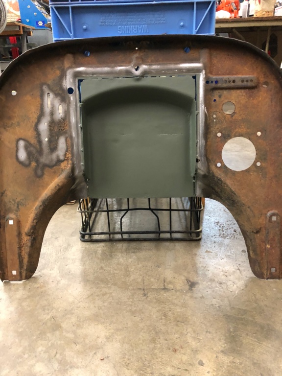

Hank Lee posted some pictures in the past showing how he moved the existing  firewall "hump" vertically and then added material below that to give clearance for a head.  Perhaps he will repost those here.  Obviously you loose your coil box, but....

If you want to use an original coil box.., just dish more for the insulator(s) clearance! Been there done that!

I did the same as Hank.   Had a local hot rod metal shop put recess in metal firewall.  Looks really professional and almost "factory".  I run a dizzy, so coils removed leaving more room for recess.
