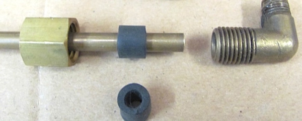

Fuel hose neoprene, 1/4” I.d. section, is better over the felt, compresses to really seal, and can be reused.
As you can slide the section on the fuel line, easy to see the distance the fuel line engages the elbow to full depth. Then slide compression nut over the cylinder of fuel hose. Easier than packing that felt, the felt has larger I.d. and o.d.

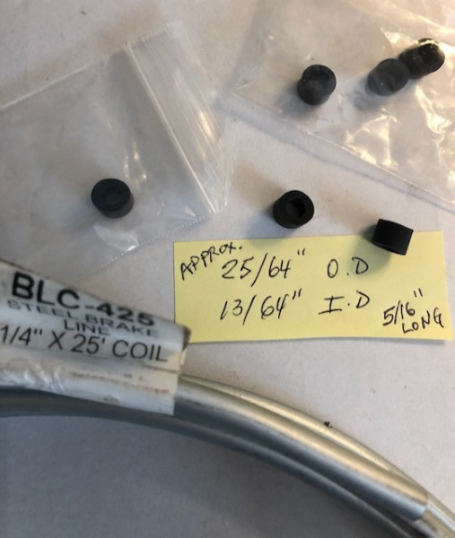

Here's what is supplied and works every time. Use of 1/4" dia. steel brake line for the fuel line is my preference, easy to hand form the new line.
