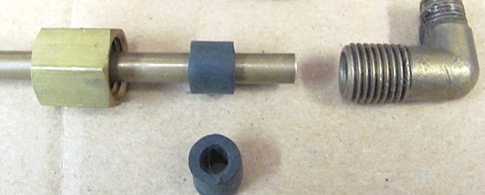

- Posts: 3951
Re: Question About Fuel Line Part
Here's what is supplied and works every time. Use of 1/4" dia. steel brake line for the fuel line is my preference, easy to hand form the new line.
