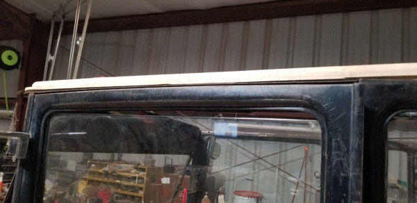

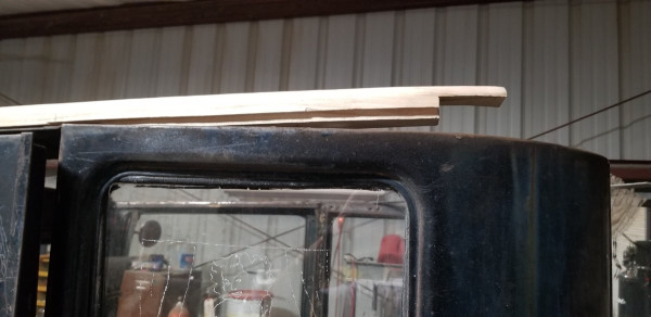

Here's what I'm faced with. I don't think this is normal. Thanks for all of your comments.

Re: 1927 Roof Wood Replacement
David: The coupe in this post had the same issues. These posts by Don Booth give some solutions. jb
James, thank you for pointing me in the right direction. I did some measuring and it turns out that my entire body has bent back and down to the rear of the car. I've got some work ahead of me to get it square again. Interestingly, someone put a new top on the car many years ago. Instead of squaring things up, they just hand made side rails to compensate for the problem. It must have been done 50 or 60 years ago. It was a really bad job but the side rails looked okay until I put the new ones up there.

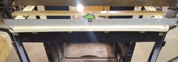

My October 1926 coupe top steel is flat on the left and right...
crowned across the front 1/2"...
and crowned across the rear 3/8".
From front to rear in the center of my top wood is crowned.
My four ribs, from front to back, crown the following: 1) 5/8", 2) 3/4", 3) 3/4", 4) 9/16" but I am not saying that this is what you should use.
Put a straight edge across your 1) front and 2) rear metal.

Topic author - Posts: 13
- Joined: Tue Jan 08, 2019 1:21 pm
- First Name: David
