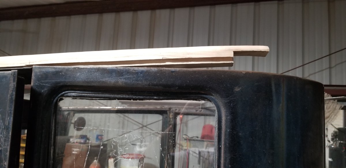

I have a question about a 1927 coupe roof. Is the roof flat from back to front, or is there a slight drop over the back of the door to the front? I have never seen another '27 coupe so, I don't have a reference to go by. If I clamp the side rail to the top of the door, it sticks up about an inch at the back of the rail over the side window.

The top wood that goes along the perimeter of the roof is flat along the sides and has a crown across the front, I think the back is flat too, same contour as the body roof line. If your body is not flat above the door and quarter window something is wrong. There will be divots for fasteners, and other features in the body that will need a relief in the wood rails to clear, but the side rail should be flat and the body top edge should be flat. The four top bows are all crowned, more of a crown for the center two bows, almost 1.5", less of a crown for the outer two bows almost .75-1".

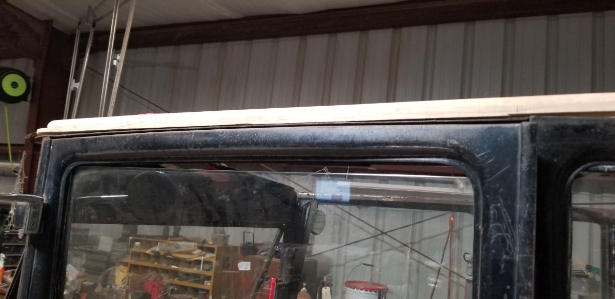

Here's what I'm faced with. I don't think this is normal. Thanks for all of your comments.

James, thank you for pointing me in the right direction. I did some measuring and it turns out that my entire body has bent back and down to the rear of the car. I've got some work ahead of me to get it square again. Interestingly, someone put a new top on the car many years ago. Instead of squaring things up, they just hand made side rails to compensate for the problem. It must have been done 50 or 60 years ago. It was a really bad job but the side rails looked okay until I put the new ones up there.
