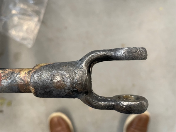

The photo shows the left (non-ball end) clevis on the steering tie rod on my ‘24 as I found it after stripping the paint. Is it common to see the clevis brazed to the tie rod? I ask because this looks a little amateurish, and I don’t remember how the one on my ‘25 was attached when I stripped and painted it last fall.

I'm not surprised to see that. The crankcases have an abundance of brazing on them and not done neatly. It isn't as noticeable after painting. It seems like they might have been pinned too.

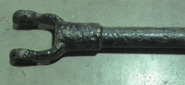

This looks to be the same under the paint.

Re: Tie rod clevis

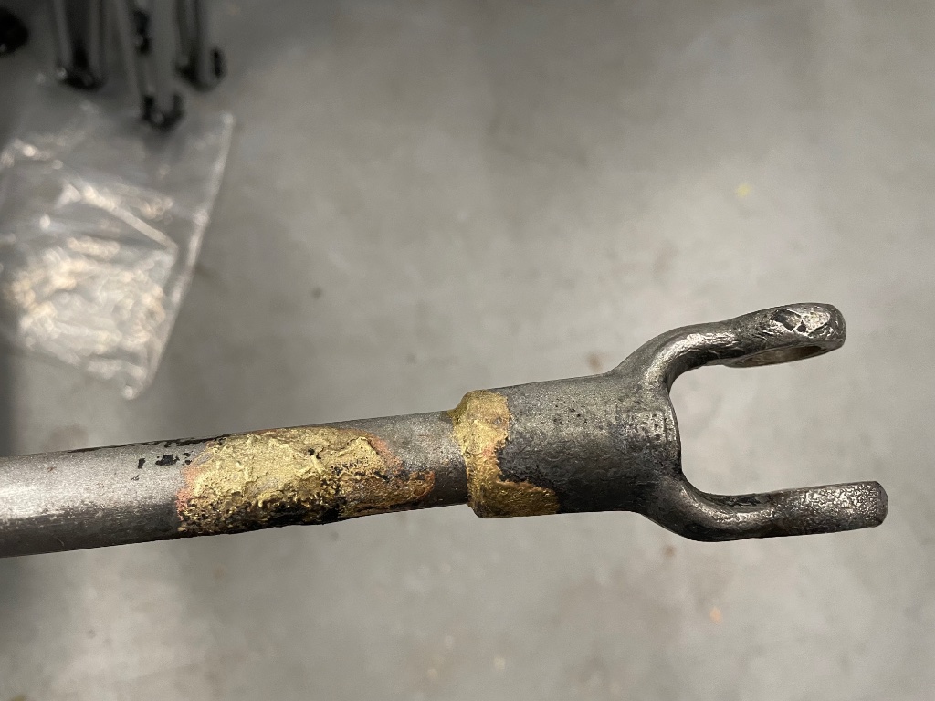

Thanks Rich. That gives me some peace of mind, considering the criticality of the part. I hadn’t thought about it being pinned but there is evidence of what may be a pin on the opposite side from my first photo:Rich Eagle wrote: ↑Sat Feb 12, 2022 1:01 pmI'm not surprised to see that. The crankcases have an abundance of brazing on them and not done neatly. It isn't as noticeable after painting.

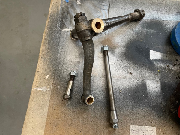

Thank you Scott. Stripping and painting is just the last step in overhauling the front axle of my ‘24 touring. The axle has been straightened, and reamed for steel tapered upper spindle bushings. The threads for spindle and tie rod bolts have been inspected and found to be in good condition, and the spindles have new bushings fitted for new spindle and tie rod bolts.Scott_Conger wrote: ↑Sat Feb 12, 2022 2:44 pmWhile the paint is off, take this time to fit a new bolt to it and close up the hole and renew the threads if either is necessary (and it often is)

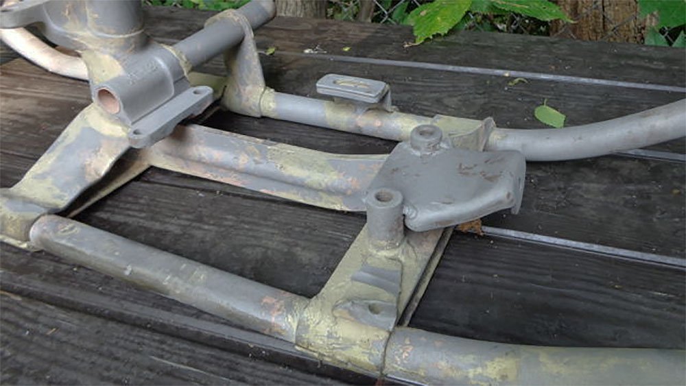

Motorcycle frames are brazed on a production basis similarly. Look at a sandblasted one if you get a chance.
