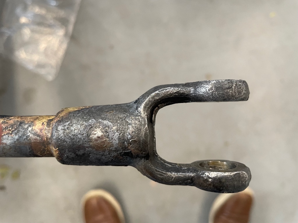

The photo shows the left (non-ball end) clevis on the steering tie rod on my ‘24 as I found it after stripping the paint. Is it common to see the clevis brazed to the tie rod? I ask because this looks a little amateurish, and I don’t remember how the one on my ‘25 was attached when I stripped and painted it last fall.

I'm not surprised to see that. The crankcases have an abundance of brazing on them and not done neatly. It isn't as noticeable after painting. It seems like they might have been pinned too.
This looks to be the same under the paint.

Thanks Rich. That gives me some peace of mind, considering the criticality of the part. I hadn’t thought about it being pinned but there is evidence of what may be a pin on the opposite side from my first photo:Rich Eagle wrote: ↑Sat Feb 12, 2022 1:01 pmI'm not surprised to see that. The crankcases have an abundance of brazing on them and not done neatly. It isn't as noticeable after painting.

If I remember one end is fixed and the other is adjustable. And yes Ford’s brazing wouldn’t pass the “good look test” these days.

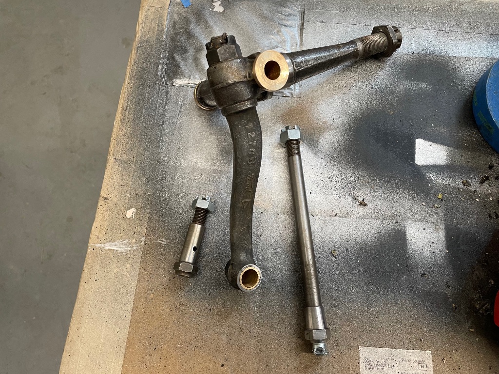

While the paint is off, take this time to fit a new bolt to it and close up the hole and renew the threads if either is necessary (and it often is)

Thank you Scott. Stripping and painting is just the last step in overhauling the front axle of my ‘24 touring. The axle has been straightened, and reamed for steel tapered upper spindle bushings. The threads for spindle and tie rod bolts have been inspected and found to be in good condition, and the spindles have new bushings fitted for new spindle and tie rod bolts.Scott_Conger wrote: ↑Sat Feb 12, 2022 2:44 pmWhile the paint is off, take this time to fit a new bolt to it and close up the hole and renew the threads if either is necessary (and it often is)

When you are on a assembly line and have to braze a part every 20 seconds the work can get a bit sloppy!

Motorcycle frames are brazed on a production basis similarly. Look at a sandblasted one if you get a chance.

If you want to see what those quick brazing jobs looked like when Ford was rolling out the T engine crank cases you would surprised what they looked like before the paint was applied! But overall they worked and held the crankcase arms and the other pieces really well.
Model T’s have character and those brazing jobs give them that. Or at least I think so.
In reality the brazing was flowed on is pretty much the correct term for it!
