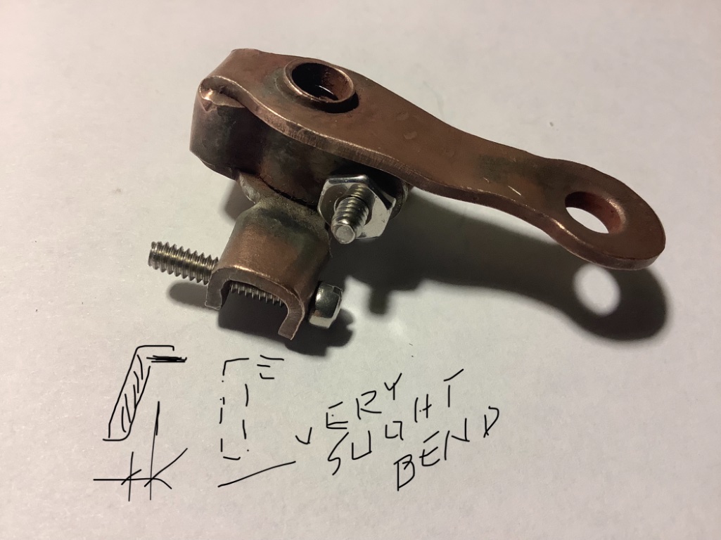

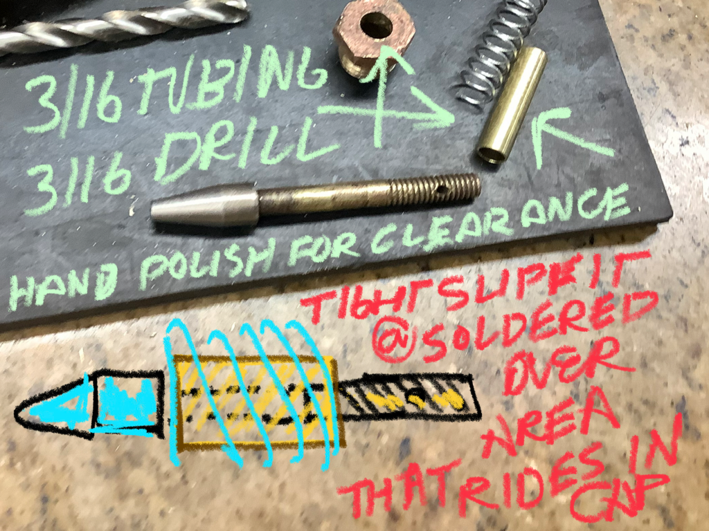

Adjusting this piece. The stop screw can have a small nut on it to keep it from moving, but originally one end of the threaded bracket was tweaked just a bit to act as a lock. Just a slight bend. The very slight shift of one of the threaded holes will keep the screw in place and set.

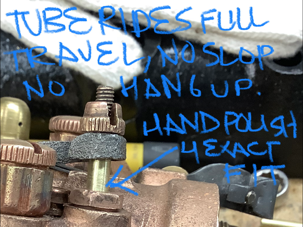

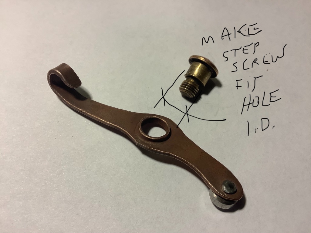

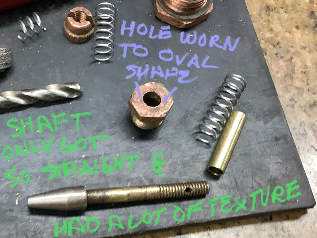

Instead of reaming the hole in this piece to finished size, I left it just a tad under size. The brass shoulder screw that is on the carb is sometimes worn under size, so I thought it may be better to fit the shoulder screw TO the metal arm, instead of visy versy.

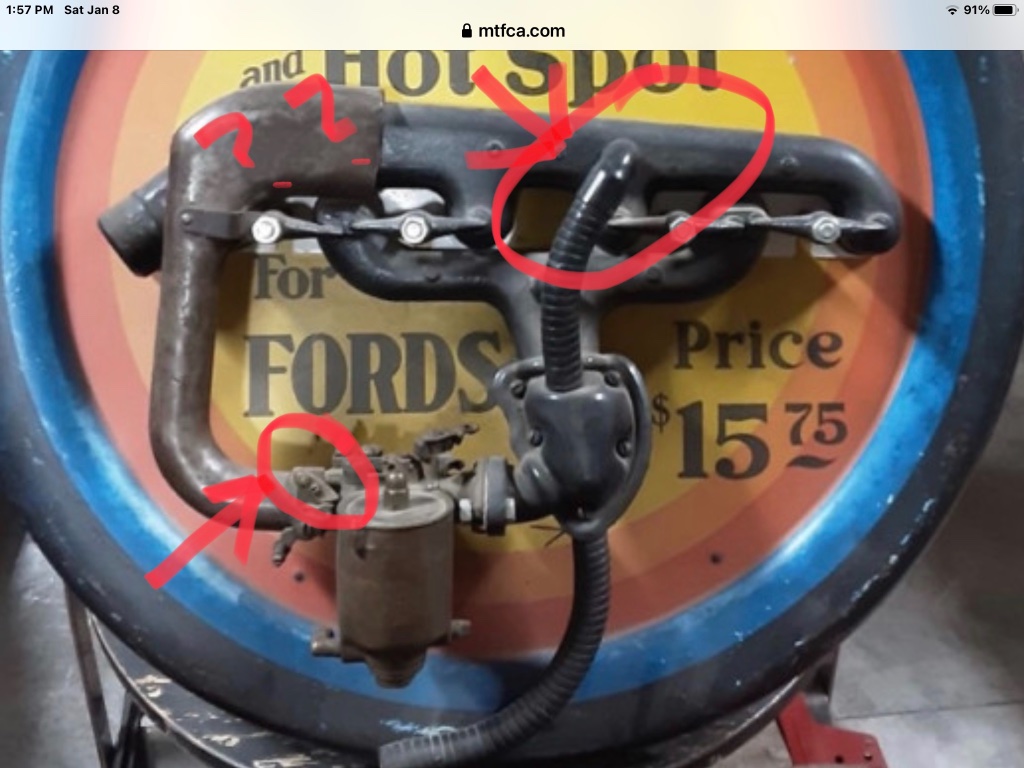

Saw this posted on model t Ford Facebook site. What a great display piece. I’ve seen it posted here years ago.

Interesting that the complete set up used the Ford hot air pipe and the hot spot chamber….

Michael, I’m not sure how accurate the sales display is now. It has a ( copper) plumbing fitting where the air valve would go, and also missing the choke cable clamp. I’d bet the original would have the steering column choke control displayed also. I’m not picking it apart, and only wish it was hanging on my wall!

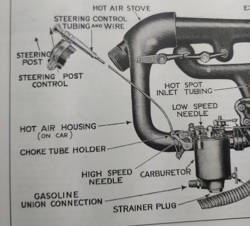

I sent an incomplete OF to Stan Howe to be rebuilt. While it was away I purchased a push/pull choke cable at a clearing sale. It was made for a T because it had the diamond shaped mounting bracket for the T steering column, so I thought it would do for my OF.
When Stan sent the carb back it came with copies of the books Tim posted and some extra instructions from Stan. Imagine my surprise when page 5 of the Stromberg manual showed my choke cable assembly. Apparently, it is the later, perhaps simpler, version of the one Tim manufactures for OF users.
I have since found a second one, with a bracket to go round a round steering column.
Allan from down under
- Posts: 7279
Re: Rebuilding your OF Stromberg

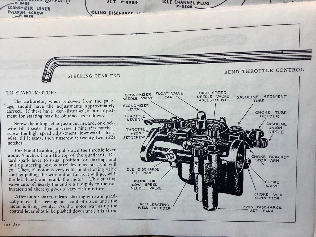

Here is a photo of the choke control in Stan's manual. Perhaps it will alert others when they see one.

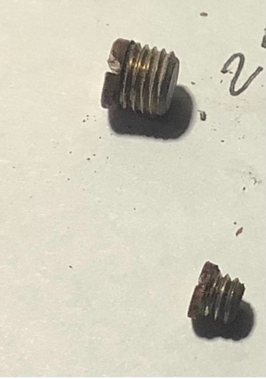

A couple enthusiasts I know are working on their OF carbs this winter. I’ve permission to post some PIcs with questions. So, if you’ve been into one of these desirable carbs, feel free to jump in with hints and advice.

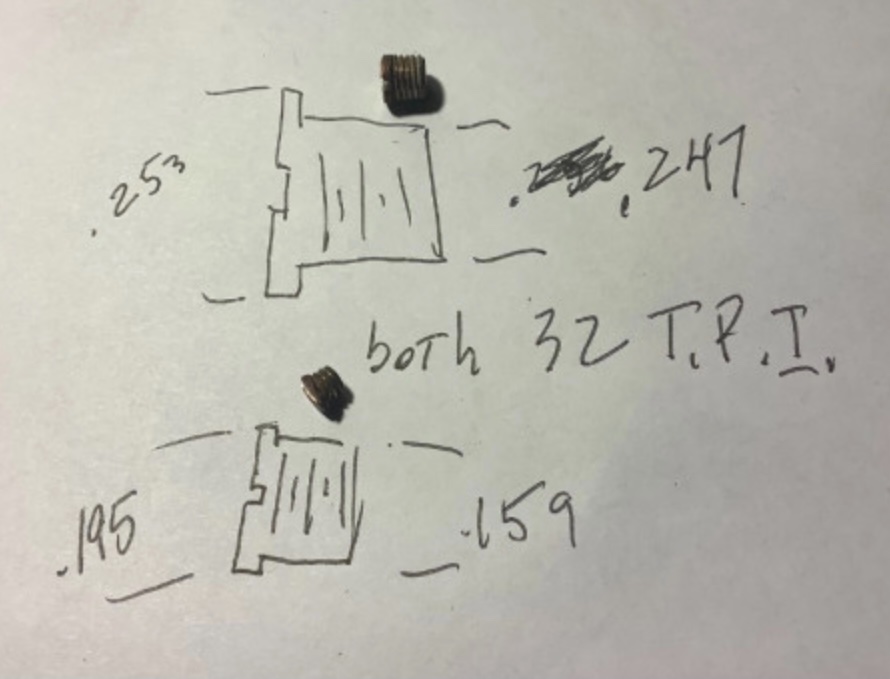

Info added from discussion in the classifieds. Size and modern source of sealing screws.

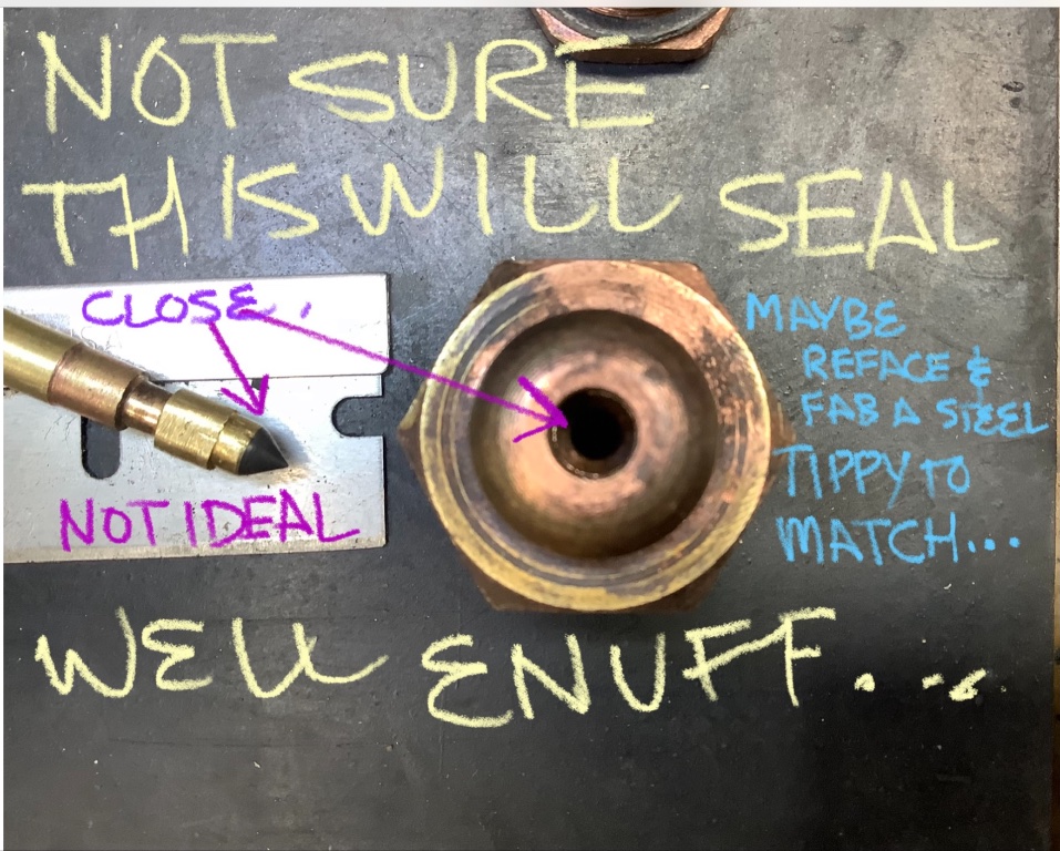

Tim here’s one I started doing a while back is this the needle you are asking about

Thanks Randall, I believe that will help him. Appreciate the effort. He has a lot of other questions written on his pics posted above, if anyone wants to help, he would appreciate it. Thanks!

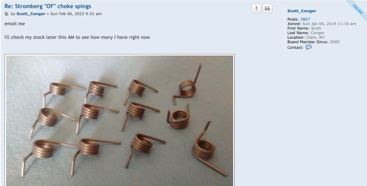

Thanks Duane, hope he’s following. I expect so. I’ve had another inquiry about the small choke spring. Anybody have them available, shout out! He needs two, but I’d expect there are others interested.
Dropacent
Topic author - Posts: 3384
- Last Name: Morsher
- Location: Norwalk Ohio
Here ya go, Scott has the choke springs. Things of beauty. He who hesitates is lost!
