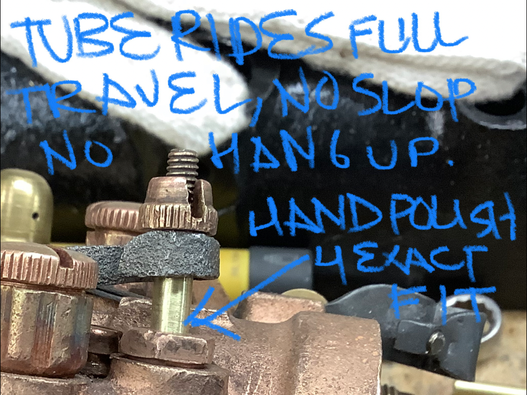

Re: Rebuilding your OF Stromberg
Instead of reaming the hole in this piece to finished size, I left it just a tad under size.  The brass shoulder screw that is on the carb is sometimes worn under size, so I thought it may be better to fit the shoulder screw TO the metal arm, instead of visy versy.
