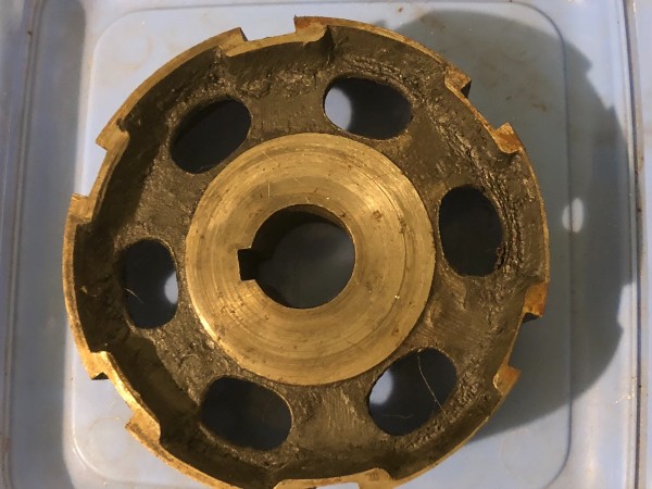

- Posts: 5599
Re: Disc drum question
There are actually 6 holes around the circumference and a spiral oil groove machined/cast into the bottom where it rides against the "top hat" bushing - I dig one out & post a photo.

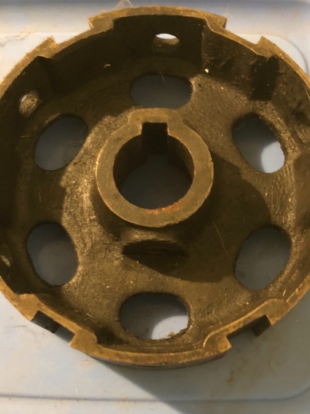

Corey Walker
- Posts: 683
- First Name: Corey
- Last Name: Walker
- Location: Brownsboro, TX
This one came out of a 1914 transmission. It has no Ford script anywhere, I thought there was a DB but there’s not. The flywheel was marked Dodge Bros. I guess is why I thought that.
