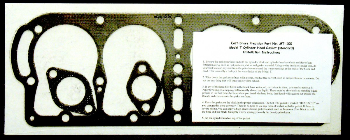

I ordered a couple of these from Adam after using the one he installed in my engine. I'm not familiar with the Felpro gasket, so I don't know if these are similar.

Will the steel head gaskets work. They worked 50 years ago on Chevy V8. Why not a model t. Just wondering if anyone tried and how successful.

They work excellent Art, just use copper spray on both sides!
