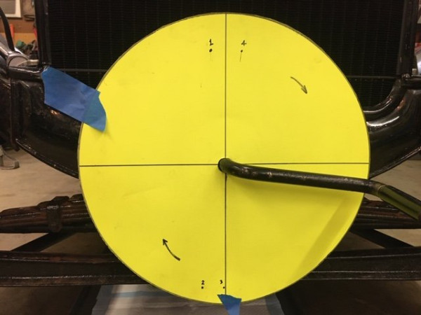

I suggest you check your Anderson timer for correct timing. My fiend Bill and I set ours up and it makes a big difference. Yes are cam covers are properly centered. Take a large sheet of construction paper. Place an hole in the center with a slit to the outside edge. Remove plugs but keep connected so the coils have a path to ground. Rotate engine without letting the crank come off the pin in the crankshaft. Mark a line on the paper where each plug fires. You should have two lines or two marks. If not, adjust timing by bending tabs except the tab for Number one cylinder.
1926 Tudor
- Posts: 4694
Re: Anderson timer
John, I don't understand where you place the paper? How do you know where the lines go?

Norman, I'm guessing he's taping it to the radiator, and marking where each cylinder fires in relation to the crank. That's basically what I did.

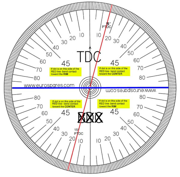

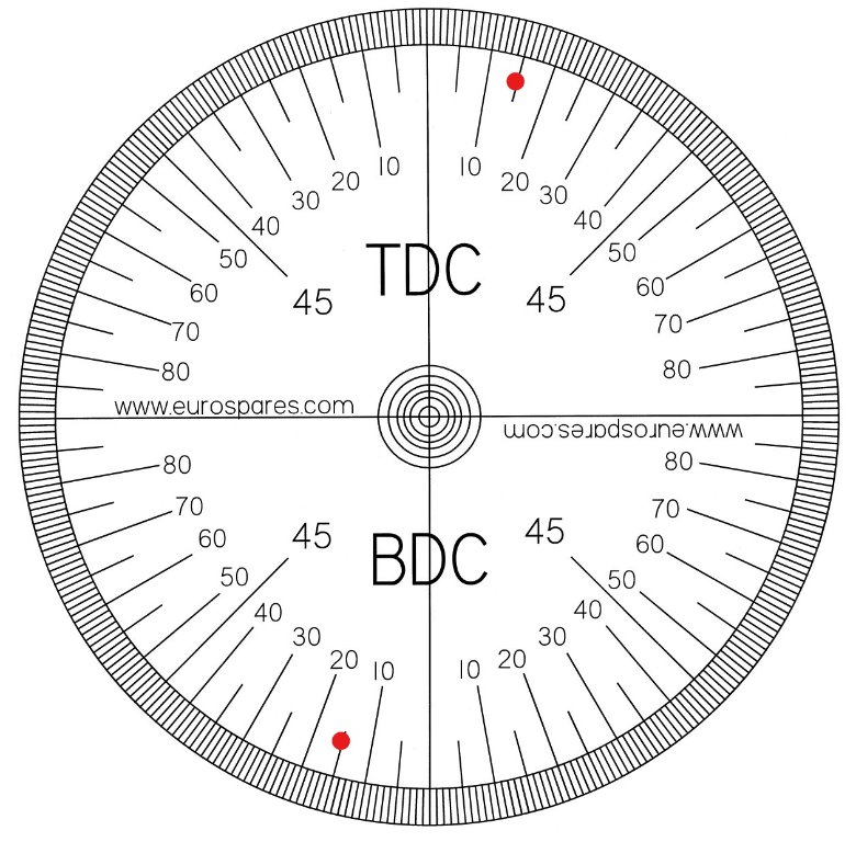

Referring to John Zibell's post above.
We started by enlarging a degree wheel chart to approx 2 ft diameter. Using poster board we cut a circle the same diameter as our degree wheel. From here we created a hole "dead center" of the circular posterboard (the hole being the just large enough for the crank handle to go through). Using scissors, a cut was made along the lower line from the bottom of the chart to the circular hole- this allows a snug fit between the handle and the hole. Next, tape the chart to the car so that it can't move. Then pencil a light line top & bottom where 15-degrees PTDC (PAST TOP DEAD CENTER) is on the vertical line, both top and bottom.
With spark plugs removed, and key turned ON. Start checking each cylinder, by turning the crank. Stop turning the crank when #1 begins to buzz. Put a mark on the chart at the location where the crank was when the buzz started (not finished). Be exact. Do the same with 2,3, & 4 and mark their buzz starting points. Turn the crank slowly with accuracy. CAUTION- NEVER allow the Ratchet to become disengaged. Also, excessive wear in the ratchet may cause loss of accuracy.
Dots for 1 and 4 ideally should land on top of each other, and 180 degrees on the other side of the chart 2 and 3 should overlay each other. All should land at 15-degrees PTDC. If they don't, start bending the contacts slightly until the firing point is at the 15-degree line. Bend the contacts, not the cup itself.
As you can see from the yellow chart above, the 4 contacts were out of time to the point that the firing points did not align, according to our plan, so we had to bend the contacts and hopefully create 2 dots, instead of 4, and the dots would have to be exactly at 15-degree line.
The end result was smoother lugging around corners, the end to those phantom misses, and better pulling power on hills.

"Bend the contacts, not the cup" - do you bend the contacts up or down ???

Depends on whether the timing needs to be advanced or retarded to make your dot land on the red line..
