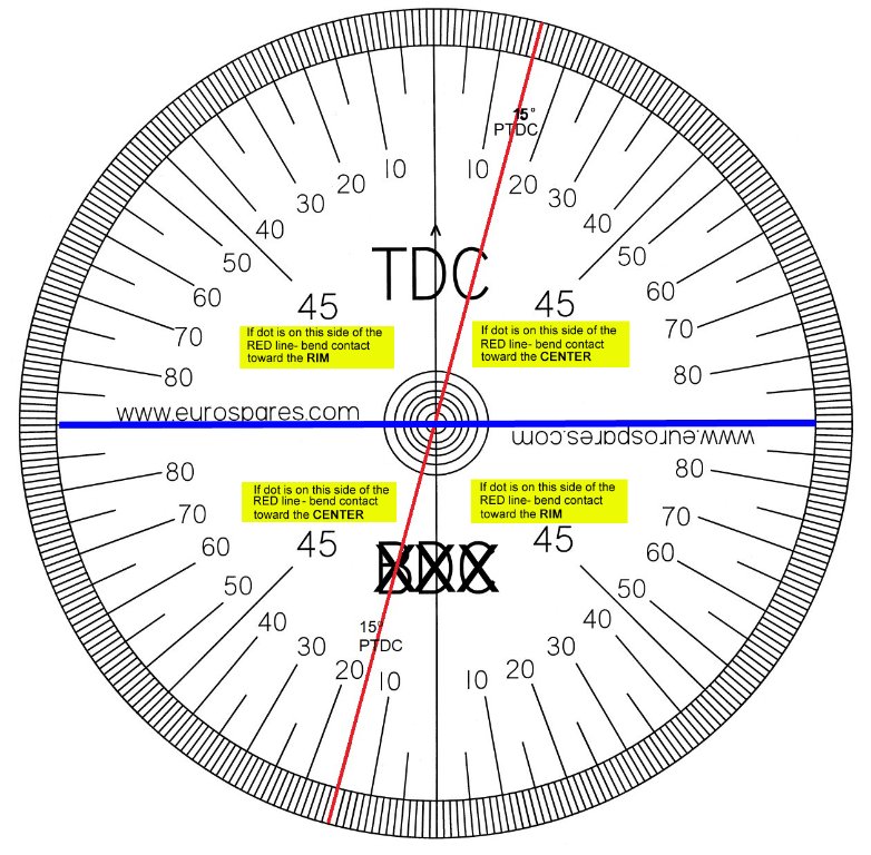

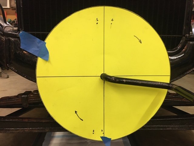

Re: Anderson timer
Referring to John Zibell's post above.
We started by enlarging a degree wheel chart to approx 2 ft diameter. Using poster board we cut a circle the same diameter as our degree wheel. From here we created a hole "dead center" of the circular posterboard (the hole being the just large enough for the crank handle to go through). Using scissors, a cut was made along the lower line from the bottom of the chart to the circular hole- this allows a snug fit between the handle and the hole. Next, tape the chart to the car so that it can't move. Then pencil a light line top & bottom where 15-degrees PTDC (PAST TOP DEAD CENTER) is on the vertical line, both top and bottom.
With spark plugs removed, and key turned ON. Start checking each cylinder, by turning the crank. Stop turning the crank when #1 begins to buzz. Put a mark on the chart at the location where the crank was when the buzz started (not finished). Be exact. Do the same with 2,3, & 4 and mark their buzz starting points. Turn the crank slowly with accuracy. CAUTION- NEVER allow the Ratchet to become disengaged. Also, excessive wear in the ratchet may cause loss of accuracy.
Dots for 1 and 4 ideally should land on top of each other, and 180 degrees on the other side of the chart 2 and 3 should overlay each other. All should land at 15-degrees PTDC. If they don't, start bending the contacts slightly until the firing point is at the 15-degree line. Bend the contacts, not the cup itself.
As you can see from the yellow chart above, the 4 contacts were out of time to the point that the firing points did not align, according to our plan, so we had to bend the contacts and hopefully create 2 dots, instead of 4, and the dots would have to be exactly at 15-degree line.
The end result was smoother lugging around corners, the end to those phantom misses, and better pulling power on hills.

- Posts: 5343
Re: Anderson timer
"Bend the contacts, not the cup" - do you bend the contacts up or down ???
- Posts: 310
- First Name: Bill
- Last Name: Robinson
- * REQUIRED* Type and Year of Model Ts owned: '21 Depot Hack, '25 Touring Car, '26 Roadster Pickup, '27 Tudor, & another '27 Tudor
- Location: Salty Bottom, ALABAMA AL
Re: Anderson timer
Depends on whether the timing needs to be advanced or retarded to make your dot land on the red line..
