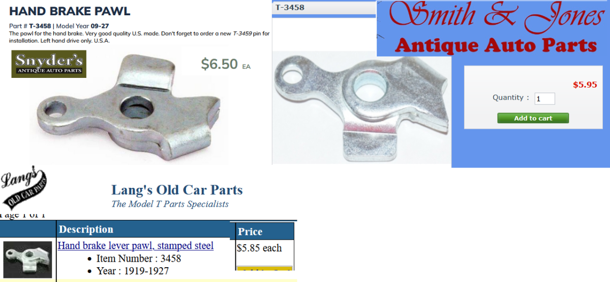

- Posts: 6590
Re: T-3456 Park Pawl.
The part number for t he pawl is T-3458
Not sure who all you tried but S&J or even Birhaven/Texas T/Fun Projects (they may have one, its something they don't make
I think)

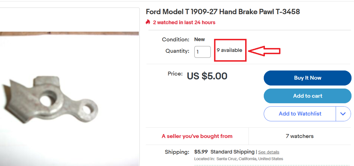

- Posts: 6590
9 available, new, on eBay https://www.ebay.com/itm/154780953684?h ... SwLvFh1M1PGeorge Hand wrote: ↑Sun Feb 27, 2022 2:49 pmParking Pawl striped it's tooth this week, went to check Snyder's Model T because they will not let you order something not in Inventory. So are the T-3456 Pawls the Latest T part made from "unobtainium"? I checked Sunday afternoon, do not believe other parts suppliers will confirm availability online as you Order George
They are selling off the old inventory from the Ford Barn. there will more listings coming
