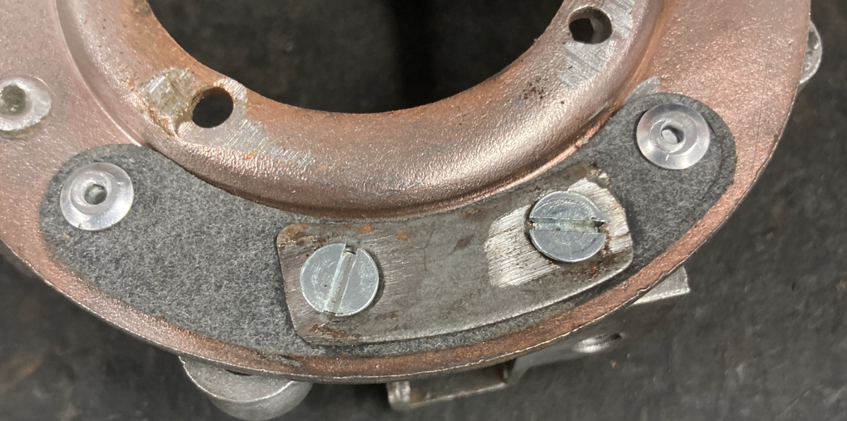

When rebuilding brush plates on both units, I use 1/8" rivets with backing washers on the new insulators and I peen the rivets.

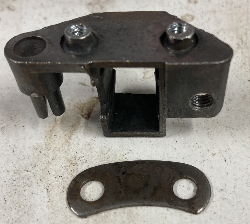

For the brush holder, its a delicate operation. First you carefully grind off the back of the holder rivets making sure when you pop the holder out you save the metal backing plate that invariably goes zinging across the floor and behind your machines. Also, leaving part of the post intact gives you a "center punch" you can use on the next step.
Then I carefully drill and tap 6-32 holes where the rivets were. I use Steel Binding Head Slotted Screws, Steel, 6-32 Thread Size, 5/16" Long on the posts AFTER I use some Loctite. There's no room for split washers here so Loctite is a must. I've fixed a few of these failed repairs when they short out when the screws back out from vibration.
There needs to be enough clearance so the new screws don't short out when reinstalled.

It works fine on the starter brush bridge too.
The only difference I do, is drilling a 2.5mm hole in de riveted parts of the brush holder before I grind of the rivet.
In the hole I tap a M3 thread (metric I live in Belgium). The screw I use are m3 x 10mm
Here a few photos of a starter bridge watch for the locktide.
Good luck
Andre
