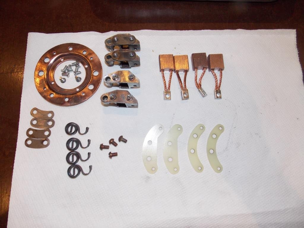

For the brush holder, its a delicate operation. First you carefully grind off the back of the holder rivets making sure when you pop the holder out you save the metal backing plate that invariably goes zinging across the floor and behind your machines. Also, leaving part of the post intact gives you a "center punch" you can use on the next step.
Then I carefully drill and tap 6-32 holes where the rivets were. I use Steel Binding Head Slotted Screws, Steel, 6-32 Thread Size, 5/16" Long on the posts AFTER I use some Loctite. There's no room for split washers here so Loctite is a must. I've fixed a few of these failed repairs when they short out when the screws back out from vibration.

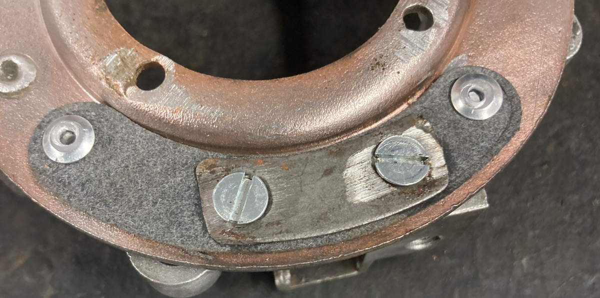

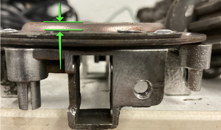

There needs to be enough clearance so the new screws don't short out when reinstalled.

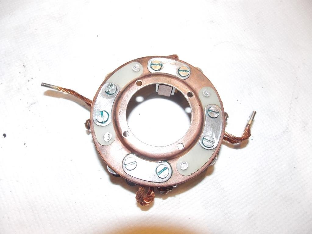

AndreFordT
Posts: 521
Joined: Sun Jan 06, 2019 12:25 pm
First Name: Andre
Last Name: Valkenaers
* REQUIRED* Type and Year of Model Ts owned: 1926 ; 1922 ; 1915.
Location: Scherpenheuvel
Re: Starter & Generator brush plate repairs
Post by AndreFordT » Wed Mar 02, 2022 1:19 am
Thanks for the information.
It works fine on the starter brush bridge too.

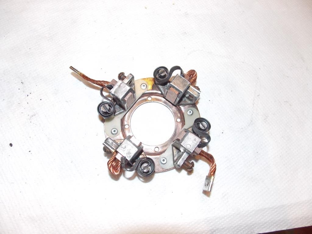

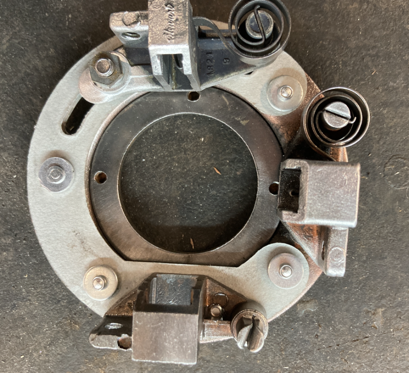

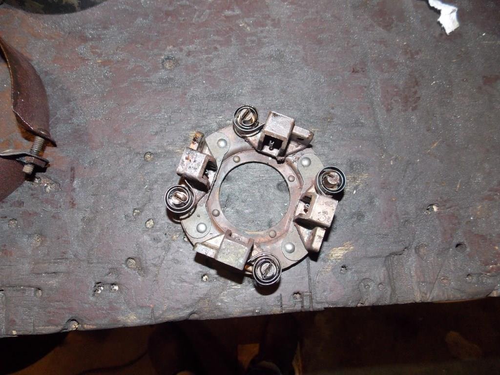

The only difference I do, is drilling a 2.5mm hole in de riveted parts of the brush holder before I grind of the rivet.
In the hole I tap a M3 thread (metric I live in Belgium). The screw I use are m3 x 10mm
Here a few photos of a starter bridge watch for the locktide.
Good luck
Andre
Belgium
watch the locktide
watch the locktide
reassembled
reassembled
ready to reassemble
ready to reassemble
before rebuild under
before rebuild up
before rebuild up
AdminJeff
Posts: 1098
Joined: Wed Jan 16, 2019 6:32 pm
First Name: Jeff
Last Name: Stevenson
* REQUIRED* Type and Year of Model Ts owned: 1921 Touring
Location: Wilder Idaho
Post by AdminJeff » Wed Mar 02, 2022 9:28 am
Andre,
While it may seem like a good idea at first glance to drill and tap the holes for an M3 screw, there are practical and mechanical issues here that indicate that it probably wouldn't be a good long term solution unfortunately.
It is common practice that the minimum recommended thread engagement to make a strong mechanical connection for a component with a tapped hole is approximately 1 times the nominal diameter in steel. Nice source that explains this in gory detail is here:
https://www.nord-lock.com/insights/bolt ... pped-hole/
A metric M3 bolt has a nominal diameter of 3 mm. That means that to hold that size bolt without the chance of stripping under stress, and the torques involved inside the starter when engaged are absolutely insane, the minimum thread depth for that screw on the brush plate should be 3mm. There is nowhere near that much material on the brush plate, so these tiny bolts run the real risk of stripping and backing out. I suppose you could use nuts on the back of those bolts but that might interfere with the clearance of commutator. I'm not sure, but I know there's not a lot of room in there.
I'm taking a leap and guessing that Ford (or whoever built the starters for Ford) knew this and therefore, unlike on the generators where there is very little stress on the brush plate, they used solid rivets both for mechanical strength and superior electrical conductivity, which are both an absolute necessity in this harsh application. I have never seen a brush plate fail at these rivets.
Of course, as always, your mileage will vary!
