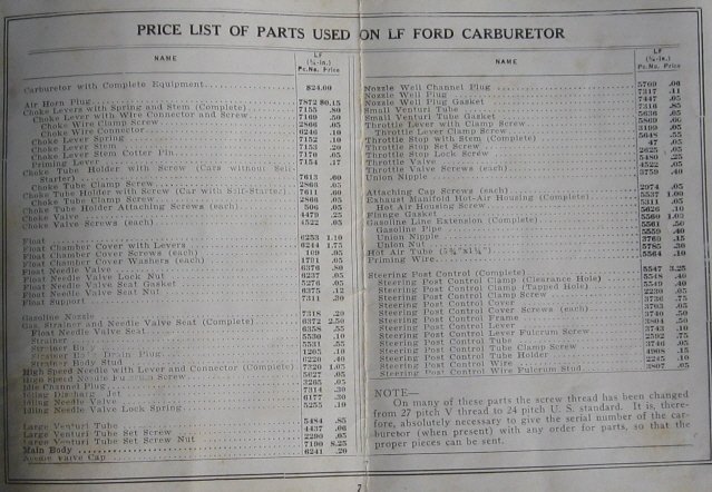

For a Ford, it should be the LF-1? Another piece of a huge, fantastic Stromberg puzzle! With part numbers. Drool. ;)
