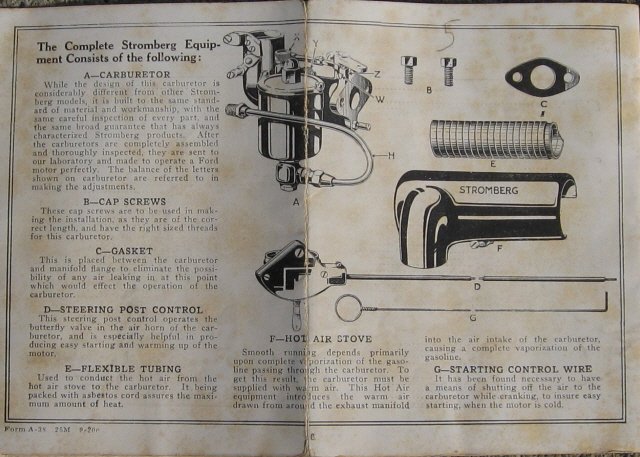

Copy each page of this post and print it out and you will have a copy!

For a Ford, it should be the LF-1? Another piece of a huge, fantastic Stromberg puzzle! With part numbers. Drool.
