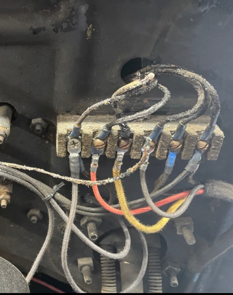

Wires melted and now won’t start

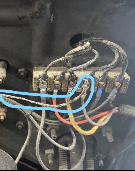

Scary moments. I left the key in the ignition, and in the on position by mistake. Then hooked up the battery tender. A few hours later and lots of smoke, the wires leading off the amp meter and gages melted. I replaced all the wires but now the car won’t start. I hear the starter turning but no dice. I have a 1924 Tudor with a generator and alternator. From what I’ve read I think I messed up the generator? Thoughts on how to diagnose, what to fix? Thank you!!

All the wires going from the terminal block through the firewall look damaged in the photo. Only one wire going from the terminal block to the underhood area looks bad.

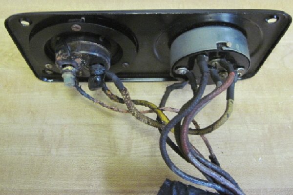

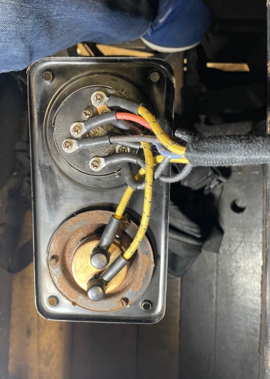

If your lucky its just the backing plate. Ammeter may have survived. Post a picture of the ignition switch.

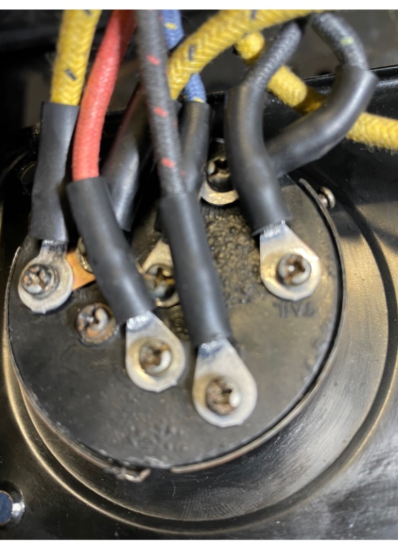

Eli, can you identify what that burnt wire is on the body side of the junction block, looks like it might be wired to the tail light?

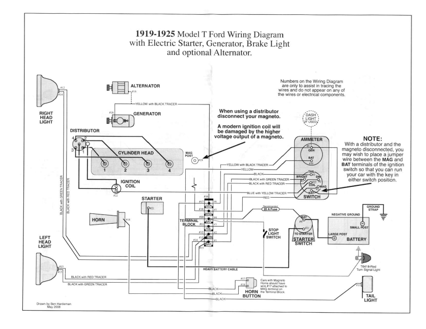

@Steve Jeff. I went off the texasparts.com diagram for wiring with a Distributer. I rechecked and as far as I see it’s correct.

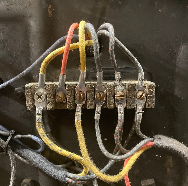

New pic after replacing melted wires:
@TRDxB2 do you want a pic of the back of the switch where the wires are connected behind the dash?

@humblej that burnt wire is the one that goes from the Distributer coil to the back of the dash. Replaced with me blue wire in picture with yellow stripes.

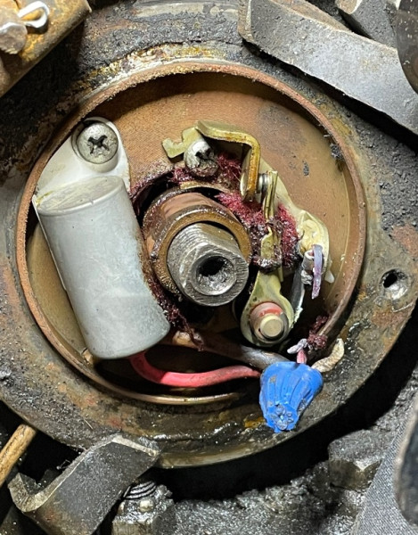

Eli, you fried your points, condenser, and or coil, that is why it will not start. I would not assume the problem that caused the fire went away just by replacing the wires.
Your ignition switch may be bad, it may have been bad before the fire, but since your wires are burnt there could be damage to the switch too.
If your junction block is stripped out and needs a longer screw, I would suggest replacing it with a new junction block. It is possible to run a screw too long and have it ground out on the metal firewall.
You should add an in-line fuse close to the starter switch to the yellow wire.
Fire with the key on bat should not have caused a burned wire on whatever is connected at the tail light wire junction, what was that wire for?

Thanks J. I replaced the coil too. Still won’t start. I bought the fuse and about to install that. So next is points, condenser and block. I’ll keep plugging away. Thank you.

Looks like Lang’s only sells Bosch Distributer and parts. Not even sure what I have on my T. Any idea where I could get parts for this? Also my fan belt keeps slipping off and while taking this picture it seems the belt is rubbing against this Distributer setup. Probably why. Maybe time to buy a new one? But they look pricey.

Eli, what was this wire for? Looks like it is connected to the tail light.

I believe that was the wire that went to the positive side of the distributer coil. It melted and the wire broke there. But it bypassed the terminal block and ran through the firewall hole to the back of the dashboard. I replace it with the blue wire with yellow stripes on it.

The picture of the melted wire makes it look like it is attached to the terminal block but it wasn’t .

Eli, OK, I see now.
I would suggest testing the magneto by cranking the engine over with the starter and see if you get power off the mag post. If you have a good mag I would consider converting back to the Ford timer and coil ignition system. If you do not have a good mag I would still consider the change, but a good mag makes it a no brainer to do.

I agree with everyone that you need to address the electrical issue first. GET THE ELECTRICAL ISSUE ADDRESSED FIRST! You need to have fuses, trust me. You don’t want this to happen.

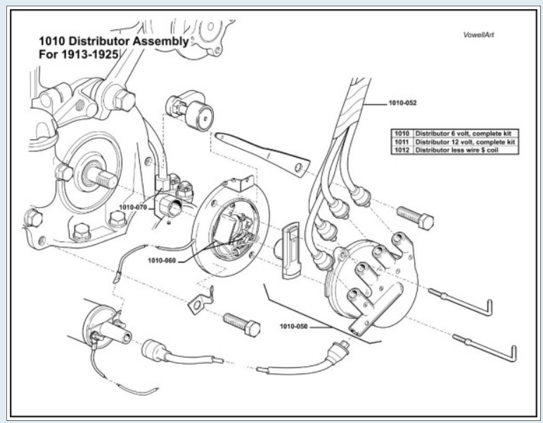

Eli, that appears to be a Model T Ranch distributor, https://modeltranch.com/show_product.asp?idProduct=5,. I don’t think I’ve ever seen a fan belt guide that positions the belt like that on the crank pulley. The position of your fan assembly arm my need adjusting. Curious, do you have a water pump on your engine? I’m not going to get in the debate of for or against water pumps but just asking because of the belt alignment. An option to consider without knowing any of the above is to get the smaller pulley for the crank to give you more leeway on the belt positioning though it may require you to get another length belt. I believe you also can reposition the belt tensioner that comes with that set up you have.

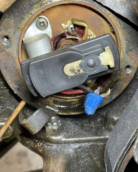

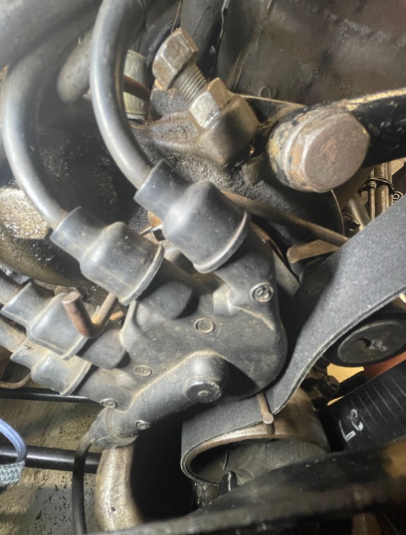

Your distributor is from a Honda. The fan belt should run on the other side of the idler pulley, the idler pulley is used to keep the fan belt off the distributor. I think the Ford Barn in Spokane Washington sold those, but I am not sure. If you can’t find distributor parts it may be easier to change to the currently made VW type. I believe the biggest problem with the Honda type was the idler pulley failure . The Honda distributor may use electronic solid state components and they were most likely damaged in your electrical fire. Be sure to change out that thermal block, a extra long screw touching the metal fire wall is a direct short to ground, bad news and burnt wires if and when that happens.

Here's what I think happened: You left the ignition "on" in the "Batt" position. The points in the distributor happened to be closed, so the coil was receiving a continous supply of battery current, which caused it to overheat and short to ground. This caused the ignition primary wire to burn up and break the circuit. The points are probably damaged. Other wires near the ignition primary wire may have been damaged. The ignition switch, which I assume is the original Ford-type switch, may be damaged. I don't think the battery tender had any role in your problems. The coil may or may not remain shorted to ground. I would replace it, regardless. I would replace or rebuild the ignition switch and replace the points and condenser and examine any internal wiring in the distributor for any signs of overheating or abrasion. I would replace the firewall terminal block and any wiring that showed any evidence of heat damage or abrasion. ** If your ignition system uses an ignition resistor, it is probably damaged. I would replace it.

Is that an idler pulley above and to the right of the crankshaft pulley? It looks like an idler designed to keep the belt away from the non-stock distributor. That would explain the odd position of the belt guide.

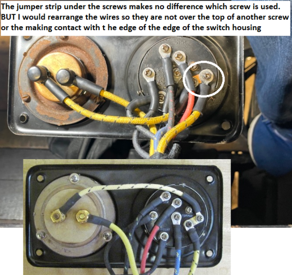

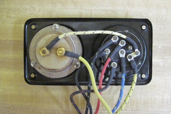

- Posts: 7411
Re: Wires melted and now won’t start
One of my Model T pet peeves is "creative" wiring with the wrong colors. #4 should be green. I'll forgive the headlight wires because they retain the basic black. In fact, the tracers are a helpful aftermarket accessory.

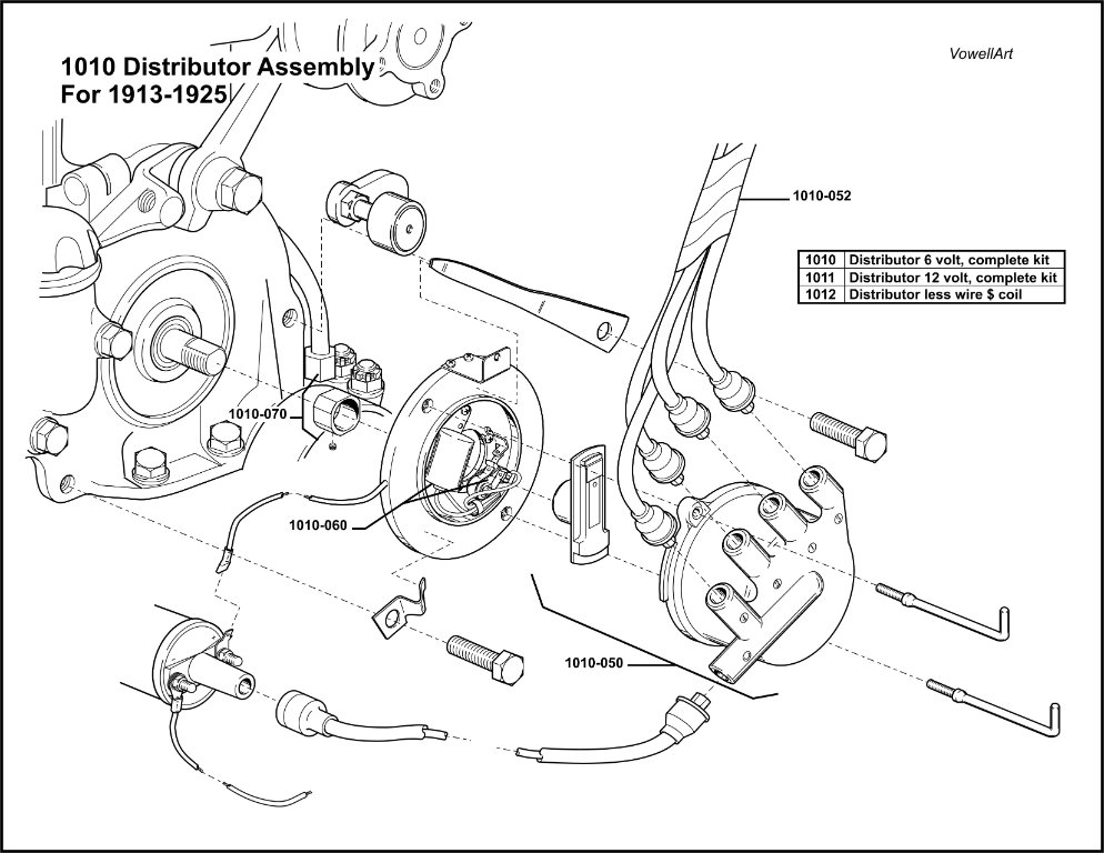

Here a wiring diagram for a distributor

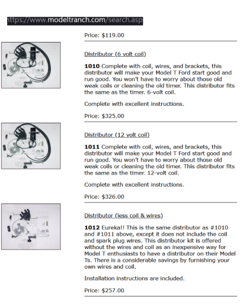

- Posts: 6797

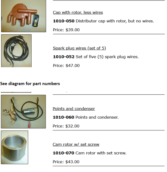

It is a John Stoltz design distributor system. It was, and is, sold by Model T Ranch.
https://www.modeltranch.com/search.asp

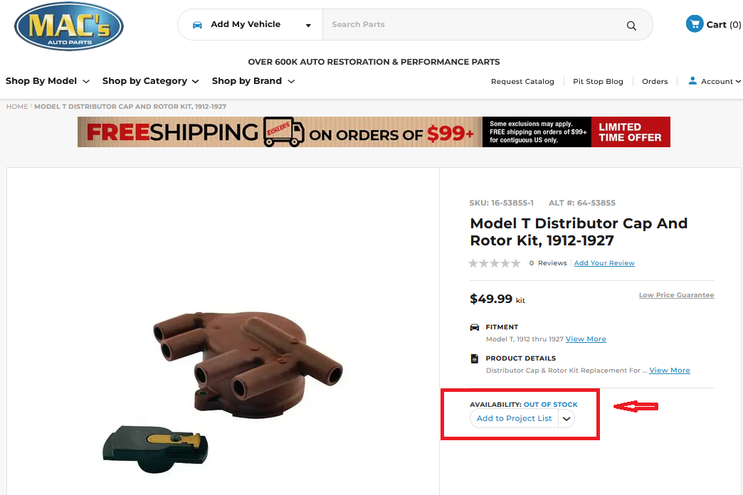

if you want to pay 25% more and buy it from MAC's, then you can buy it from MAC's, but the SOURCE is Model T Ranch. This product has been out there for like, forever (if 35 years is "forever")

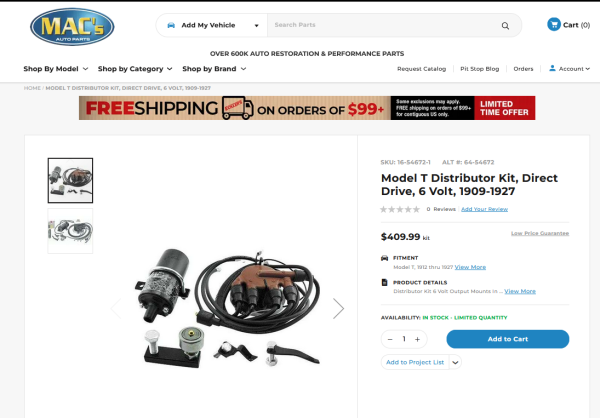

- Posts: 6581
Thanks --- Forgot about Model T Ranch. MAC's (aka Eckler's) does seem to have higher prices on some thingsScott_Conger wrote: ↑Sun Apr 03, 2022 3:50 pmIt is a John Stoltz design distributor system. It was, and is, sold by Model T Ranch.
MODEL T RANCH Prices

Thank you! Looks like I’m shopping tonight at model t ranch

Should I get new spark plug wires? Or just the cap, points and condenser.

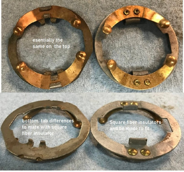

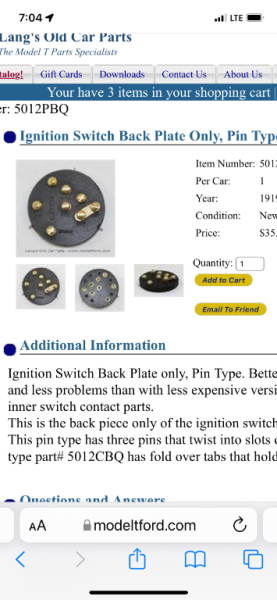

- Posts: 6581
You may not need all these parts. Most condensers are common, points should be okay if not welded together. Small pitting is common and can be filed off. Distributor cap and rotor should also be visibly okay. Checking continuity of spark plug wires and inside/outside of distributor contacts.

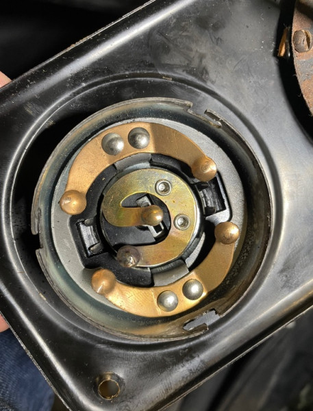

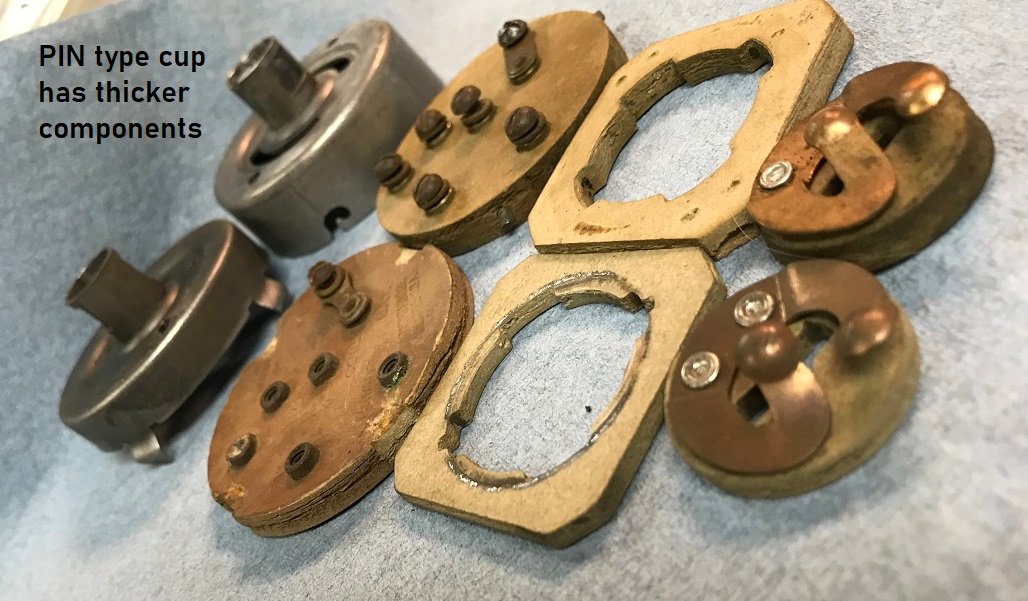

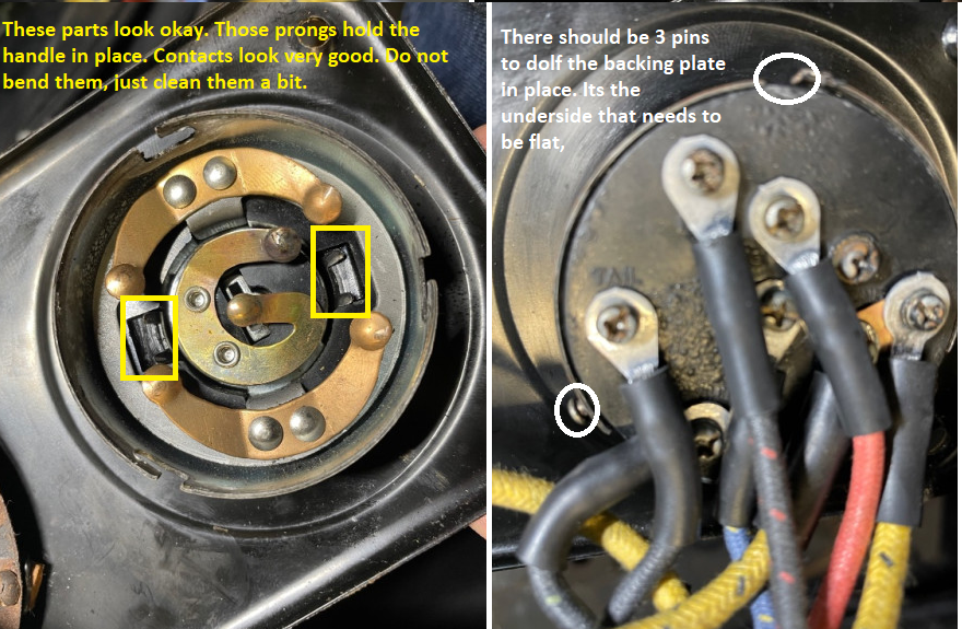

Still my feeling is its the ignition switch. A fiber disk with brass contacts connected to melted wires - just sounds like something has to be wornfg. Not sure what you have PIN or CLIP-ON style but individual parts are very similar. --
Depending on the switch handle this part may be different
ecory0
Topic author - Posts: 90
- Joined: Mon May 03, 2021 7:55 pm
- First Name: Eli
- Last Name: Cory
- Location: Bristow, VA
The ignition switch would make sense since the plastic backer on the key switch was a little melted but the wires closer to the alternator looked ok. I’ll replace that first and go from there. It’s less expensive than changing the alternator.

Why not hot wire. Get voltage to the distributor. With the points closed, open with a tool & look for a spark @ the points, then a spark plug. Eliminate the ignition system as bad & bypass the switch which is likely damaged.

Ohhhh plastic backer on the ignition switch!

Perhaps the switch overheated and shorted to ground, rather than the coil.
That situation often happens if the engine is stopped while the points are closed and the switch is left On.
That causes a maximum current flow through the coil. A fuse in that line would prevent the fire.
A fuse in the yellow wire to the battery is recommended, but can cause another problem, if it blows with the engine running and the generator keeps the engine running.
Then the generator burns out from no place to send the current, except though the field coils which makes extra current!
It happened to a friend when the key was left in the ignition switch with a heavy fob attached.
Driving down a rough road allowed the fob to turn the key to On.
The trailer was tight enough that the fire burned and snuffed out the oxygen needed for a good burn.
When he got home and opened the trailer side door, he could not even see the Model T as the smoke was still too thick.
The area where the wires come through the firewall often has a grommet to avoid the short out situation, even though the metal is rolled over around the hole and not too sharp there.
The other common problem area is some of the small early ammeters have cardboard insulators on the terminal screws.
They dry out and let the terminal screw drop down.
The wire from the generator goes through the ammeter to the battery and is always hot.
A lot of fires have happened because of a short there.

Don't order anything yet till you oped the switch. If is the PIN style you need to press down one the disk and rotate counter clockwise. I find it easier to bridge a small screwdriver across some screws to act as a lever while twisting. Many ignition switches and parts may be out of stock. Don't take more apart than than the photos aboveecory0 wrote: ↑Tue Apr 05, 2022 7:08 amYes, not sure why my fingers keep typing alternator when my mind it thinking distributor…. Ugh. Going to order a new switch first. Should I just get the back part or the entire switch? And does it make a difference which back type I purchase? Looks like there are two types.

J1MGOLDEN
- Posts: 1322
- Last Name: Golden
- Location: Bowie, MD
George, to disconnect the battery cable would be far more difficult than just getting out a sharp knife from your pocket and cut the yellow wire leading to the battery, which I have done twice and seen done three times.
Here is one example.
note the correct ammeter is installed now.
ecory0
- First Name: Eli
- Last Name: Cory
Looking at Jimgolden’s picture, I think I have the Yellow stripped wire from the amp meter going to the wrong screw?
- Posts: 6581
The backing plate obviously got very hot. The bobbles on top are of no concern. Its the underside that needs to be flat. It looks okay but seems to be missing a pin. You can use a small machine screw but be careful not to split the disk or be to long and contact a screw. Some rub the bottom of the switch plate face down across some sand paper, light sanding, to flatten it and clean it up a bit. It actually might be okay. The material that the backing plate and internal parts are made of where part of a restoration kit, and/or reproduction switches (when?). I have a set that I was unsure of, but after seeing what it went through I'd say its not a bad repro. I have other ones made of different materials.
The connection you question are Okay since there is a jumper under the two screws. But I would rearrange and separate the wires a bit like Jim did to avoid any accidental contacts.
The ammeter you have is a substitute, a 1926 style in an adapter plate. No need to replace it unless your trying to be year perfect. Then your only choice is a used one since repro's don't appear to be available anymore. Used ones are available but "Buyer be aware" they may not be working.

"It is a John Stoltz design distributor system. It was, and is, sold by Model T Ranch." (S. Conger)
This is a long string of posts, and I scanned over them. Maybe it was mentioned, however, I didn't see any reference to checking the ammeter. In a circuit without any fuses, the ammeter is the weakest link. If your lights work, check whether it moves to discharge when they are on. If so, it is good and correctly connected, at least the light circuit is correct. If you have a tester, you can test for continuity. If it is open, you will need to replace the ammeter.
- Posts: 4681
The distributor setup is as Scott C. pointed out is a Model T ranch product. The Model T Ranch website has repair parts listed for their distributor set-ups. Maybe checking out the distributor may be a good idea if the wiring has been been gone over and replaced as necessary.
The parts are available.

Well… got to the bottom of it all. First, thank you to everyone for helping me with this. As you can see in the pictures, the wires in the distributor melted apart. I think that is a clue, lol.
- Posts: 5591
Is that's what's left of a wire nut ??????????
- Posts: 4471
Yup, that's a mess. The condenser rubbing on the cam wasn't a great thing either.
- Posts: 6797
Photographic proof that not all repairmen are mechanics.
- Posts: 4681
That’s the first place I would have looked if I had a T with a distributor. But at least we now know what caused the trouble.

Not done diagnosing yet, what caused the short that burned up the wire? That was the end result of another problem.
- Posts: 8639
The coil may have shorted to ground, or the capacitor may have shorted to ground, or the points themselves may have shorted to ground. It's possible the flexible wire inside the distributor that connects to the points grounded. Any of the preceding could have resulted from leaving the key on with the points closed for an extended period of time.
- Posts: 4681
The over packed distributor is probably the main cause of the short issue. A careful eyeball inspection shows the condenser being continually rubbed by the shaft is a no-no. If not that the wiring being jammed inside the distributor looks like it shorted and if the key was left on something eventually got continuity and then
A common problem with a distributor is that the points stick closed which gives a constant ground. If your bushings in the shaft are worn, the cam moves away from the block on the points and the point gap gets smaller until the points stick. So check the point gap and also try to move the shaft side to side to see how it fits.

Jerry, I believe Norman is referring to worn bushings and play in the distributor shaft, not the engine cam shaft.

Yes, I know, but if you look at the distributor he's using, you'll see that the rotor runs directly off of the cam shaft. It's not your "normal" type of distributor.MichaelPawelek wrote: ↑Mon Apr 25, 2022 6:08 pmJerry, I believe Norman is referring to worn bushings and play in the distributor shaft, not the engine cam shaft.

First off you should have done a visual inspection off all the wiring and the distributor. An ohm meter is a good investment to check continuity of your wires and switches.it does not have to be a high dollar unit, any possibility of taking your points and condenser to your local parts house and see if they might be able to find a match. Some of these parts people can find anything.
As for your fan belt and idlers and pulleys, takea look under the hood of your daily driving car and you can get a general idea of how idlers are used to route belts around things and not rub. Your belt rubbing on that pin by the distributor is incorrect and the belt should be under the idler and against the back side of the belt.
If all else fails a timer and 4 coils can make a T purr and is easy to use a jumper wire on to test and bypass circuits.
As for your wiring block, yours looks original and looks like pressed sawdust. Since you are not running a show car, bgo to a parts house and get a modern one and mount it on a piece of Delton or hard rubber and then mount it on the firewall and it will not short out if a screw is too long. Even a piece of a kitchen cutting board would insulate the backside.
