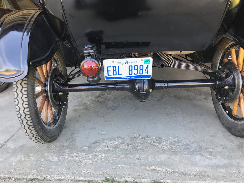

Personally I like front brakes. Several era versions were offered. The radius rod can be reasonably easily doubled. The kingpins have not proven to be a problem. Coupled with a era accessory real steering box and it drives pretty good.
Unfortunately NO I’m not offering to supply them as the “naysayers” have worn me out! You can bid on them at my estate sale.

Post by Oldav8tor » Tue Apr 12, 2022 5:23 pm
I am in California....rain???? rare....and I would never drive in rain anyway. Not in a t.....
I prefer not to drive in the rain if I can help it....sometimes mother nature has a different idea :lol: BTW - my passengers were from California...
