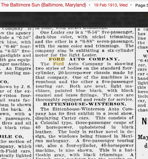

According to a December 1913 Ford factory letter (McCalley, "Model T Ford" 555-556) the early 1914 Fords were painted as follows:
Chassis and fenders were painted black.
Bodies and wheels were painted blue, a very dark blue-black color.
Wheels were striped in "Fine French Gray."
The bodies had primer and filler layers followed by three coats of color: one coat of F-113 "blue ground" followed by two coats F-115 "body spraying blue color varnish." The wheels had one coat F-108 black surfacer and one coat of F-109 "blue color varnish."
Fenders, frame and axles were finished with various forms of black Japan and black brushing.
The hood is a question. The hood and rear axle have F-103 "first coat blue dipping," but while the rear axle gets a second coat of F-104 "quick drying black," no second coat is listed for the hood. It is uncertain whether the hood was left as is, or whether a second coat was given. All the other significant elements have at least two coats of color, making it exceptional for the hood to be left with one coat. It's possible that the hood was accidentally left out and would have had a second coat, presumably of F-105 black, but this is based on stylistic and systematic consistencies.
One element in support of a black hood would be ease in production, allowing any body to fit any chassis. Another element is found in prevailing style trends among automakers in 1914, with black hoods and fenders common among many manufacturers.
Contextually, December 1913 is just at the moment Ford is ramping into serious mass-production, so we still have older stylistic elements like blue that have not yet been eliminated. Just when it goes to all black is uncertain, although early calendar 1914 is a good choice for open cars. Closed cars were very likely to have kept color on the bodies longer than open cars.

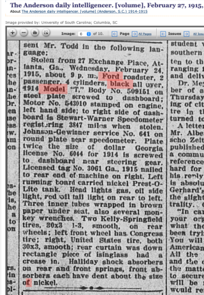

Here is a February 1915 notice regarding an overall black ford runabout with a July 6, 1914 engine number. The description is very detailed, so it's clear it was an overall black car. This suggests that Ford adopted all black (for open cars at least) sometime in early calendar 1914.
For an October 1913 touring, black with a blue body and blue wheels striped gray would be very fair. The blue is very dark, described as "blue-black" in comments from early 1913, so the contrast with black is subtle.
I think a lot of people err on the side of all-black, but the data does support blue, at least through late calendar 1913 and probably into early 1914.
