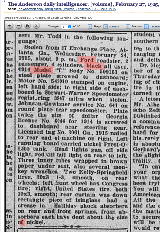

Here is a February 1915 notice regarding an overall black ford runabout with a July 6, 1914 engine number. The description is very detailed, so it's clear it was an overall black car. This suggests that Ford adopted all black (for open cars at least) sometime in early calendar 1914.
For an October 1913 touring, black with a blue body and blue wheels striped gray would be very fair. The blue is very dark, described as "blue-black" in comments from early 1913, so the contrast with black is subtle.
I think a lot of people err on the side of all-black, but the data does support blue, at least through late calendar 1913 and probably into early 1914.
