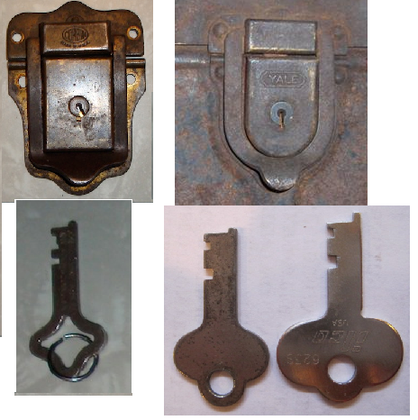

As Steve said, there were many aftermarket tool boxes made and for each of those many different cut keys. So to start with what does you lock look like - that may help ID the shape of a key blank. Here is an example of two different period tool box locks. The blanks look similar just cut different. Even for the Yale lock there are two slightly different shaped blanks but they are cut the same. Now if your lucky the middle tooth is what releases the lock, so its possible to pick these types of locks
