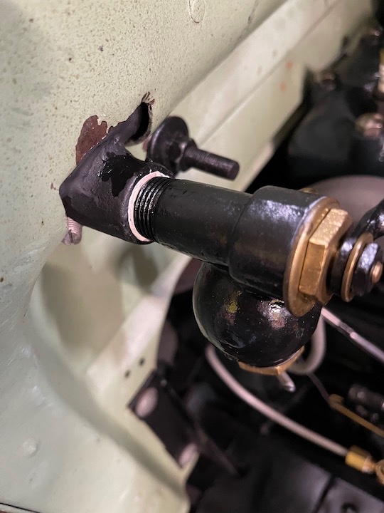

So I have a very small seeping leak from where the sediment bowl goes into the gas tank. I'm thinking that the guy who redid the tank for me hat the threads painted. I did as well with the sediment bowl. I used a gas approved sealent but I still have a small leak. So I'm thinking I need to get a tap for pipe threads. Are these 1/2 inch threads?
The leak is so small that it just makes the hood shelf paint a bit tacky.

yes, standard pipe threads. They are tapered, so do not go too deep.

Look very carefully for a crack in the gas tank fitting. Due to the taper of the threads, if someone overtightened the sediment bowl in the past, it may have split the gas tank fitting. Sure hope not...

Hope it isn’t cracked but sometimes it won’t show up until you start tightening up the fitting . Gas has a way to seep out even though the crack is almost invisible. You may not see it when you take the fitting out so look very carefully.

I see a potential problem. The fitting is threaded with tapered threads and you must turning it at the correct place to position the bowl at the bottom. So the thread is likely just a little deep. If you try to turn it one more turn, it might stop at the wrong position. So the permatex would be a good solution. Or possibly gasoline proof teflon tape around the fitting. Not close enough to get the tape inside the tank.

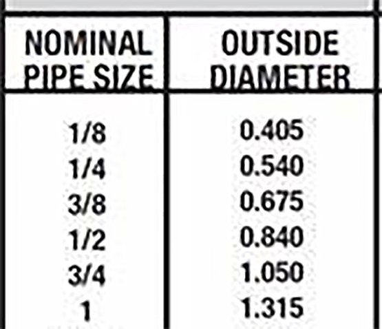

As for pipe size measure the diameter just before the threads.

Do not run a tap through. You will certainly upset the alignment of the tap outlet and the result is the need to realign the fuel pipe to the carburetor. Is the leak at the thread? Might it be from the outlet tap itself?
