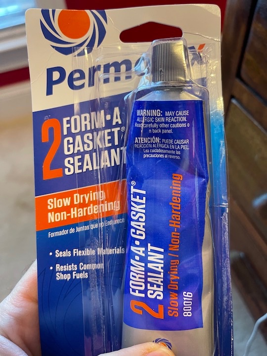

So I take it that this is the stuff to use. Says it's for gas.
- Posts: 6815
Re: What size pipe threads are these?
that's the stuff, but for what you're using it on, that size will take you through to the rapture and beyond...I usually buy the tiny tube and use it for about 20 years. I use it only for pipe threads and not for gaskets or gasket making...for that I use Ultra Black. When sold in the little 1.5 oz tubes it is marked as "2A" and that's the only difference that I've ever been able to determine

Thanks Scott! I coulden't find a small tube. It's like when I bought a tube of EZ Turn. Ha!!! I'll be sure to leave it in my will.
