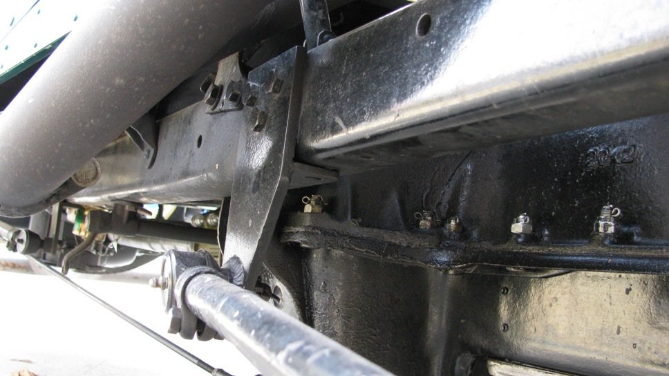

Looking for photos or information on Model T split wishbone setups from the 1920s or 1930s. I am particularly interested in how the wishbone rod mounted to the frame. I don't really want to use a modern ball joint style mount as it won't look correct.

Here are a few

Post by TRDxB2 » Tue May 10, 2022 3:36 pm
Two more (I have both - haven't decided which I am to use)
Hank's
HANK s.jpg (83.5 KiB) Viewed 3087 times

Using Model A Tie Rod ends is another method. Not 100% era correct, but much better than using heim joints or modern tie rod ends.

Post by TRDxB2 » Tue May 10, 2022 9:40 pm
Model A designs

These are Ford 8N parts. Might be helpful if your'e scratch building your radius rods and they do have the "vintage look". Readily available on Ebay. Enjoy
