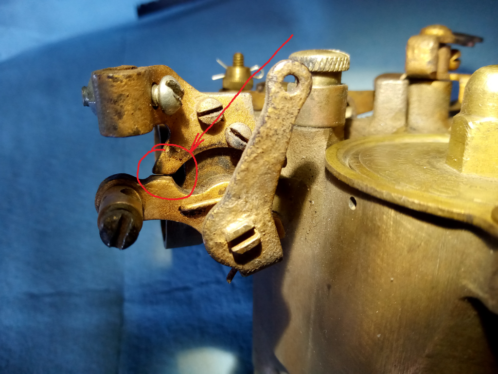

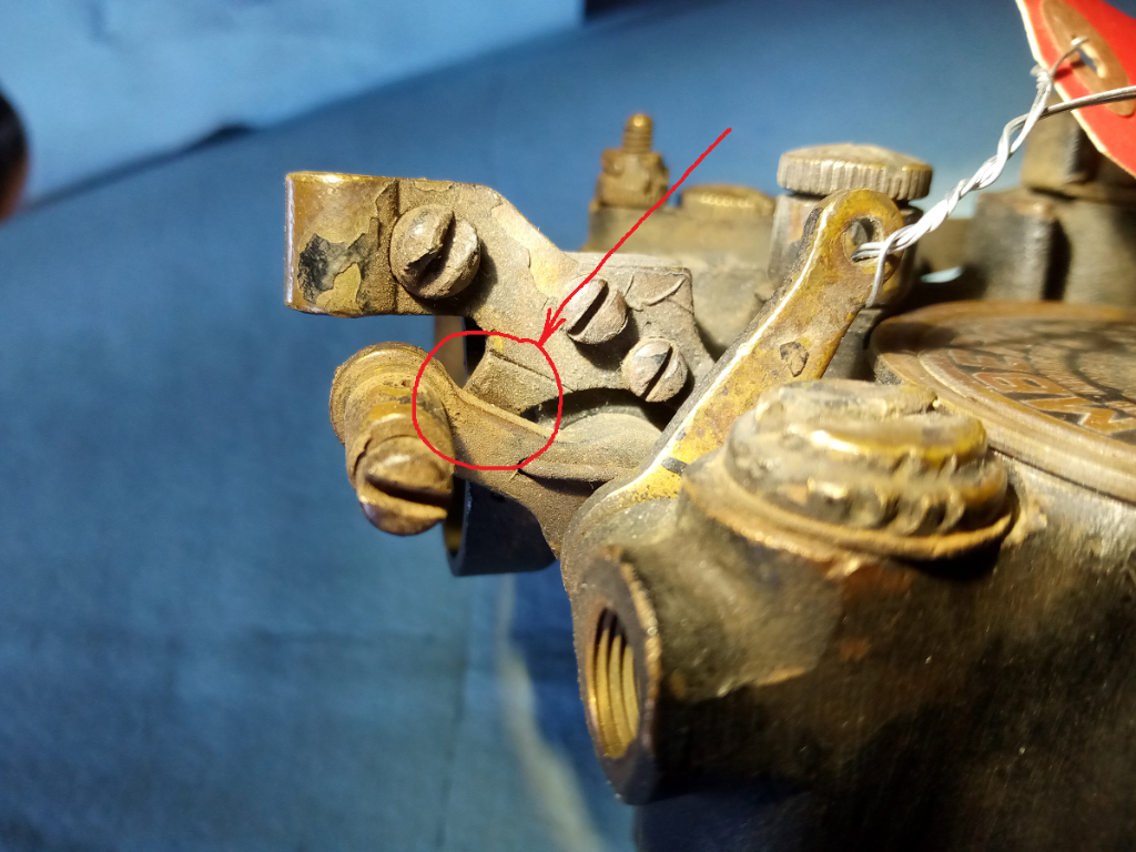

Well the answer to that is the choke limiter tab on P/N 8468 Choke Tube Holder. That tab is bent "out" to engage the choke lever and hold the choke open to the rich/run position, and when cranking at the front of the car, the operator pulled the choke wire as normal to over-ride the limiter. That's what the spring in the choke assembly is for! Once the car starts, the operator releases the choke and the choke plate is automatically readjusted back to rich/run and there is no rush to get back to the driver's seat. Nifty!
Now you know why the coil spring is there and maybe you'll want to be sure the tab on YOUR carb is either bent out to engage or bent in to miss the choke lever as would be correct for your car.
Here is the tab bent "in" and the choke is full "on" for starting with a starter (see circled area):
Here is the tab bent "out", limiting the amount of choke applied from the driver's seat, but can be overcome by the operator in front of the car by pulling the choke wire and energizing the coil spring (see circled area). as an additional note, this carb has the float bowl vent at the top side of the bowl - this carb would have a NON-VENTED float rod nut:

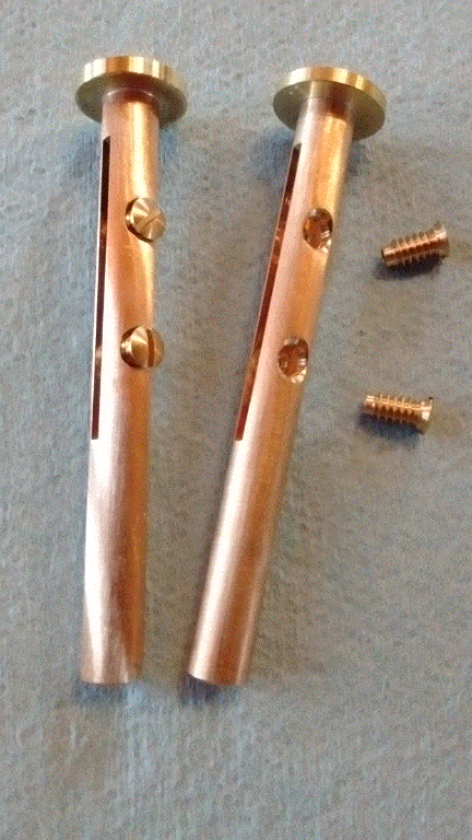

I have an OF that has the throttle holes and shaft that have seen better days. What is the process for alignment when drilling for new bushings? Can the shaft be 'brazed' and resized, or is it better to just turn out a new one? I really can't believe my T was running with how worn out it is, but I did witness it myself a few years back BM (before mothballed).
Topic author - Posts: 6801
Re: Stromberg OF tip of the day
Fixturing prior to and during machining is key to keeping things in line, with post bush-install ream and sometimes line lapping for a dead-close fit that does not bind.
The wear you found is normal in as-is OFs. The economizer ramp forces are very hard on the throttle shaft, and the original shaft is made from fairly soft brass that is almost certainly 360 brass which as you've found isn't inclined to hold up very well.
I would not be inclined to braze up a shaft ... I simply make new ones when I need them
