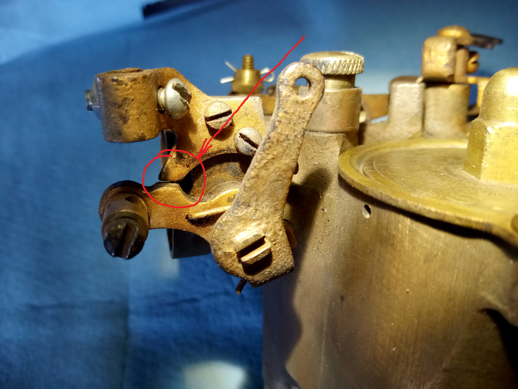

When the Stromberg OF was sold to mount in a Model T, it came with a choke control that mounted on the steering column. When you started the car with the starter on a cold day, you simply put it to "Choke" (full "on") and once the car started, you immediately moved the control to rich/run which opened the choke plate from full closed to only partially closed. This is the only richness adjustment available after the initial set-up on the car when the carb is installed.
But what if it was a hand-crank car? How could you set the choke control to full choke, crank the car and then run around to the driver's position quickly enough to ease up on the choke?
Well the answer to that is the choke limiter tab on P/N 8468 Choke Tube Holder. That tab is bent "out" to engage the choke lever and hold the choke open to the rich/run position, and when cranking at the front of the car, the operator pulled the choke wire as normal to over-ride the limiter. That's what the spring in the choke assembly is for! Once the car starts, the operator releases the choke and the choke plate is automatically readjusted back to rich/run and there is no rush to get back to the driver's seat. Nifty!
Now you know why the coil spring is there and maybe you'll want to be sure the tab on YOUR carb is either bent out to engage or bent in to miss the choke lever as would be correct for your car.
Here is the tab bent "in" and the choke is full "on" for starting with a starter (see circled area):

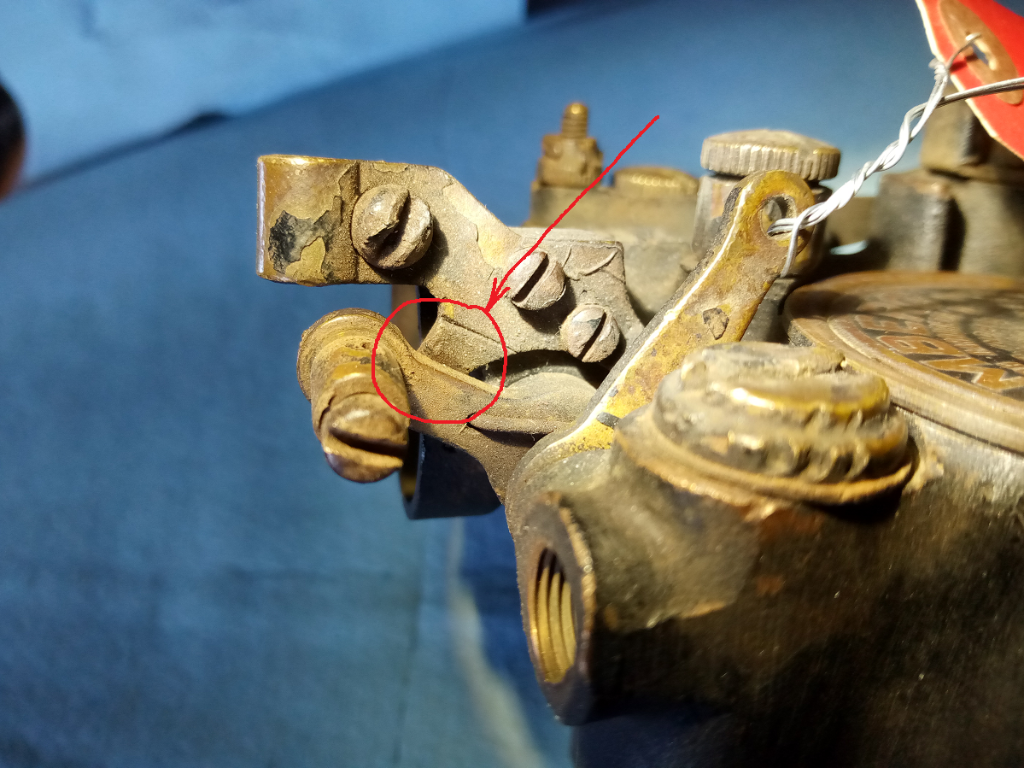

Here is the tab bent "out", limiting the amount of choke applied from the driver's seat, but can be overcome by the operator in front of the car by pulling the choke wire and energizing the coil spring (see circled area). as an additional note, this carb has the float bowl vent at the top side of the bowl - this carb would have a NON-VENTED float rod nut:
