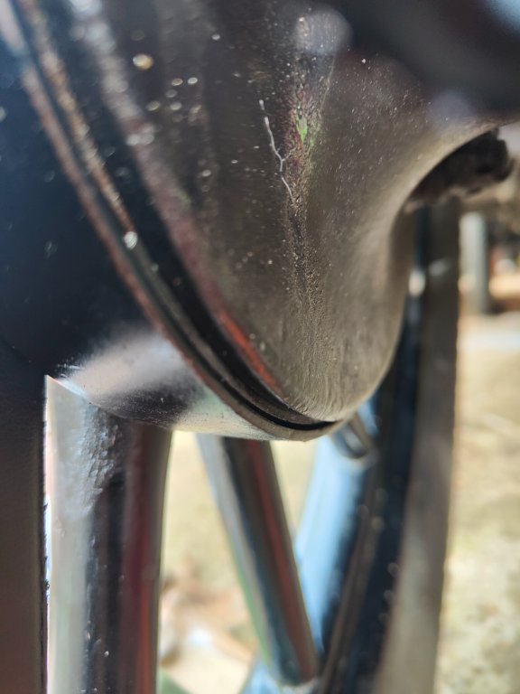

Thank you all for your responses. I tried each of your suggestions over the weekend, except swapping the wheels over. Nothing appears to be rubbing, the wheel fits securely, and the handbrake works as before when tested.
I attach a photo, which hopefully shows that the brake shoes are just visible. My question is, will this cause me a problem if left as is, or is it purely cosmetic?
Many Thanks for your excellent responses.
George
George
- Posts: 5119
Re: Rear Wheel Fitting
Did you tighten the axle nut all the way, without the key & rotate as a test? This would confirm the outer seal is not on all the way or there is no clearance issues.
Either way that gap would not bother me.

- Posts: 6708
Actually, the brake drum is not supposed to cover over the backing plate, but come up to just about the outside face...
If one side DOES cover and run flush with the inside of backing plate, then that hub on the wheel has likely wallowed out and is going onto the axle farther than designed...if so, join the club...a great multitude of wheels run thusly and it is because someone or many owners, did not keep the axle nut tight.
