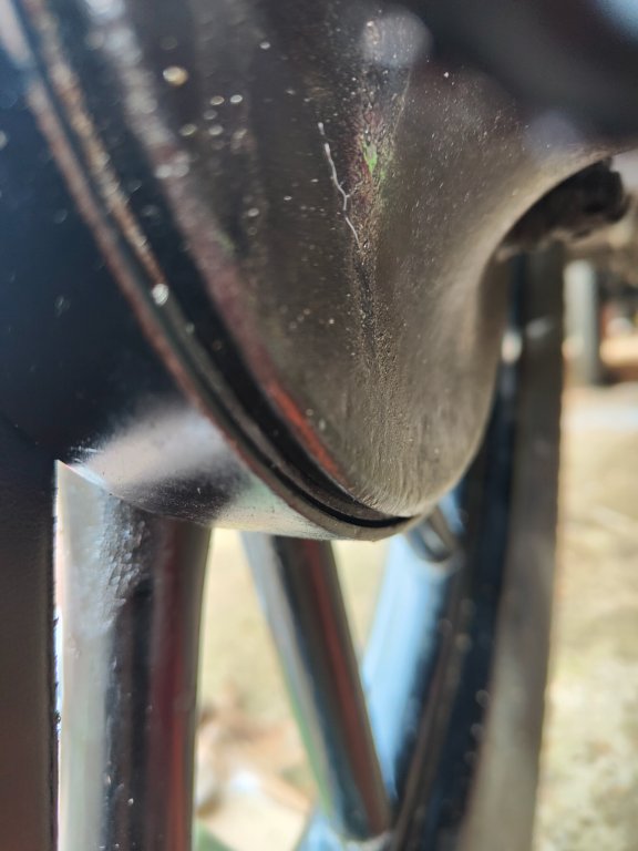

Post by GeorgeHounslow » Mon May 23, 2022 2:47 pm
Thank you all for your responses. I tried each of your suggestions over the weekend, except swapping the wheels over. Nothing appears to be rubbing, the wheel fits securely, and the handbrake works as before when tested.
I attach a photo, which hopefully shows that the brake shoes are just visible. My question is, will this cause me a problem if left as is, or is it purely cosmetic?
Many Thanks for your excellent responses.
George

Post by speedytinc » Mon May 23, 2022 2:56 pm
Did you tighten the axle nut all the way, without the key & rotate as a test? This would confirm the outer seal is not on all the way or there is no clearance issues.
Either way that gap would not bother me.

Re: Rear Wheel Fitting
Post by Oldav8tor » Mon May 23, 2022 3:18 pm
If you jack up both wheels, can you move either of the wheels in and out? Have you ever opened the differential housing and determined whether you have brass or Babbitt thrust washers?

Post by Scott_Conger » Mon May 23, 2022 3:23 pm
Actually, the brake drum is not supposed to cover over the backing plate, but come up to just about the outside face...
If one side DOES cover and run flush with the inside of backing plate, then that hub on the wheel has likely wallowed out and is going onto the axle farther than designed...if so, join the club...a great multitude of wheels run thusly and it is because someone or many owners, did not keep the axle nut tight.
