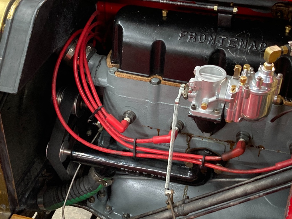

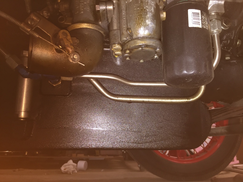

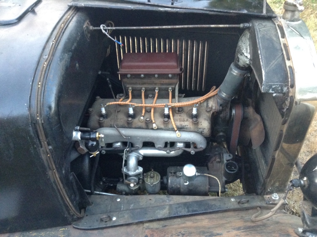

Here is a 4V I ran on my ol ‘27 roadster. It ran kinda funky at first, but after building a new barrel and boring the housing to seal up the vacuum leaks at idle, and figuring out that the idle screw and air bleeds were installed in the wrong screw holes, it ran like a top! Basically stock T engine
SR-C-U on my noticeably modified T speedster motor... for now!
S-B-D on my dads Fronty powered touring
And the S-AA-U going on my somewhat modified T touring
