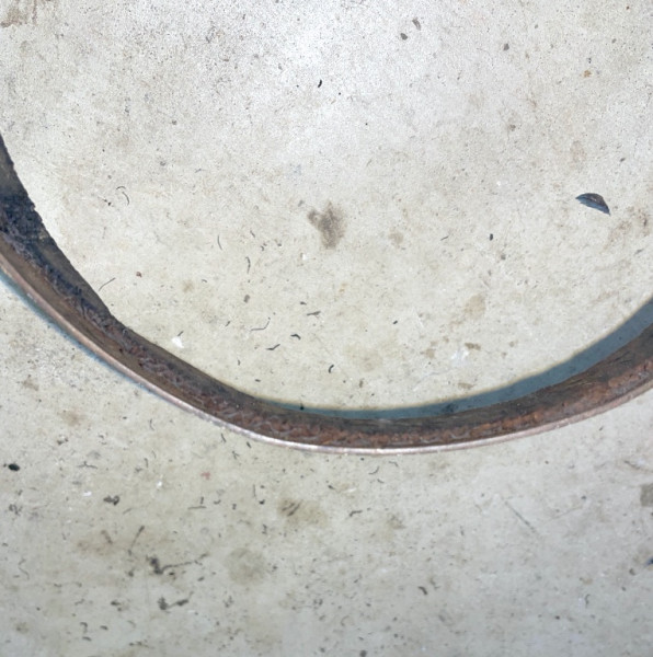

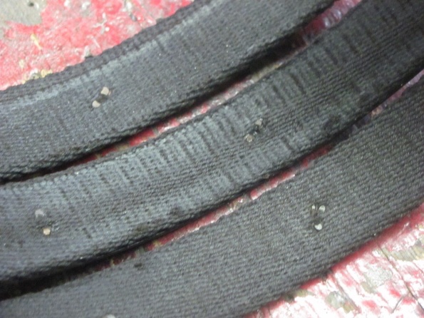

Seems more practical to stay with the factory way. More lining length is more friction contact, that is the purpose.
Couldn't find ref. in my 1922 Dykes to doing this to woven linings, cutting the base circle away. When you remove old woven linings the bottom part is worn too from circular contact.
IMG_1731 (595x446).jpg (134.38 KiB) Viewed 2796 times
IMO, leave the woven lining the full length.

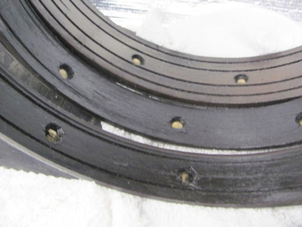

Now this segmenting likely was suitable for hard linings, like wood. One mfg. choose to make the wood linings in segments, useful to get oil to those large gaps, as the wood doesn't hold as much oil as woven linings, and useful to keep from making a whole circle of wood, easier to make.
IMG_6615 (500x375).jpg (93.38 KiB) Viewed 2796 times
With the full circle wood linings, the ones you can purchase today, you can see that the bottom of the circle is worn thin, showing the need for full wrapping of a lining around the drum.
