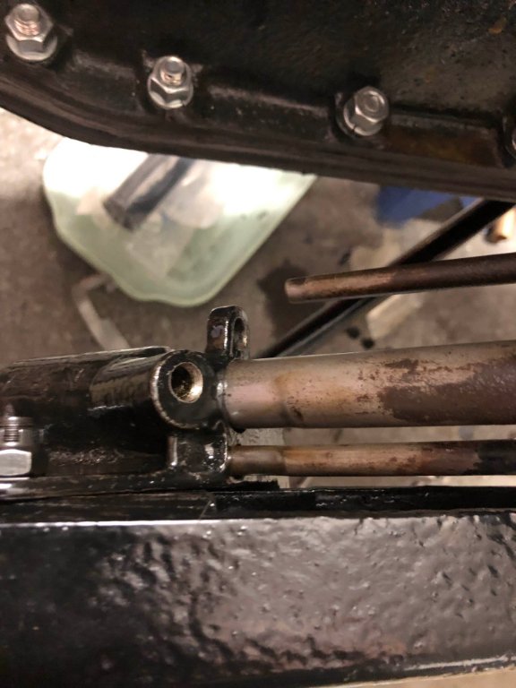

To this end I have installed a 1925 high metal firewall, with the correct square hole mounting brackets, and when I installed the steering column the rods are approximately 3/4" too short to work - using the standard 1926 steering box.
See how the one rod is about 3/4" too short? (The other is too, it doesn't protrude from the steering box)
So do I need to use an earlier steering box? Will that alleviate this issue or is there something else I am missing??

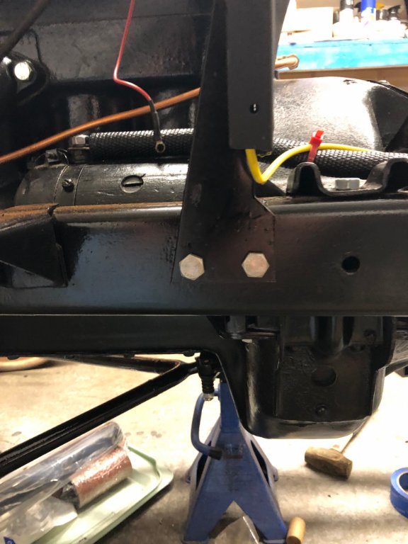

Here's a shot of the firewall brackets I am using, they do have the square holes, and are attached to the firewall using carriage bolts.
Any thoughts?

You have a 26/27 lower bracket, a 26/27 steering column and a 1925 firewall? That doesn't work. The 26/27 lower bracket moves the steering column closer to the frame, but the '25 firewall does not. The "bolt-up" of the 26/27 column to the '25 firewall may also be a little funky. It's also still unclear to me what year frame you have, (kinda looks like 26/27). Does the front crossmember have the "wings" at each end where the fender brackets attach? Hard to tell from the photos, but I'm wondering if you don't also have firewall brackets meant for a wood firewall.ModelTGal wrote: ↑Mon Jun 13, 2022 2:16 pmHi George!

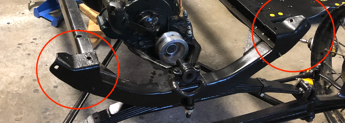

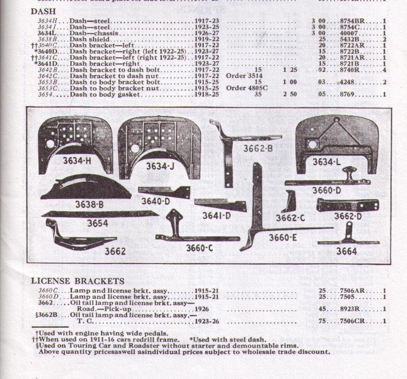

Sorry to be dense, but what "wings" are we talking about?? These things?

Yes, those are the wings. Your '25 firewall will be of no use to you with a 26/27 body.ModelTGal wrote: ↑Mon Jun 13, 2022 3:43 pmHi Jerry!

The wood blocks really are not that hard to install. Put the vertical bolts in first, with the nuts on top, then drive the blocks down the frame rail until the side holes line up.

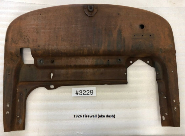

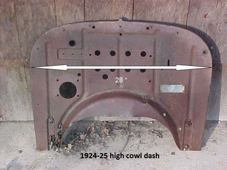

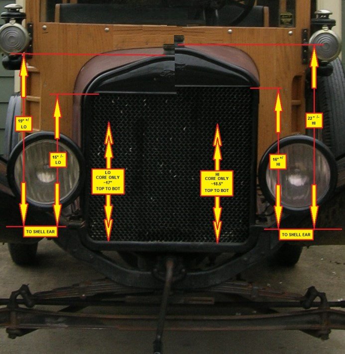

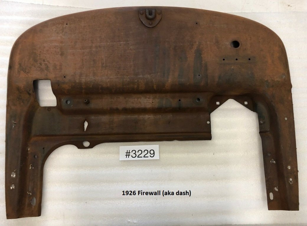

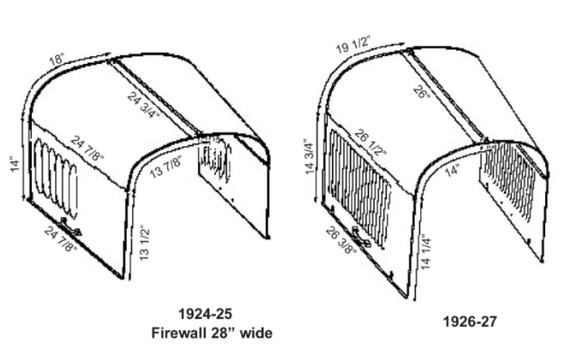

There are significant size differences between a '25 & '26 firewall (aka dash). So this propagates a question about what year your roadster body is. The difference is size and shape would be noticeable. Titles & engine numbers don't always agree with the actual car.
So check your hood dimensions as well. Think its time for you to show some pictures so members can determine what your working with. This picture is looking at the firewall from the front of the car This picture is looking at the firewall from the rear of the car --
