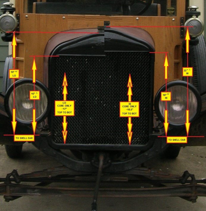

There are significant size differences between a '25 & '26 firewall (aka dash). So this propagates a question about what year your roadster body is. The difference is size and shape would be noticeable. Titles & engine numbers don't always agree with the actual car.
So check your hood dimensions as well. Think its time for you to show some pictures so members can determine what your working with. This picture is looking at the firewall from the front of the car This picture is looking at the firewall from the rear of the car --

Radiator
Hoods --
Radiator
