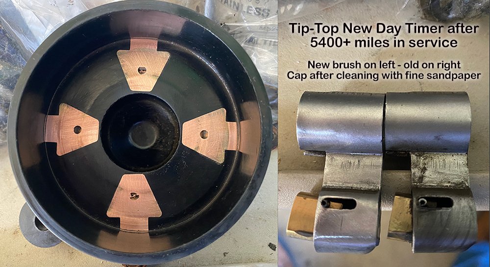

I have a New Day timer made by Tip-Top Timers of Spokane Valley, Washington. In the past two and a half years I've put 5400 + miles on the cap and brush. I thought it might be helpful to others to show what the timer cap and brush looks like after that use.
Wear on the cap contacts is minimal and although the brush is slightly worn, there is no reason I can't put it back on the car. In my opinion, Tip-Top makes a quality unit that gives good service. In addition to the New Day I believe they make Anderson Timers but I have no experience with them.

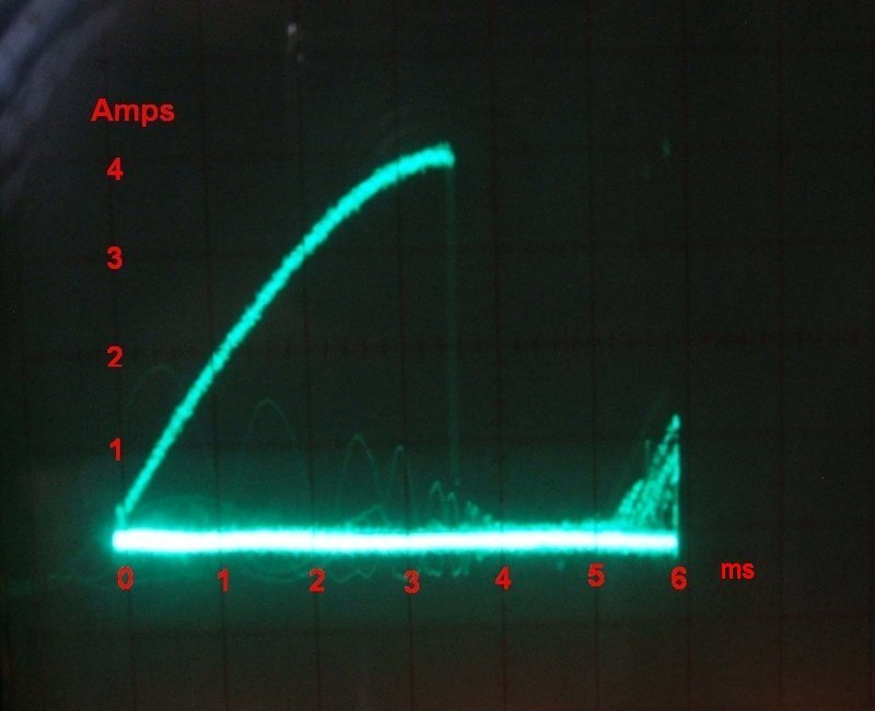

On the contrary, because the coil is an inductive load, current is at its minimum when the timer contacts close. A correctly adjusted coil takes about 3.5ms to reach its peak current at 6V, and for 12V the time taken is about 2ms. The timer contacts have been closed for some time therefore, before maximum current is reached, and thus arcing is minimised. The above waveform shows coil current vs. time when fed from a 6V supply and a simulated timer. 0ms is when the timer makes contact, and 6ms is when the timer opens. The coil has been adjusted to fire at 3.5ms since this is when the core reaches saturation. (By adjusting all four coils to take an equal amount of time to fire ensures smooth running, and is the principle behind the ECCT).
And before anyone says the coil under test is improperly adjusted because of the 4A current, that is the peak current - not the average as shown on an ammeter, which will be closer to 1.3A.
And finally, as someone who has run mechanical timers on 6V battery for about 40,000km, electrical wear has never been a problem.

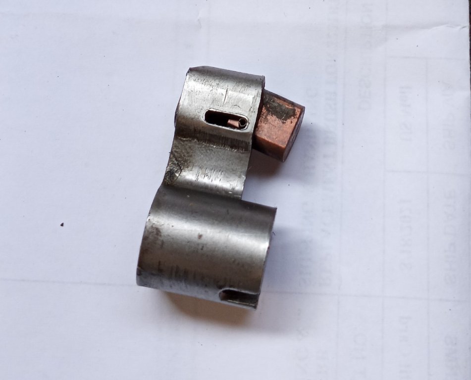

Tim Wrenn has said a number of times that he had a problem with a new Newday timer. He has repeatedly posted pictures that I presume are from this timer. Here is the picture that Tim Wrenn has repeatedly posted. I would like to point out that this in NOT a brush from the timers made by Tip Top Timers.
- Posts: 7411
Re: Report on Tip-Top Timer
If you compare the last photo with the first, it's obviously not the same brush.
- Posts: 3743
- Last Name: Wrenn
Tom_Carnegie wrote: ↑Mon Jul 25, 2022 1:01 amTim Wrenn has said a number of times that he had a problem with a new Newday timer. He has repeatedly posted pictures that I presume are from this timer. Here is the picture that Tim Wrenn has repeatedly posted. I would like to point out that this in NOT a brush from the timers made by Tip Top Timers.
