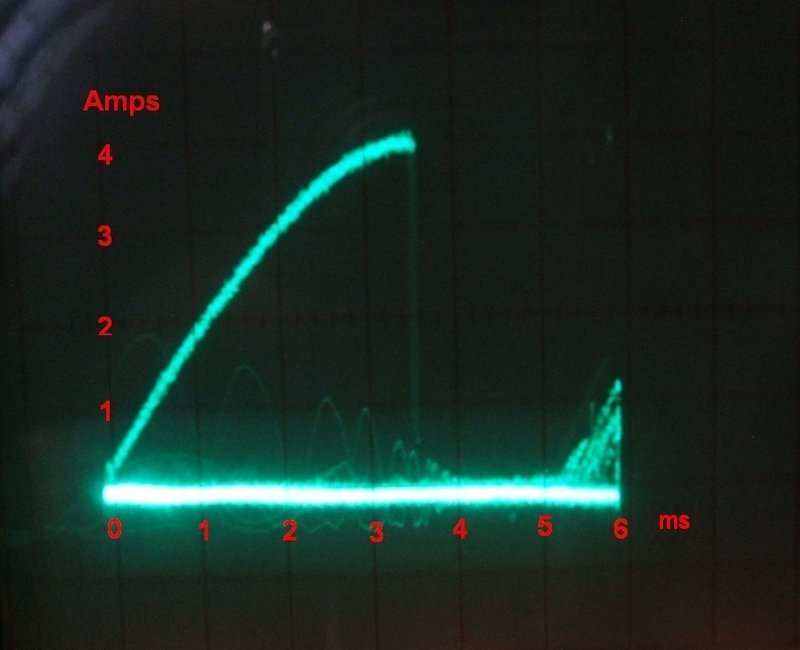

TXGOAT2 wrote:
Sun Jun 19, 2022 12:57 pm
When running on battery, full battery current is available to the coil primary as soon as the timer contact closes. The coil will draw its maximum current at that instant, when the timer contact first closes and before the coil points open.
On the contrary, because the coil is an inductive load, current is at its minimum when the timer contacts close. A correctly adjusted coil takes about 3.5ms to reach its peak current at 6V, and for 12V the time taken is about 2ms. The timer contacts have been closed for some time therefore, before maximum current is reached, and thus arcing is minimised.
The above waveform shows coil current vs. time when fed from a 6V supply and a simulated timer. 0ms is when the timer makes contact, and 6ms is when the timer opens. The coil has been adjusted to fire at 3.5ms since this is when the core reaches saturation. (By adjusting all four coils to take an equal amount of time to fire ensures smooth running, and is the principle behind the ECCT).
And before anyone says the coil under test is improperly adjusted because of the 4A current, that is the peak current - not the average as shown on an ammeter, which will be closer to 1.3A.
And finally, as someone who has run mechanical timers on 6V battery for about 40,000km, electrical wear has never been a problem.

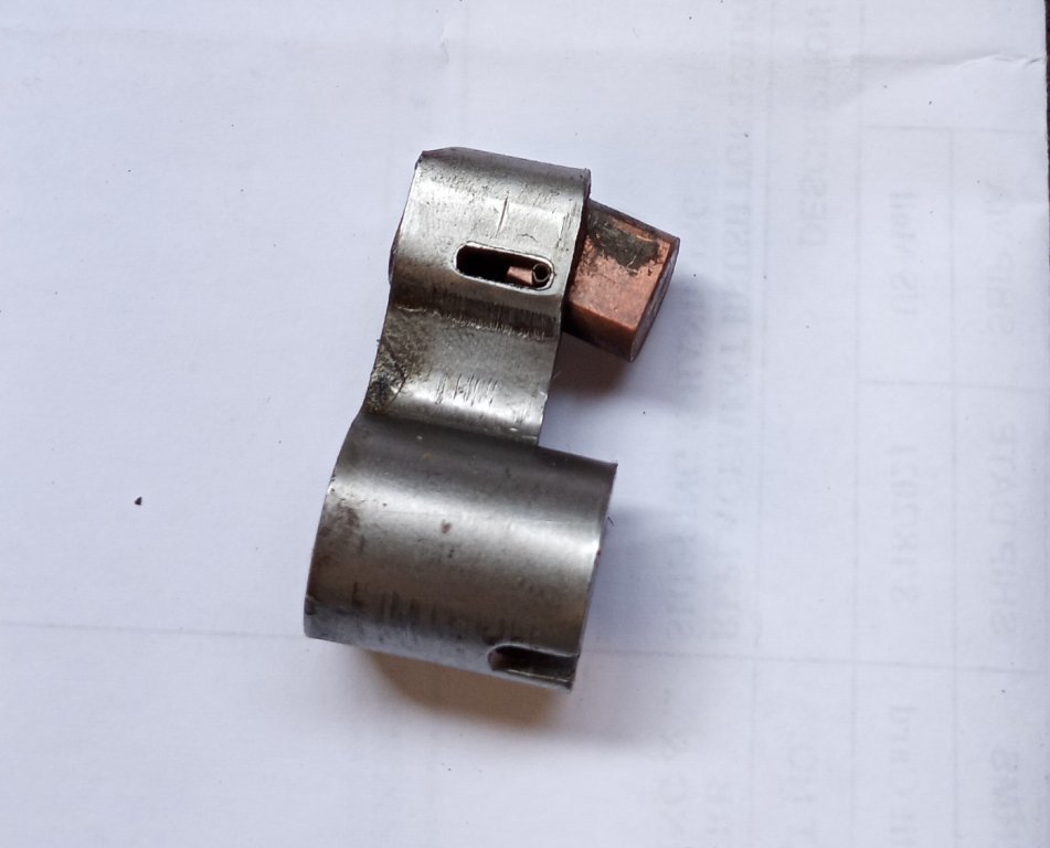

Tim Wrenn has said a number of times that he had a problem with a new Newday timer. He has repeatedly posted pictures that I presume are from this timer. Here is the picture that Tim Wrenn has repeatedly posted. I would like to point out that this in NOT a brush from the timers made by Tip Top Timers.
Posts: 7411
Re: Report on Tip-Top Timer
Post by Steve Jelf » Mon Jul 25, 2022 1:48 am
If you compare the last photo with the first, it's obviously not the same brush.

Tom_Carnegie wrote:
Mon Jul 25, 2022 1:01 am
Tom, that's good to know! That can be a problem in this hobby, locating the "right thing" from the right folks! What I bought was from a "regular vendor". Apparently someone's figured out a way to make a good timer even better then. That's good with the lack of the TW timer availability. Thanks for the update.
