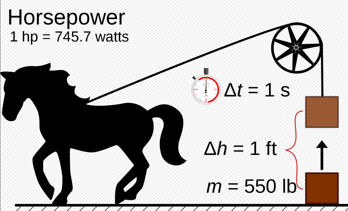

Post by mbowen » Thu Jun 23, 2022 11:21 pm
“Power” is the ability to exert a given force over a given distance in a given amount of time. One horsepower is defined as being able to exert a force of 550 pounds over a distance of 1 foot in one second (or any combination pounds exerted times feet moved divided by seconds it took to move that distance = 550). I have a strong feeling that one borax mule was more capable than that.

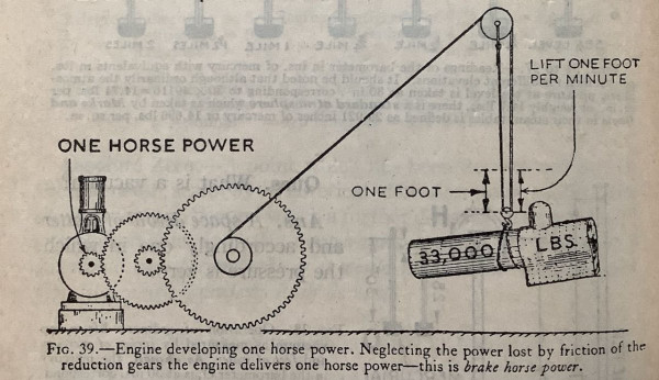

Post by BobD » Fri Jun 24, 2022 12:03 am

Post by TXGOAT2 » Fri Jun 24, 2022 10:52 am
"Horsepower" as applied to rating engine power is a concept, not a specific physical force. Horsepower is a mathematical formula that relates the force applied to a load over a distance that load is moved by the force in a particular span of time. Some early stationary steam engines would run at 30 RPM or less, but they provided thousands of foot pounds of torque and one engine could operate a large factory with scores of machines and hundreds of feet of line shafting and thousands of feet of belting. No elephant can outrun a good racehorse, but most any elephant can outpull a race horse. The elephant has lots more power, but less speed than the race horse. The race horse has less power and more speed. The elephant can uproot a large tree, unaided. The horse cannot. A horse can be connected to a winch, and uproot the same tree as the elephant.
