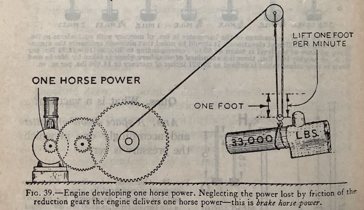

One horsepower is not the same as the energy applied by one horse. James Watt calculated that one average horse could apply 180 lbs of force sustained. The reality is that one horse can apply many times that amount of force for a shorter period of time. I seriously doubt that a Model T could apply the same amount of pulling force as 20 horses/mules for a sustained period of time.

"Horsepower" as applied to rating engine power is a concept, not a specific physical force. Horsepower is a mathematical formula that relates the force applied to a load over a distance that load is moved by the force in a particular span of time. Some early stationary steam engines would run at 30 RPM or less, but they provided thousands of foot pounds of torque and one engine could operate a large factory with scores of machines and hundreds of feet of line shafting and thousands of feet of belting. No elephant can outrun a good racehorse, but most any elephant can outpull a race horse. The elephant has lots more power, but less speed than the race horse. The race horse has less power and more speed. The elephant can uproot a large tree, unaided. The horse cannot. A horse can be connected to a winch, and uproot the same tree as the elephant.

Measured on a dynamometer originally designed for the steam engine or the electric dynamometer.
