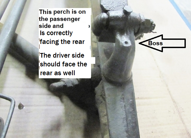

The only thing I'm going out to check now is the 5 1/2 deg measurement on the perches.....

The 5 1/2 degree caster angle is important, and both sides should be close to the same. The spring perches must be tight in the axle and the radius rod connections to the axle must be tight. 3" of play at the steering wheel is way too much. I'd also check the spring to frame clamps and look over the rear suspension and engine mounts. As light as your car is, about 28 PSI in the balloon tires is probably plenty. A 17" steering wheel may help stability. Another thing to consider is the possibility of mis-matched steering parts. There are some drag links and tie rods that will fit in some steering assemblies, but they won't work right.

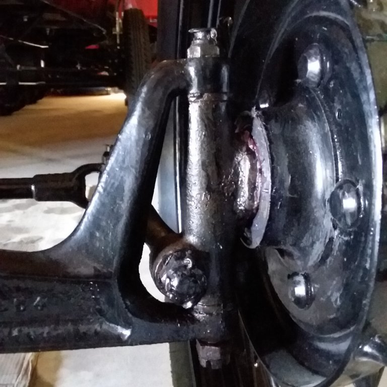

Pitch Measurement:
3/16 drivers side
2/16 passenger side
Left hand drive car
Norm, front and rear springs have centering bolts in place.
3/16 drivers side
2/16 passenger side
Left hand drive car

Professor Fate
Topic author - Posts: 773
- Last Name: S
- Location: Taxachusetts
Re: Skiddish Steering
Norm, pitman is at 6 o'clock almost perfectly straight up and down. It's maybe 5 degrees past true 6 o'clock headed towards 7 o'clock. Just a smidge.

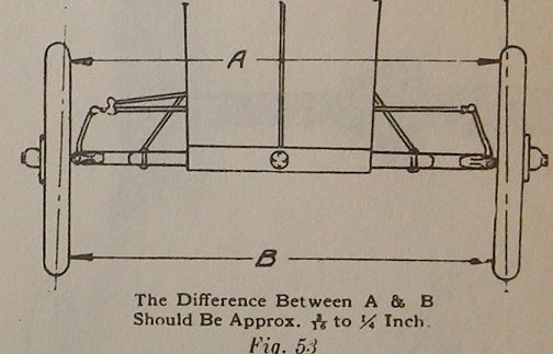

As TXGOAT2 said 3" play is to much. I would have someone in the car moving the steering wheel within the 3" play while I was underneath the car to see what was moving and what was not. If you go over a bump and the car the wheels become unweighted and when they come down they will take up the slack.
While you measured camber but did you measure toe-in?
Since excessive toe means that each tire is pointed in a direction other than straight ahead, when the vehicle encounters a puddle that causes only one tire to lose some of its grip, the other tire's toe setting will push (excessive toe-in) or pull (excessive toe-out) the vehicle to the side...
http://www.mtfca.com/discus/messages/70 ... 1493525369

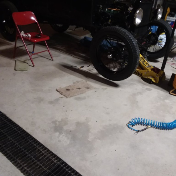

Off to the garage......

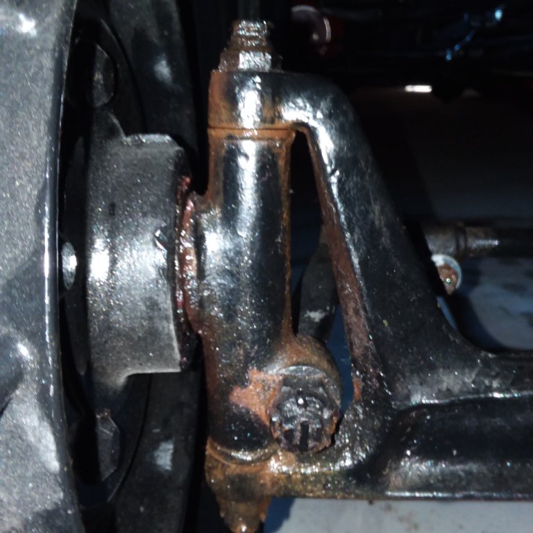

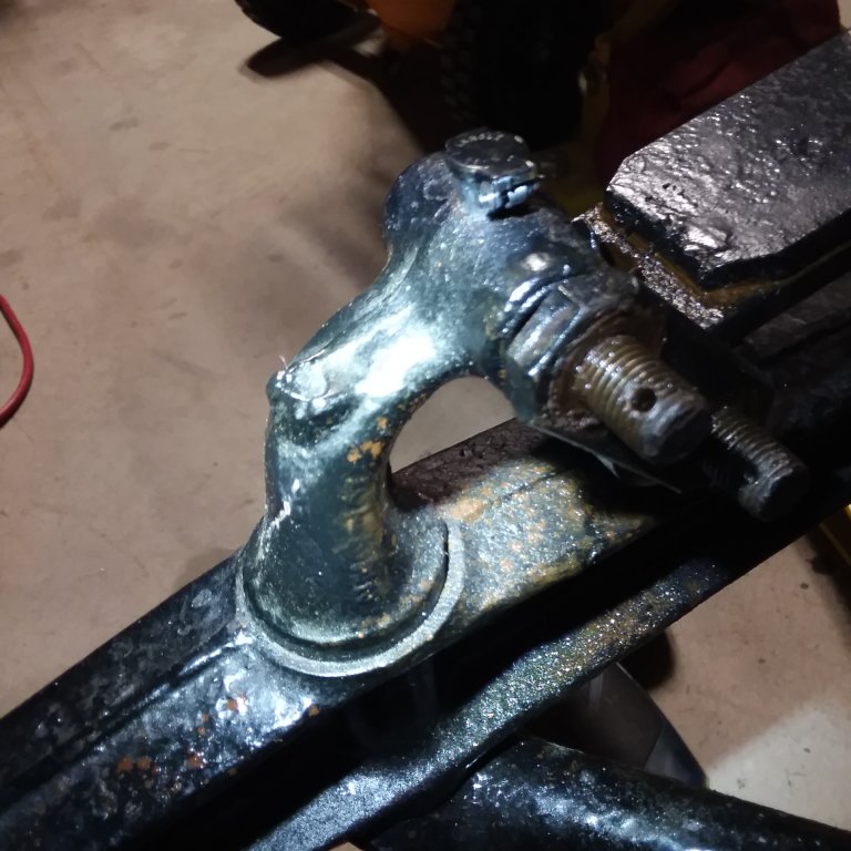

Is it possible that the king bolts are too tight? Maybe when hitting bumps it unloads the weight and its free to make a quick change in direction. I had this after rebushing my axle,
Professor Fate
- Last Name: S

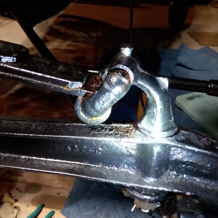

I know my drivers side spindle bolt is on the tight side. I tried to loosen it but it would not move. It's gonna take some heat and a pipe to get it loose.

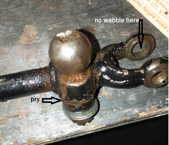

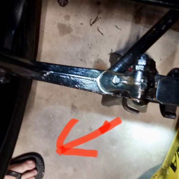

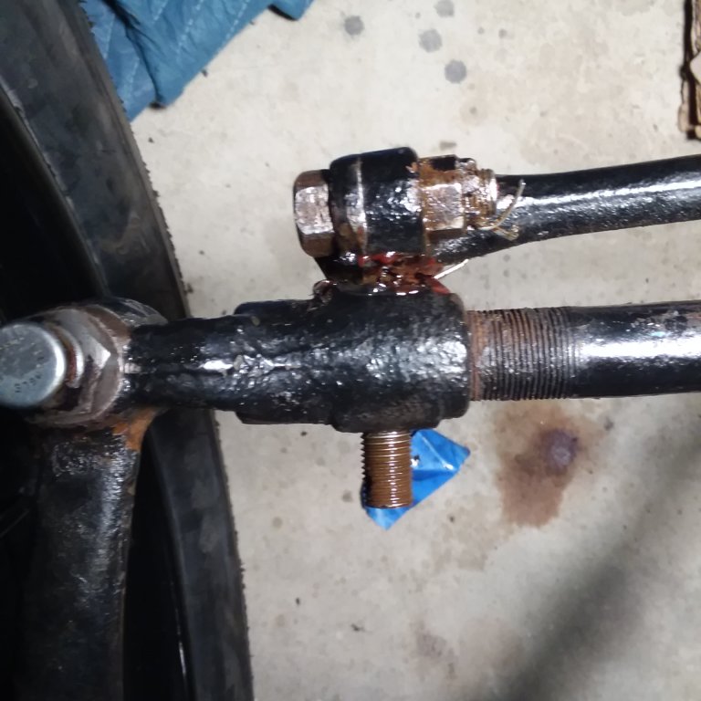

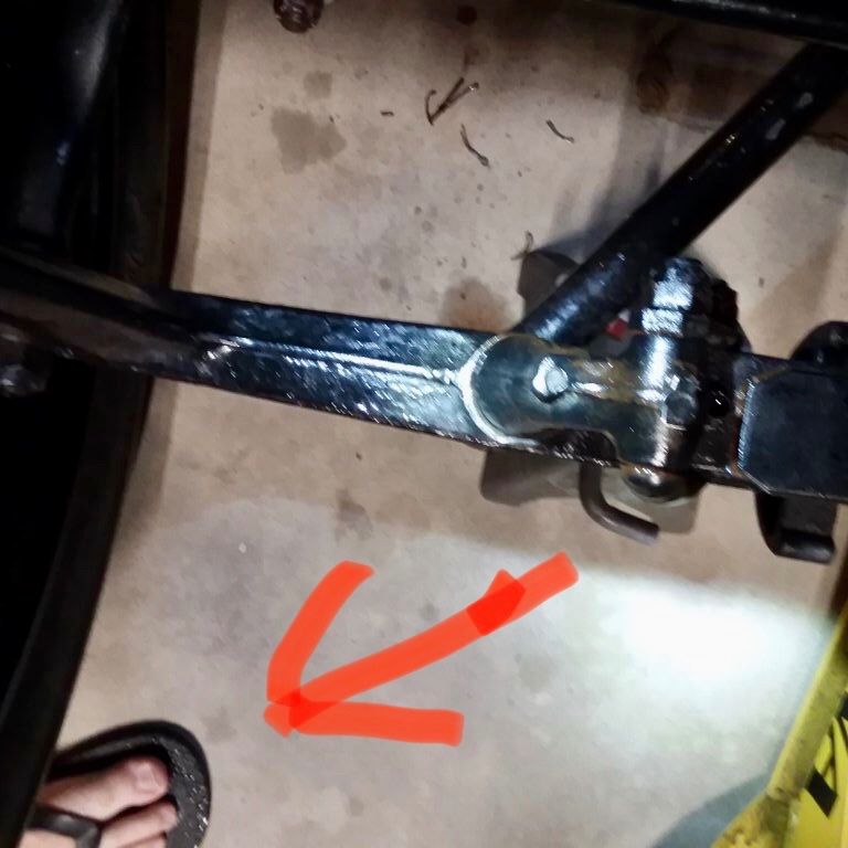

Before you fire up that oxy acetylene wrench, I’d like to see you address that horrendous 3” steering wheel travel I axed about. In fact, don’t apply heat to the spindle bolt nut at all! I’m afraid that’d make the bottom brass bushing brittle

You need to determine where the 3" of play is. Have someone turn the steering wheel while you watch all the action. Start by holding the pitman arm while the steering wheel is turned. This will tell you which direction to look for the play.

To loosen the spindle bolt you need to go to the bottom of the spindle and take out the cotter pin and loosen the nut. Then you should be able to adjust the spindle bolt by turning counter clockwise at the top. You might need a long wrench with about 2' long handle. Then when you get the bolt adjusted as you want it, you tighten down the nut at the bottom. If it becomes too tight, repeat the above but leave the bolt just a little bit looser before you tighten it at the bottom. The nut at the bottom is a lock nut but the thred at the bottom of the spindle is for adjustment Note, sometimes the thread in the spindle is worn out. If it is, you will need to install a helicoil.

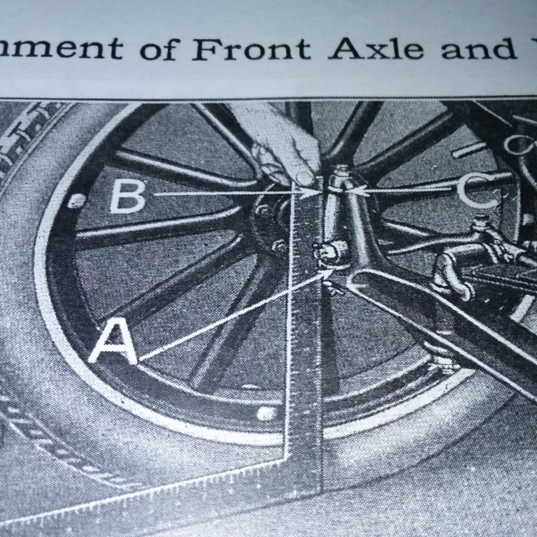

CASTOR NUMB3RS
Remeasured Castor per manual using metal square.
Passenger side 1/8
Drivers side. 5/16
Passenger side 1/8
Drivers side. 5/16

- Posts: 5273
Re: CASTOR NUMB3RS
Squared to what? an out of true tire or rim?Professor Fate wrote: ↑Mon Jun 27, 2022 12:15 pmRemeasured Castor per manual using metal square.
Passenger side 1/8
Drivers side. 5/16
This is another area where possible out of true parts are being relied on for critical specs.
See the correct method for checking toe in that filters out tire & rim wobble as an example.
- Posts: 8665
"Passenger side 1/8
Drivers side. 5/16" ...... Your car will handle better with 5/16" on both sides. But it will never handle properly with anywhere near 3" of free play at the steering wheel. It would be best to get someone with some experience to do any bending on the axle, if possible. If I were you, I would correct the slack in the system first, then see how the car behaves on the road. It will probably have some tendency to wander or pull to one side. Correcting the caster angle should improve handling. It may also improve the camber error.

Re: CASTOR NUMB3RS
"Squared to what? an out of true tire or rim?
See the correct method for checking toe in that filters out tire & rim wobble as an example."
I measured Castor as per the manual as pictured below. Is it castor your referencing or toe? I'm unclear... sorry

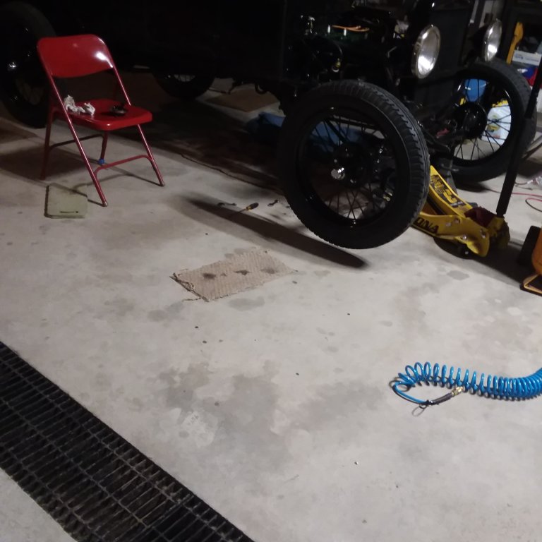

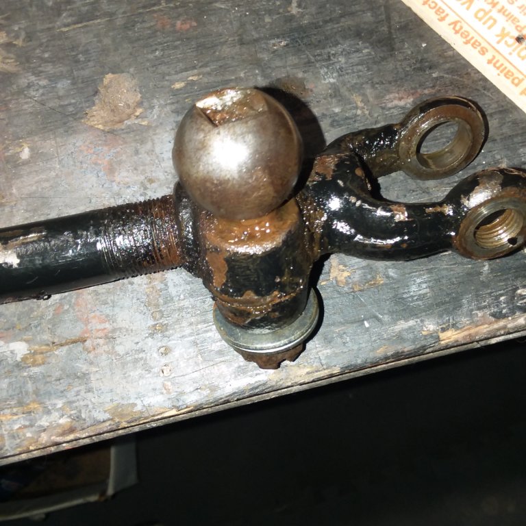

I've pulled the whole steering column.
New steering bracket bushing, pitman key, and install new gears up top tomorrow.
I found 1/8+ of play at the end of the steering shaft. Taking all advice seriously. Going thru it to reduce play in wheel, and reduce the slop I have.

Good prioritization Prof. The same thing happened to me. When my T got too close to the centerline I found myself ‘nudging’ it back to the right. With a great deal of steering wheel travel. Then, when I was afixin’ to drop the RF wheel off the pavement I ‘nudged’ it back to the left. After arriving home (with a white knuckle drive) I unscrewed the steering gear case below the steering wheel and found one of the three planet gear pins real loose. That necessitated a trip to my parts department to locate a good, correct steering column....
- Posts: 4481
Re: CASTOR NUMB3RS
Yes, he confused castEr with toe-in. Your checking method is fine, as long as the piece of pavement you're doing your checking on is dead flat. If it is, you should not have different readings from right to left. Might be better to use a plumb bob and bring the string close to each end of the axle. Take your measurement from the string to the axle, similar to how you meaured using the square.Professor Fate wrote: ↑Mon Jun 27, 2022 3:09 pm"Squared to what? an out of true tire or rim?

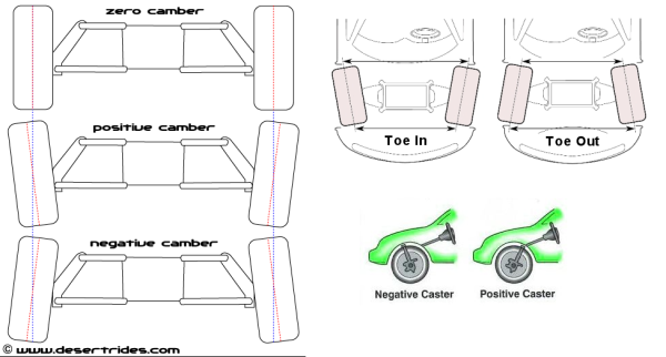

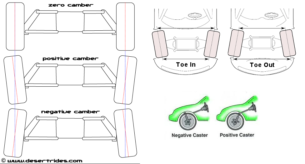

definition diagrams
- Posts: 5273
Re: CASTOR NUMB3RS
You are right, I was thinking you were looking @ camber.Jerry VanOoteghem wrote: ↑Mon Jun 27, 2022 4:23 pmYes, he confused castEr with toe-in. Your checking method is fine, as long as the piece of pavement you're doing your checking on is dead flat. If it is, you should not have different readings from right to left. Might be better to use a plumb bob and bring the string close to each end of the axle. Take your measurement from the string to the axle, similar to how you meaured using the square.Professor Fate wrote: ↑Mon Jun 27, 2022 3:09 pm"Squared to what? an out of true tire or rim?
Caster. (the rake of the axle) 6 degrees. a pencil width aprox 3/8". For hi speed ( above 60) Add more - 1/2- 5/8" This makes for a real steady steering, but you do loose some steering ease in the turns.

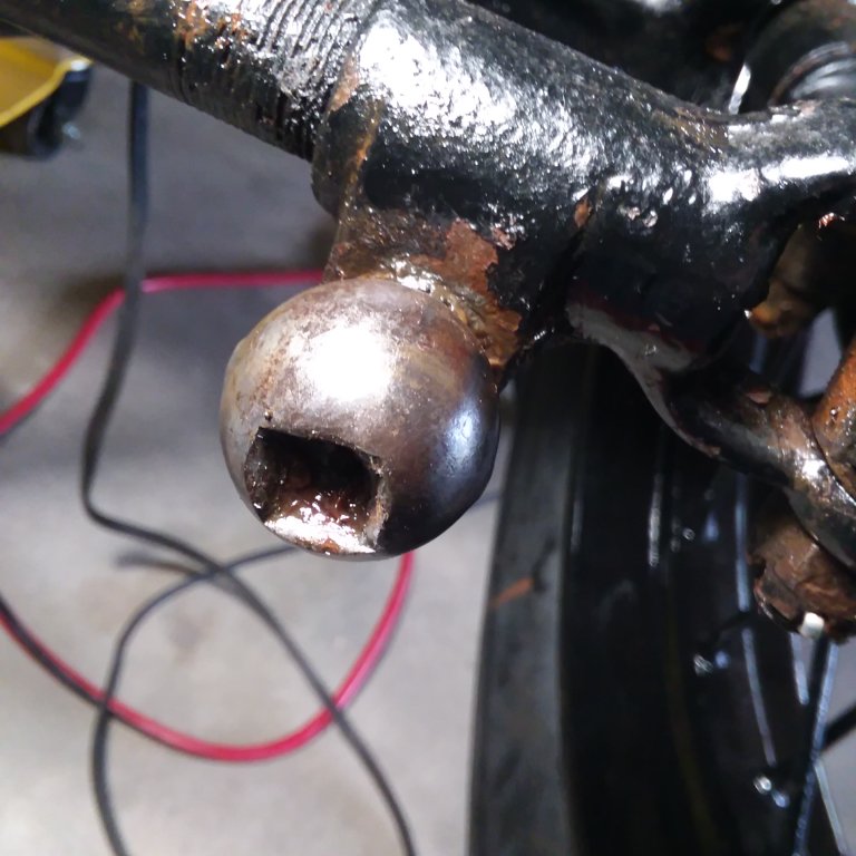

Removing Ball
Is there a tool that goes in the square pit in the ball to unscrew it?
________________
**FATE**
**FATE**
- Posts: 5273
It doesnt unscrew. Its a taper fit.
Put the nut back on to protect the thread & tap it with a brass hammer.

I just realized/remembered that my garage floor is pitched gently to the center drain. Each side is pitched to the middle.
Maybe that's why I got two different measurements for castor, as the car is parked across the pitch. Drivers side is higher than passenger....

Very few concrete floors are flat and level, in my experience.
Professor Fate
- Last Name: S
Agreed! But mine has an intended pitch to center for water drainage. I have to set the down hill jackstand a notch higher for level.
I'm turning the car 90 degrees tomorrow to get the sides on the same plane, and I'll straddle the drain and level the car as such.
That's the best I can do.
Drain grate is dark strip at lower left of pic.

Good question. Don't think this was ever verified
Boss to the back even for Pancake Hasslers but Beehive style has different requirements

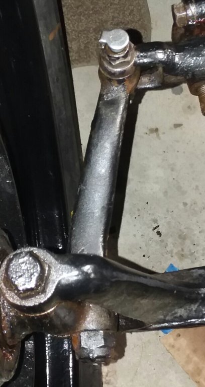

Spring perches:
My axle has month day year on the casting. Car is '26. Axle is '22. Mix and match.
________________
**FATE**
**FATE**
- Posts: 6592
The driver side picture confirms that side is correct but its hard to tell about the passenger side. The picture makes it look like its in the middle.Professor Fate wrote: ↑Mon Jun 27, 2022 11:23 pmSpring perches:
Front Axle 1926-1927
Similar to 1925 but spindles are higher on the spindle body to lower the chassis. New steering drag link which is about an inch shorter than the previous type. In late 1926 the axle was modified and now had a “droop” or “sag” between the perches.
The late 1926 and 1927 design has the middle of the top of the axle is about 1/2” lower, and presents a definite distinguishable curve between the perches, than on older designs. Don't see any other difference noted. So I doubt if the axle beam is an issue
So to better understand "Mix & match" - is the only difference us the axle being '22 and all the rest (spindles, arms, tie rod, drag link and pitman arm) all '26?

I'm unfamiliar with components. Front end is how it came to me. I've made no changes.

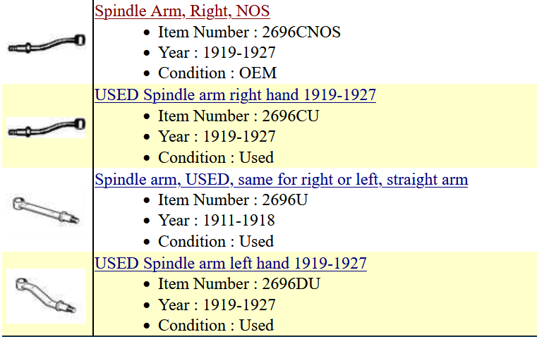

Another member having similar issues https://mtfca.com/phpBB3/viewtopic.php?f=2&t=29982Professor Fate wrote: ↑Tue Jun 28, 2022 12:40 pmI'm unfamiliar with components. Front end is how it came to me. I've made no changes.
Parts but your pictures help to
Front spring, eight leaf, low arch, “clip end” spring. count what you see then there may be one inside the crossmember
spindles - the '26 have a gap & flat sides Spindle arms

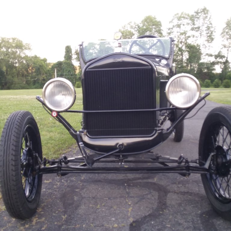

Spindle pics from front of car looking rearward.
________________
**FATE**
**FATE**
- Posts: 4481
That has the look of something needing rebuilding. The bottom picture has me imagining a wheel bearing loaded with rust.

Bearings all new and packed with grease. A hardware refresh and new cotters will go a long way.

- Posts: 4481
Okay. That's good. Photos can play tricks.Professor Fate wrote: ↑Tue Jun 28, 2022 6:26 pmBearings all new and packed with grease. A hardware refresh and new cotters will go a long way.
Bryant
- Posts: 1232
- First Name: Bryant
- Last Name: Shafer
In this picture there appears to be a little to much “toe” in
sorry Iam an idiot .. I will behave from here on out I swear
RVA23T
- Posts: 853
- Last Name: C
The Quick way to adjust that kind of toe in is you put your right foot in, you put your right foot out, you put your right foot in and you shake it all about, you do the hokie pokie ............
You promised to behave but I didn't yet!

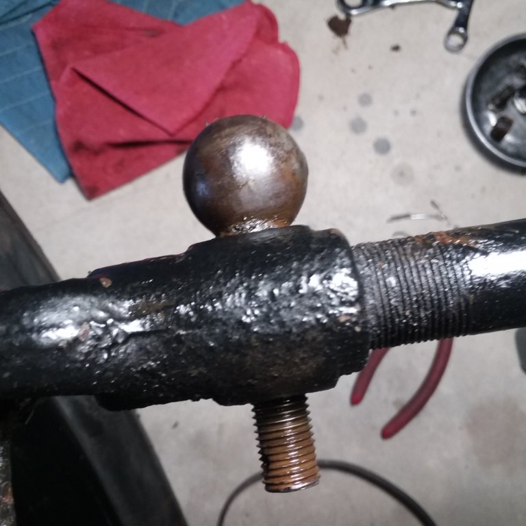

Hi!

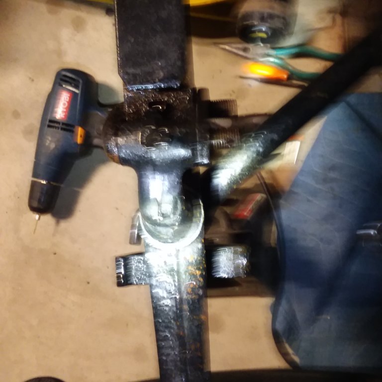

Trying to get my tie rod end to crank out 1 turn to get my toe setting closer.
Only problem is the clevis won't move. I just don't want to crush the hollow tie rod. Any secrets/hints?
I have it off the car.

- Posts: 5273
Strip the paint on the threads especially. Wire wheel. Kroil for a day & try again. Clamp in a soft jawed vise & turn yoke with a bar or pipe. Dont force it. If no joy, heat the yoke body over the threads. Let cool & re Kroil. I am generally against the blue wrench, but, in this situation, with stuck threads its warranted.Professor Fate wrote: ↑Wed Jun 29, 2022 2:32 pmHi!

Got it free. All set.
Had to loosen ball clamp to let it turn...... learned something new

- Posts: 6592
You can pry the clevis a little to help turn it. Loosen it a bit before cleaning out the threads needed to tighten it as indicated above. Also check for tightness of the tie rod bolt in the unthreaded hole of the clevis - it should be snug when almost fully thread (do this without the spindle arm)

- Posts: 6592
Toe-in vs Toe-out - These descriptions are applicable for Rear Wheel drive cars. (FWD drive cars are just the opposite)
Positive toe, or toe in, is the front of the wheel pointing towards the centreline of the vehicle.
Toe-in produces understeer a condition where, while cornering, the front tires begin to slip first. Since the front tires are slipping and the rear tires have grip, the vehicle will turn less than if all tires had grip. While this sounds scary its actual gives the driver better control since the effect is controlled by use of the throttle - for driving just let off the gas and engine brake if necessary. Toe-in provides more stability at speed.
Negative toe, or toe out, is the front of the wheel pointing away from the centreline of the vehicle.
Toe-out produces oversteer a condition when a car turns more than the driver intends while he or she is applying a steady steering input. The visible results of oversteer can include the tail sliding out or a full spin. Oversteer occurs when the rear wheels lose traction before the fronts. This is what midget racers and tuner cars use to cause drifting around a corner that is to let the rear of the car come around a bit with the front wheels pointed in to the turn.

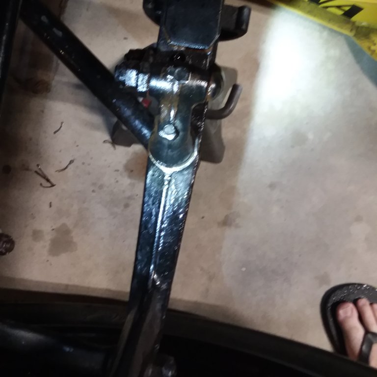

The toe of the car, not my foot as noted in a recent pic (lol!!!), has been set...... to 0.20 toe in. I have to finish putting it all back together yet. Test drive in the a.m. hopefully

I've been working on the front end.... found the ball on the tie rod end is still wiggling 5 degrees beyond center left and right, allowing for slop in the wheel. I can see it well because the nut end also wiggles, but the opposite way.
Do I need a new clevis and ball?
The testing was performed with the castle nut tightened on. Sorry it's missing in the pic. Wiggle is same whether tightened or no nut.

Tie rod balls with tapered shank are available at Snyder's Auto parts... Reproduction parts
- Posts: 4481
You need to take everything apart, clean off all the rust and crud, and inspect each piece for wear. The two washers shown behind the nut in your other photos tell me that something there is definitely worn out. Either way, you won't know what's all wrong till you get it all cleaned up and inspected.
- Posts: 7306
There are two types of those balls. Prior to the more common tapered fit style, there were some with a straight shank. Perhaps you have a mis-match of parts at the yoke. Either way, a replacement yoke may well be in order.
Professor Fate
- Last Name: S
The 2 washers i threw on to see if that killed the wiggle . It did not.
I'll be taking the tie rod off and removing that clevis end, and replacing with a new one along with a new ball.
Headed to Lang's Tuesday a.m. for parts.
Thanks as always. -D

How would this right side spindle arm come off the axle? After removing nut, does it tap out or thread out?
Thanks!
Thanks!
________________
**FATE**
**FATE**
- Posts: 6592
Taps outProfessor Fate wrote: ↑Sat Jul 02, 2022 3:14 pmHow would this right side spindle arm come off the axle? After removing nut, does it tap out or thread out?
Thanks!
- Posts: 7306
There is no taper to break, so it "taps"out. Good luck with that. They are not often removed in service, so can rust solidly in place Heat may be needed, a penetrant essential, protection of the thread against miss- placed tapping blows also essential. It can also be helpful if you can add a twisting bar through the tie rod bolt hole to introduce some twisting action to help break the rust.
When replacing the arm, wait until you have the tie rod connected before you tighten the nut on the end of the arm. The tie rod bolt will give you the correct orientation for the arm.
