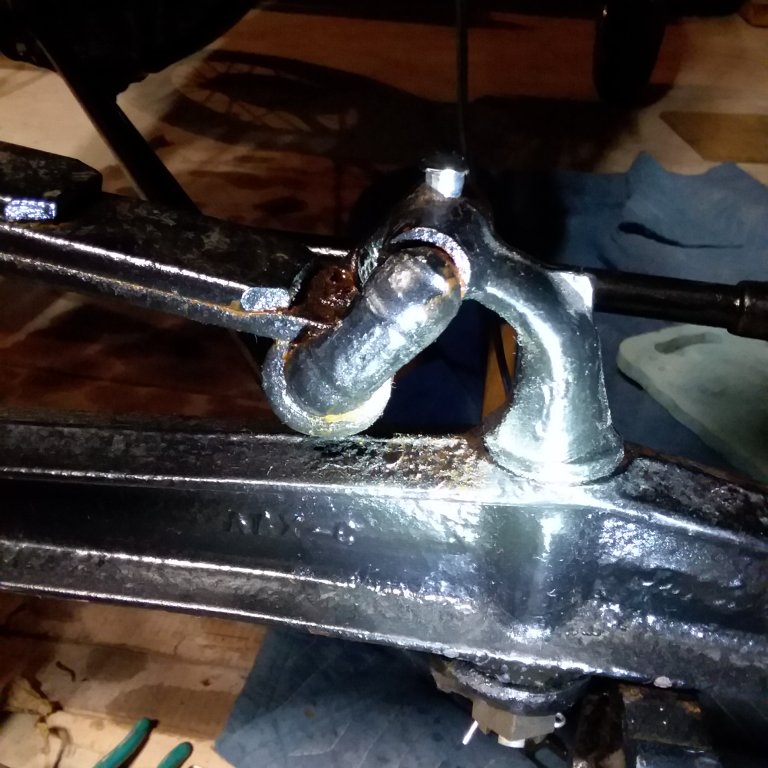

I know my drivers side spindle bolt is on the tight side. I tried to loosen it but it would not move. It's gonna take some heat and a pipe to get it loose.

Before you fire up that oxy acetylene wrench, I’d like to see you address that horrendous 3” steering wheel travel I axed about. In fact, don’t apply heat to the spindle bolt nut at all! I’m afraid that’d make the bottom brass bushing brittle 🇺🇦

To loosen the spindle bolt you need to go to the bottom of the spindle and take out the cotter pin and loosen the nut. Then you should be able to adjust the spindle bolt by turning counter clockwise at the top. You might need a long wrench with about 2' long handle. Then when you get the bolt adjusted as you want it, you tighten down the nut at the bottom. If it becomes too tight, repeat the above but leave the bolt just a little bit looser before you tighten it at the bottom. The nut at the bottom is a lock nut but the thred at the bottom of the spindle is for adjustment Note, sometimes the thread in the spindle is worn out. If it is, you will need to install a helicoil.

Posts: 7306
Re: Skiddish Steering
Post by Allan » Wed Jun 29, 2022 8:49 pm
Dan, your tie rod end looks to be considerably worn where it rests on top of the steering arm. This will allow it to rattle up and down in service. When I rebuild a front end, I dress the eyes on the end so they are flat. This will open up the gap between them, and you don't want to close that gap by crushing the yokes together. Instead, I use a worn spindle bush to make new tie rod bushes. They are the correct OD, and I open the ID to suit the pins. The flange on the bush is then worked down to closely fit between the end yokes. The bush is then fitted with the flange on the top of the spindle arm, where it makes a wear surface for the weight of the tie rod, at the same time taking out all the rattle.
Hope this helps,
Allan from down under

I've been working on the front end.... found the ball on the tie rod end is still wiggling 5 degrees beyond center left and right, allowing for slop in the wheel. I can see it well because the nut end also wiggles, but the opposite way.
Do I need a new clevis and ball?
The testing was performed with the castle nut tightened on. Sorry it's missing in the pic. Wiggle is same whether tightened or no nut.

Tie rod balls with tapered shank are available at Snyder's Auto parts... Reproduction parts
Posts: 4485
Post by Jerry VanOoteghem » Fri Jul 01, 2022 4:06 pm
You need to take everything apart, clean off all the rust and crud, and inspect each piece for wear. The two washers shown behind the nut in your other photos tell me that something there is definitely worn out. Either way, you won't know what's all wrong till you get it all cleaned up and inspected.
Posts: 7306
Post by Allan » Fri Jul 01, 2022 7:04 pm
There are two types of those balls. Prior to the more common tapered fit style, there were some with a straight shank. Perhaps you have a mis-match of parts at the yoke. Either way, a replacement yoke may well be in order.

The 2 washers i threw on to see if that killed the wiggle . It did not.
I'll be taking the tie rod off and removing that clevis end, and replacing with a new one along with a new ball.
Headed to Lang's Tuesday a.m. for parts.
Thanks as always. -D
