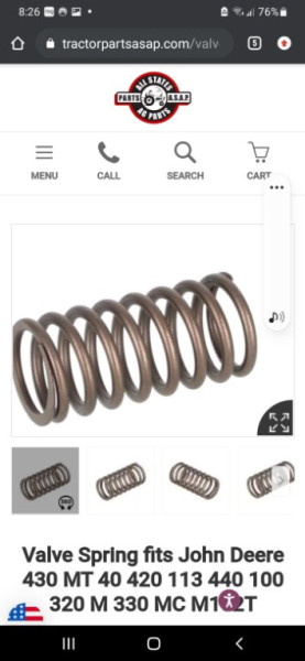

Actually, it is the newer manufacture spring Steve mentioned above.

This should help with the spring Mark posted above:
https://www.tractorpartsasap.com/valve- ... 28580.html

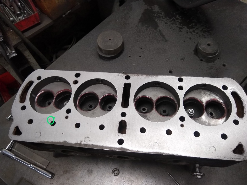

An update on the head. I just got this photo from the shop showing the progress. Half of one valve seat needed to be welded (you can tell which one on the picture from the polishing/grinding marks. They took a little more off the deck than is shown in this picture (a total of 10/1000).
The goal was to do as little to it as possible, consistent with good running. This was done in order to leave options open for future work if needed. We used the John Deere valve springs recommended, but are a little smaller in diameter than the stock ones. They are a useable spring pressure, running between 50 and 52 pounds.

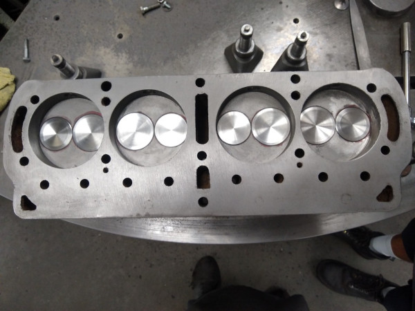

A better shot with the deck done and the valves in. Can’t wait to get it back.
