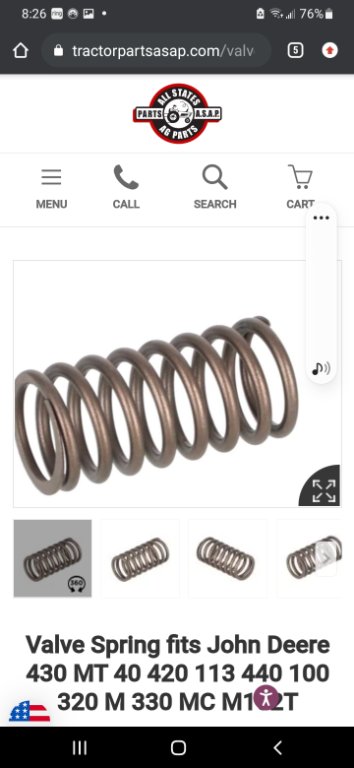

Actually, it is the newer manufacture spring Steve mentioned above.

Thanks, his link would not open for me.

Re: Rajo valve springs
This should help with the spring Mark posted above:
https://www.tractorpartsasap.com/valve- ... 28580.html

I talked to the shop today and they said the head looks good (no cracks). The valve seats are worn and they (tentatively) think installing seat inserts would be a good idea for longevity and to deal with modern gas. They also recommend using a valve with a thinner shaft to decrease weight. It might also be worth installing slightly smaller valves if this means that a more common valve could be used. It would also reduce valve weight. Anyone have experience with these issues in a RAJO?
This shop works on a lot of old stuff, but their primary business is racing. So, I have to keep them on the preservation rather than improvement track. He was flabbergasted that the recommended valve spring tension was so low. I had to point out it was roughly double what the stock spring pressure was in a T.

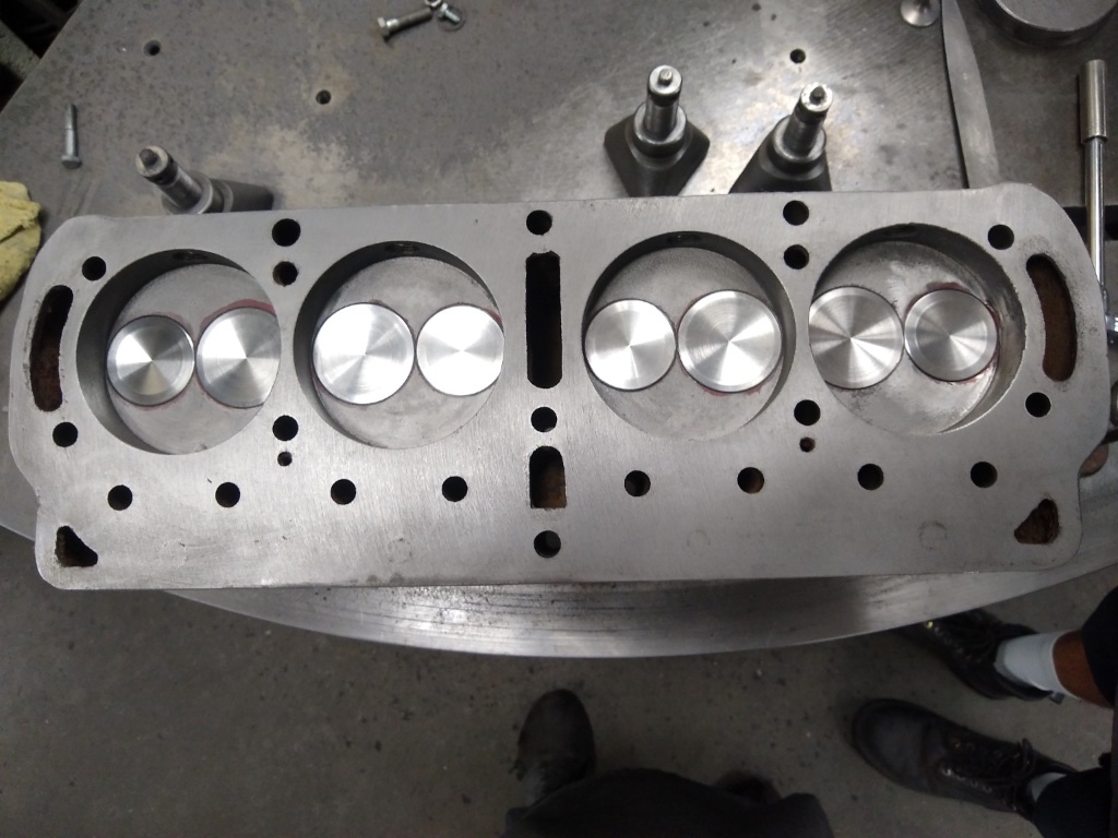

An update on the head. I just got this photo from the shop showing the progress. Half of one valve seat needed to be welded (you can tell which one on the picture from the polishing/grinding marks. They took a little more off the deck than is shown in this picture (a total of 10/1000).
The goal was to do as little to it as possible, consistent with good running. This was done in order to leave options open for future work if needed. We used the John Deere valve springs recommended, but are a little smaller in diameter than the stock ones. They are a useable spring pressure, running between 50 and 52 pounds.
Looking forward to getting it back so I can start fooling around with it.
A better shot with the deck done and the valves in. Can’t wait to get it back.
