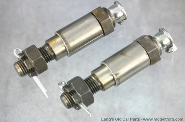

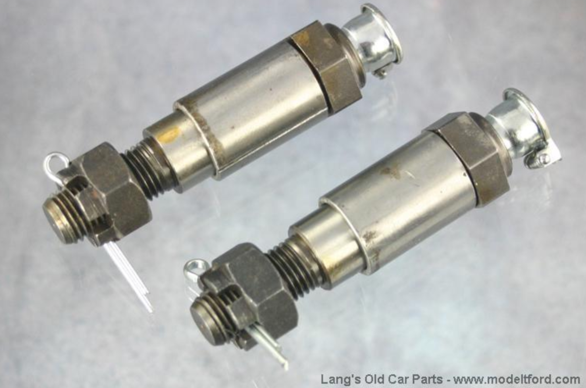

Bob, I think you have found the cause of your wobble. The 2 tie rod bolts have a shoulder that will not allow them to compress any more than they already are. The 1/16" play is due to wear and is quite common since these parts have an oiler but many times didn't get oiled.
Mine were worn but the car didn't wobble because it was wearing the accessory springs to take up the wear. When I took them off to see if they really did anything I immediately got the death wobble.
Replacing the tie rod bolts killed the death wobble.

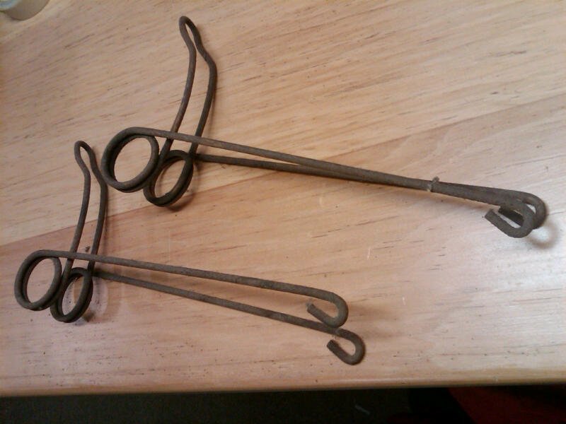

BTW, these are the accessory anti rattler springs that take up the play in the tie rod bolts.

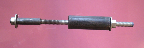

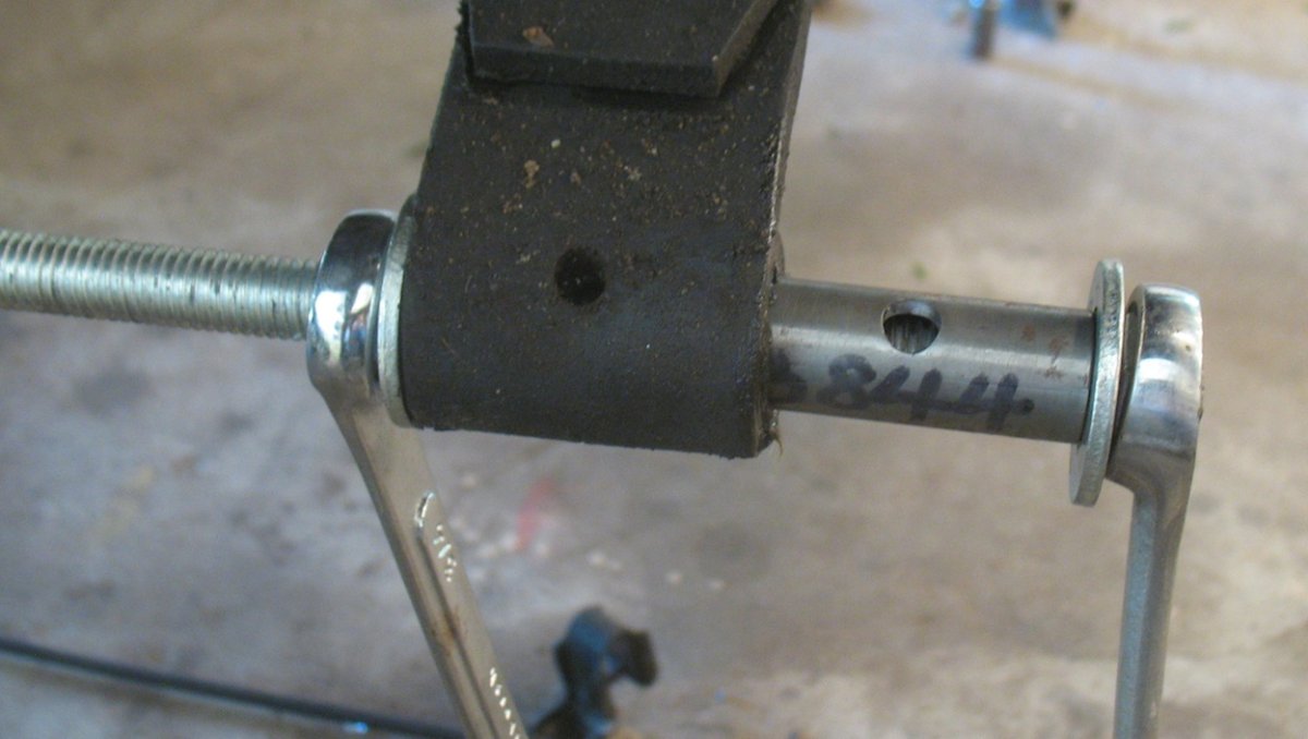

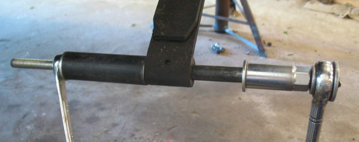

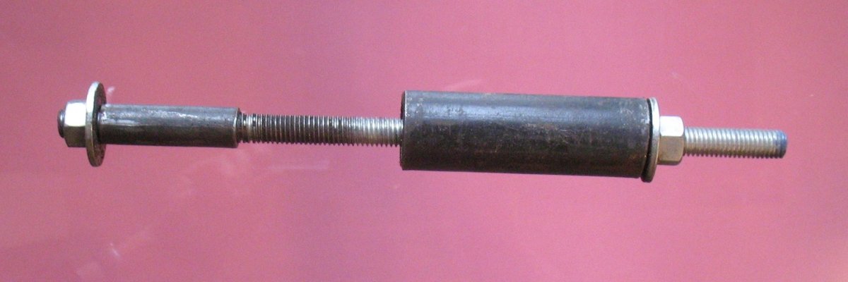

Bob: I used a piece or 3/8" threaded rod, nuts, washers and a 3/8" drive deepwell socket a little larger than the od of the bushing. Use the new bushing to force the old one out to the inside of the socket. Its a fairly common technique, requiring careful alignment of new and old bushing but it's basically a one step procedure. It will take a fair bit of torque to break the old sleeve loose, oil liberally, good luck, jb

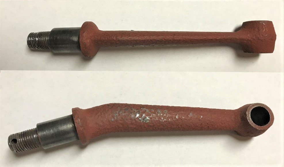

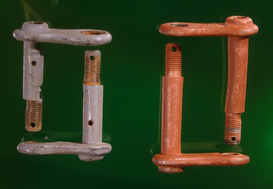

Good thread a lot of info. but my problem is my spindle arm on passengers' side is worn. a new bushing will not tighten in the steering rod. i have not found the spindle arm for sale Snyder's does not refurbish them any longer. ford part number is .t 2696 any thoughts .Tim Hales
- Posts: 5593
Re: More death wobble
Are you needing a straight arm for your '15 ? I might have a decent orphan.
Tim Hales
- Posts: 4
- Joined: Sun Jan 06, 2019 7:43 pm
- Last Name: Hales
- Location: Saginaw,Mi
Hi Steve yes it is the passenger side. it has a hole for a speedometer but i don't have one i do not know if there is a difference r or l just a quick measure it is about 5 .5 inches center to boss . the driver side seams tight .must have gotten more oil in its life ...Tim
- Posts: 6581
I have a good straight one. Will trade for the one you have with a hole (need to see it first). We each pay for shipping to one another via USPS Priority mail. (I secure these items to a flat piece of cardboard to prevent them becoming a torpedo through the end of a box and tape the sides all the way around. I also have one with the speedometer hole but not for tradeTim Hales wrote: ↑Tue Jul 12, 2022 10:42 pmHi Steve yes it is the passenger side. it has a hole for a speedometer but i don't have one i do not know if there is a difference r or l just a quick measure it is about 5 .5 inches center to boss . the driver side seams tight .must have gotten more oil in its life ...Tim

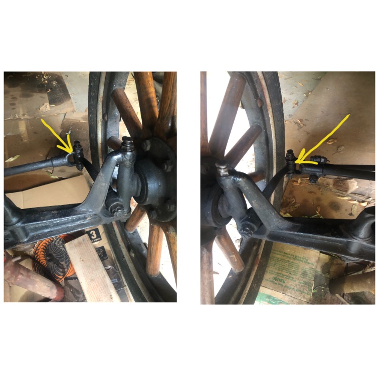

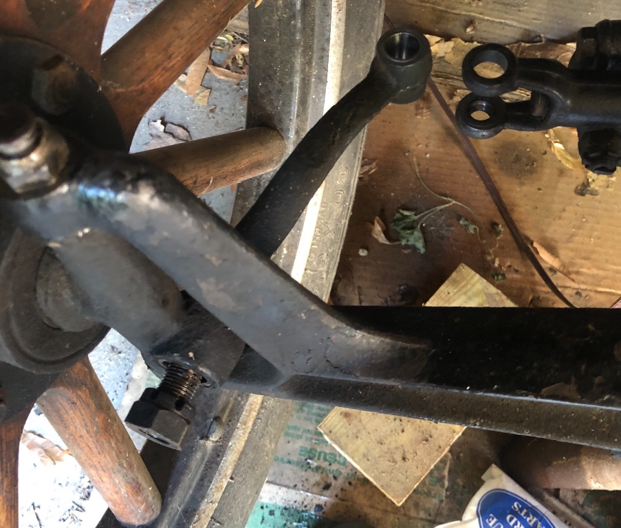

I have received the bushings and new bolts for the tie rod replacement. I tried to push out the bushing without taking off the spindle arm by placing a jack under it so I wouldn’t bend the spindle arm. Bushing didn’t seem to move. I took off the large 7/8” nut on the spindle arm figuring that I would have better control if I put it in a vice. That nut was very tight, needed extension on the wrench to loosen. From what I’ve read that is good. Left the nut sticking out to drive the spindle arm out, whacked it with a piece of wood on the nut, no movement. Put penetrating solution on all components and walked away.
Questions?
How does one get the spindle arm out without messing up the castle nut?
Can you replace the tie rod bushings with the spindle arm attached?
If the spindle arm is taken off to replace the bushings how do you put it back with the proper alignment?
Should the spindle arm move during normal travel?
Wanted to change out these parts before my mentor comes back from his vacation Friday! Don’t want to make the job worse because of ignorance.
Picture of current condition.
Questions?

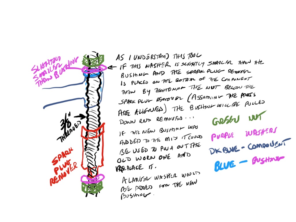

Buy this tool. If you don't want to have it around afterwards, sell it in the Forum classifieds.Bobbbenner wrote: ↑Thu Jul 14, 2022 9:33 amI have received the bushings and new bolts for the tie rod replacement. I tried to push out the bushing without taking off the spindle arm by placing a jack under it so I wouldn’t bend the spindle arm. Bushing didn’t seem to move. I took off the large 7/8” nut on the spindle arm figuring that I would have better control if I put it in a vice. That nut was very tight, needed extension on the wrench to loosen. From what I’ve read that is good. Left the nut sticking out to drive the spindle arm out, whacked it with a piece of wood on the nut, no movement. Put penetrating solution on all components and walked away.
Questions?
https://www.modeltford.com/item/2714DR.aspx
With the arm supported properly, you can use this driver, along the hammer of your choice, to drive out the bushings. BTW, leave the spindle arm in the spindle. They can be a bear to remove and not necessary.

Bob: I had good luck using 3/8" threaded rod, washers and nuts, and a 3/8" drive deep well sparkplug socket as a 'puller' to draw the new bushing in while it forces the old bushing into the cavity of the socket. The cavity of the socket must be large enough for the o.d. of the old bushing to fit inside but small enough so the edge of the socket sits squarely on the arm. Alignment of the new to old bushing is critical, and it helps to relieve the outer 'corner'/circumference of the new bushing where it enters the arm. Bushing to bushing alignment is easier if you use a sleeve with 3/8" i.d. that fits snugly in the bore at the juncture of the new/old bushing. Once the new bushing enters the spindle arm hole the alignment is maintained. Oil liberally once you have things aligned.
Alignment on the exit side is important too so the old bushing has a clear pathway into the socket. This technique has been shown repeatedly for similar situations on the forum, so it is a familiar low tech solution. I would place the new bushing on top of the old in the arm, then insert the 3/8 rod with the alignment sleeve, top washers and nut downward and slide the socket up from underneath, place washers and nut on bottom, align socket, oil and wrench
Do not remove the spindle arms and I prefer not to beat bushings in/out even with the so-called 'drivers'. If you resort to a two step -- (1)remove old then (2) insert new, the threaded rod/bolt, nut and washer 'puller' to insert new one is still superior to beating it with hammer and 'driver'. (And from my experience, you will likely need to ream the new bushings slightly to get yolk bolts to fit arm bushings once they are installed.) Good luck, jb

If you have a press, remove the spindle. Use the bushing driver tool or equivalent in the press.
If no press, this threaded rod with spacers & bushings will do it.
- Posts: 7279
The simplest way to re-align the spindle arm if you do remove it is to leave it loose in the spindle as you refit it,. Then hook up the tie rod and it will dictate the correct alignment. Only then do you tighten the spindle arm nut.
- Posts: 4472
True! Also allows you to inspect the kingpins and wheel bearings.
- Posts: 6581
Steve Jelf DIY bushing tool. Smaller tube OD same as bushing wall OD. Larger tube acts as an anvil large enough for a secure base but its ID needs to allow the bushing to slide into it. Adapt parts to fit your busing needs.
