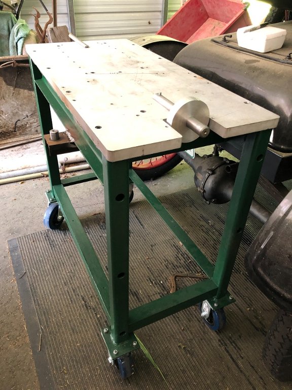

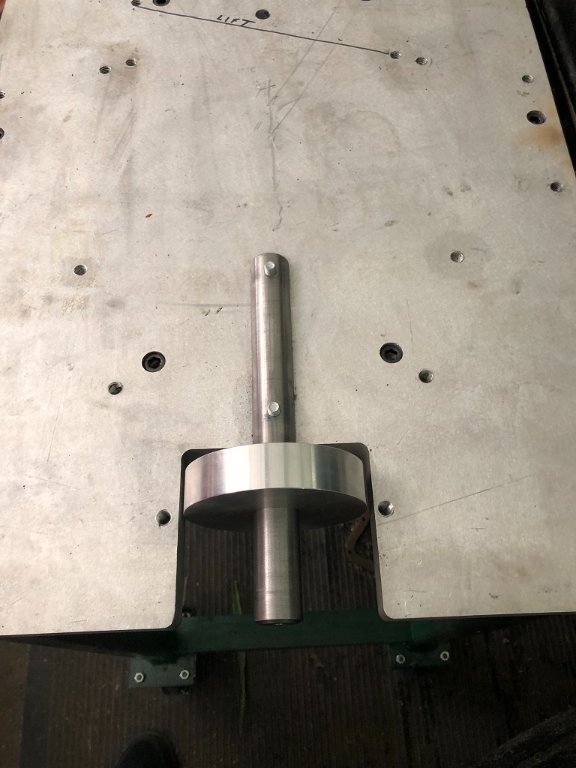

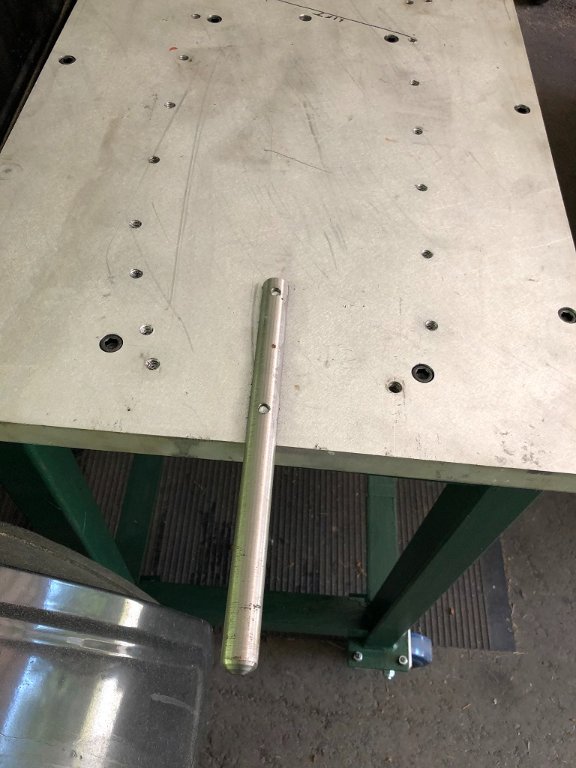

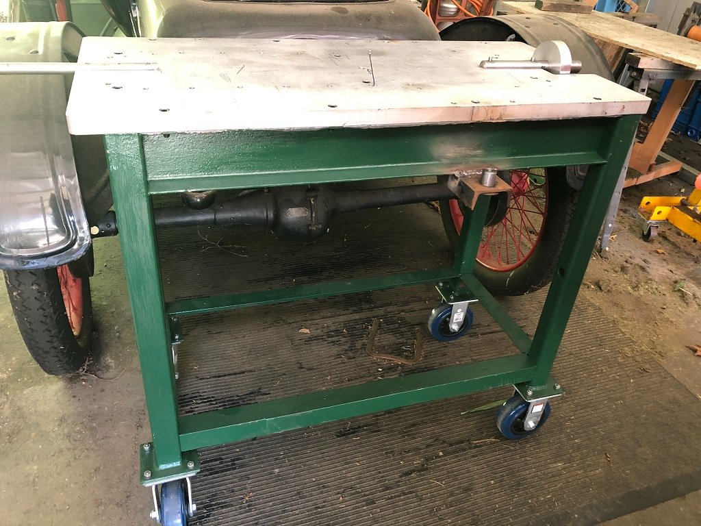

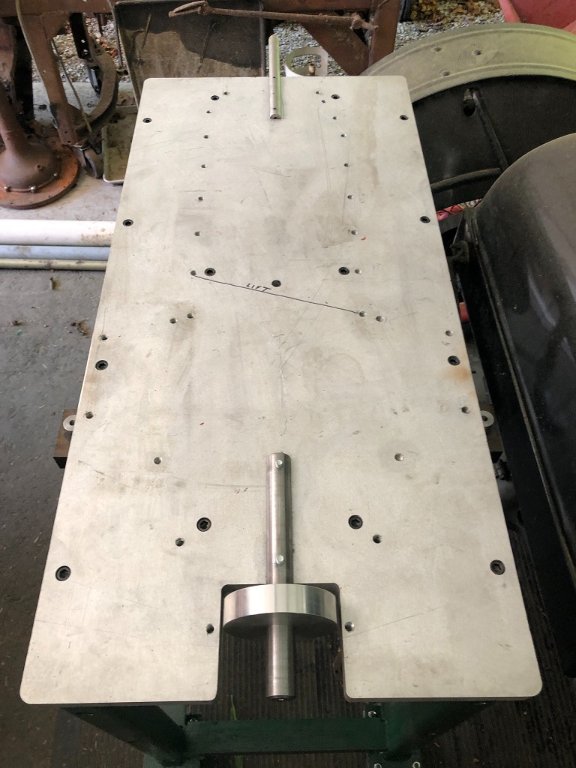

A friend and I decided to make a pan jig out of our collective available resources.
I had a piece if 6061-T6 one inch thick aluminum plate (aircraft grade),
We bought some steel tubing and channel to fill in what we didn't have on hand.
A friend with access to a water jet cut the plate out for us.
Another friend with a CNC mill drilled the hole pattern for us.
The co-conspirator is a machinist and made the machine parts.
Here is the final assembly.
The top plate is set in a leveling epoxy and held down to a full frame and several cross-members.
In a perfect it should have been made it out of steel plate but, I don't live there. :cry:
This will be a useful tool.
Respectfully Submitted,
Be_Zero_Be

What did you use to locate the holes? Ford drawing?

I used the Ford drawing that I previously posted.

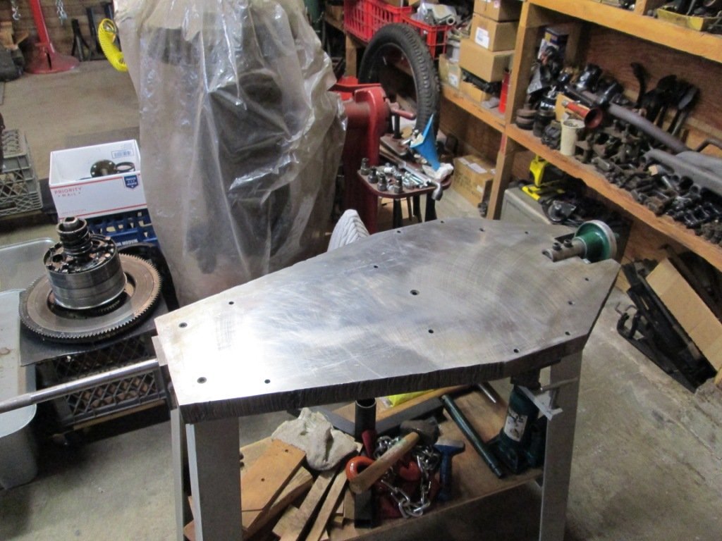

Nice jig there Bob ! Probably a little lighter than my T-1 steel jig. The late Herman Kohnke assisted me many years ago with all the critical dimensions off his original KRW jig. Every crankcase should be checked prior to installation !

I prefer hydraulic pressure for assisting rather than a BFH ! I use a chain & bottle neck jack for most help. I had the "local" T guy (RIP) straighten a crankcase years ago - he used a BFH and broke the snout off the "not my c.c." - we didn't speak for quite some time - that's why I built mine.
