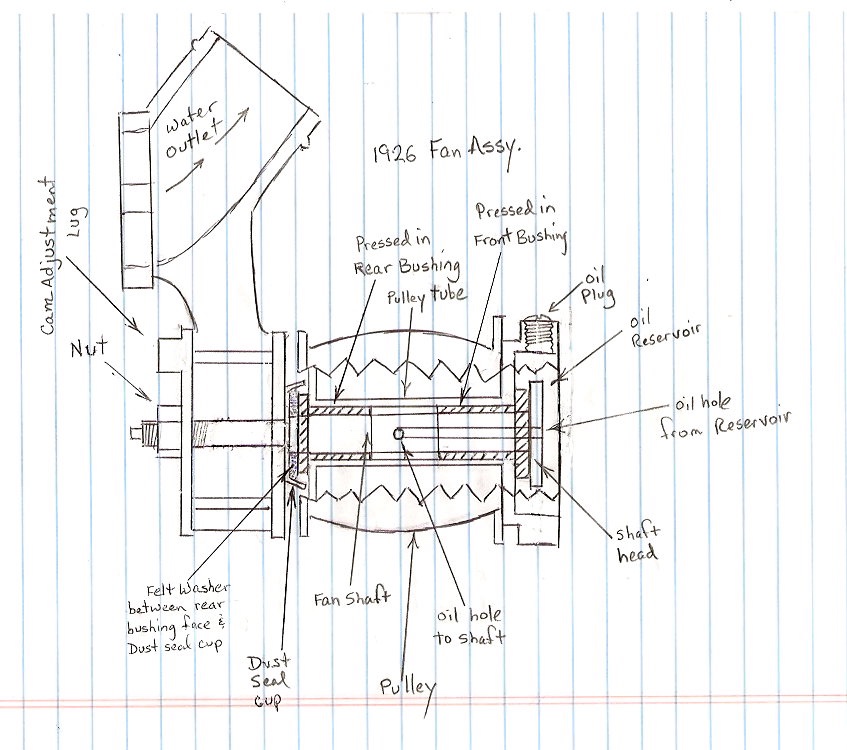

Lisa. As soon as I posted my question as to what year your Model T was, I read in the title of your post that it’s a 1926, so I deleted the part of my post asking the year. Anyway, congratulations on finding your First Model T. I have a 1926 coupe. We look forward to a picture of yours.
The 1926-‘27 Model T has a different fan assembly. Be sure to add motor oil to the fan reservoir (located just aft of the fan), so the fan can turn properly so as to cool the water in the radiator. The shaft from the reservoir to the space between the bushings is hollow so as to deliver oil from the reservoir to the space to lubricate the length of the shaft. Jim Patrick

Steve. Take a look at the engine drawing in my above post and below. Unless the Model T era diagram is wrong, the pipe going from the bottom of the radiator to the engine block is listed as the “outlet pipe”. The inlet pipe goes from the head to the radiator. No big deal but I just wanted to let you know in case it matters to someone else. I suppose It only matters if we are attempting to give advice to someone. Jim Patrick

Very Nice! Here are your pictures righted and cropped. Mine is a ‘26 coupe also. I have had mine for 52 years. Jim Patrick
