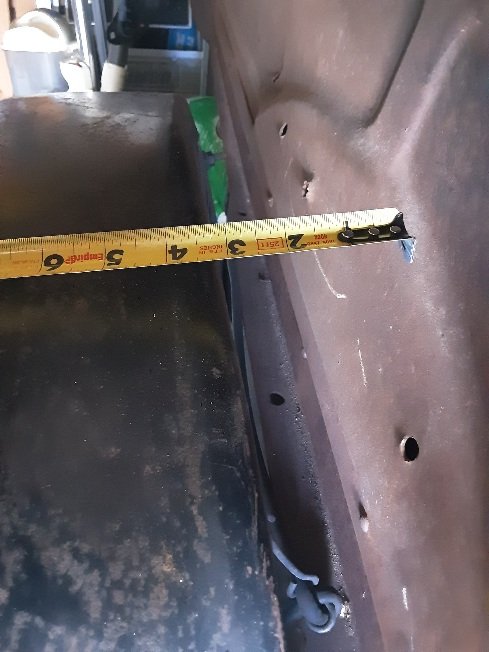

I cannot figure out how to post an image but there is a 3 inch gap between the fender and box. Any suggestions?

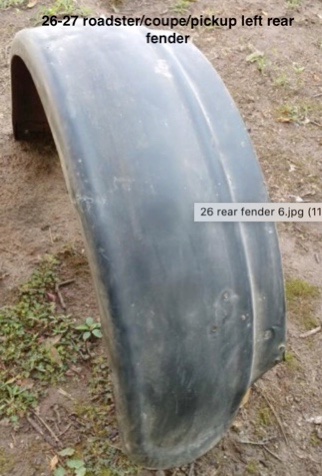

The Ford factory 1926-27 roadster pickup uses 1926-27 roadster and coupe rear fenders bolting directly to the factory bed. One possibly for the large gap is that you have 1926-27 touring or sedan rear fenders. Another possibility is that you have the wrong year pickup bed. A 1925 Ford model T bed or a 1928-30 Ford model A wouldn’t fit correctly, the 25 T bed uses a straight fender iron, and the 28-30 A bed uses a special spacer to mount the fender. A third possibility is that your car is a cut off 1926-27 touring and is using the touring car fenders. A picture would help to pin things down so club members can give you some ideas on how to proceed to fix things as best as you can.

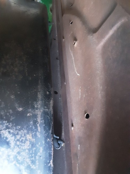

[I will try to add pictures. The body has a solid metal floor. .the fenders have a bracket in the rear portion that attaches to the frame or subframe, I am not sure. Had a knee replaced a few weeks ago and I am not fully flexable yet.

Try picture again.

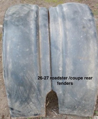

From your ultra close up pictures it is hard to tell for sure about your fenders and bed. The pickup bed looks to be a correct 1926-27 Ford roadster pickup bed. The fender looks to be a fender for a 1926-27 Ford T touring . You will need to find a pair of the 1926-27 Ford roadster / coupe fenders, they will be wider and stepped down and attach to the bed. These fenders are sought after and harder to find than the touring fender.

That fender looks like 17-25 Roadster Touring. Can’t tell for sure, need better pictures.

Believe your fender is a rear 26-27 touring/sedan fender, not made to fit to your pickup. The bed you have is 26-27, just need to find a pair of correct rear fenders, 26-27 roadster/coupe/pickup.
