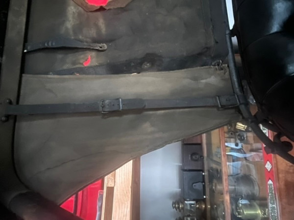

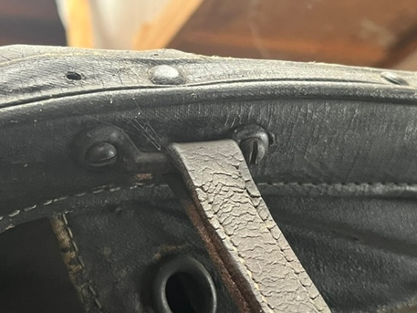

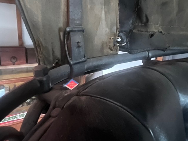

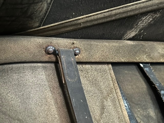

Re: Top installation on a 1910 touring
Those pictures really help, Kim: thanks! But my rear straps have a black ring on the one end, so I’m guessing it attaches to the buggy rail supports on the back of the rail and doesn’t loop on itself like yours.
Russ T Fender
- Posts: 471
- First Name: Val
- Last Name: Soupios
- Location: Jupiter Florida
For what it's worth my '10 has adjustable straps like Kim shows. My '14 has the rings.
Aussie16
- Posts: 280
- Joined: Sat Jan 05, 2019 9:24 pm
- First Name: Warwick
- Last Name: Landy
- * REQUIRED* Type and Year of Model Ts owned: 1916 RHD Canadian Touring 1916 Pickup 1926 Fordor 1925 Dalgety Tourer 1916 Speedster
- Location: Trarlagon Victoria Australia
Wonderful that Kim was able to share those original photos of 1910 top installation. If you want an authentic/correct installation you should try to copy the installation of those straps both front and rear. The front panel which fixes to the underside of the front bow is also quite unique to the 1909/10 Models. Some of this detail that is unique to the early tops may have been overlooked in the supply of your your new top?

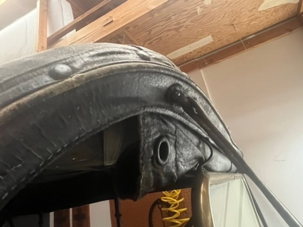

So I’m curious: what is rolled up under the front bow? Is it a flap to cover the gap between the windshield and top?
KimDobbins
- Posts: 1683
- First Name: Kim
- Last Name: Dobbins
A roll down windshield in case you didn't get a metal/ glass windshield with your car.
