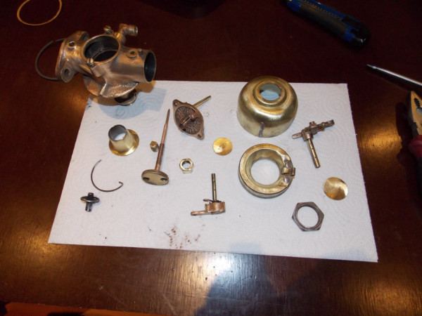

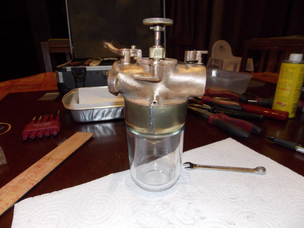

Re: Holley Model S Carb
Hey Jay,
A few years ago I had the same problem.
Here is what I did.
The float that was in it before was a Holley NH float and it worked well with a little change on it at the hinge.
I think the gaskets were available.
Goodluck
Andre
Belgium
Here is what I did.
Goodluck
Andre
Belgium

Andre. Earlier I explored using an NH float. It seemed to me that it would be compatible with a little tweaking on the lever. Thanks for confirming that it will work.
This would be easier than making a new one. I was also advised in a different forum that a John Deere float AR10067 would also be very compatible. Looks like your bowl had cracks. Mine has cracks too. I'll solder from the interior if I can't find/buy a good one.
