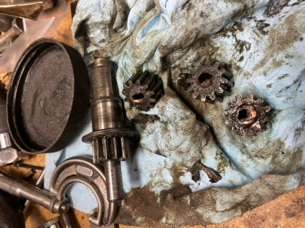

I got the shaft out, inspected everything, and found that triple gears were really loose on the pins. When I took them off, I found that they had been badly bushed using what looks like copper pipe(!?). This is odd since they don’t normally have bushings. The bushings fell out in pieces when I took the gears off. The shaft is good, other than some bumps caused by dents that were keeping the bushings from sliding on. I filed those off and polished the shaft bearing surface on the lathe and it’s good to go. The cover is good and the hole is not oversized. I ordered new pins, and a 4-1 gear set which should be a big improvement over what I had. Nice to have a $60 fix to the problem.

Sounds like Morgan is on to the root cause of the sloppiness in his steering and on the way to solving this particular problem. As for the myriad of others throwing away steering shaft parts (in the past and into the future), scrapping out a worn 4:1 shaft is a choice and not a necessity, as they most certainly can be brought back to new condition

Personally, I would be very concerned with your steering system after finding the bushed gears. A big red flag would have me inspecting everything else mechanical in the car along with the steering itself. I can't imagine how only the three hardened gears could wear enough to need "home-made" bushings while the rest of the mechanism shows no wear. There is a difference between worn and worn out, and even though you're in Alaska, I'd still be looking for a decent used 5:1 gear set as all '25-'27 T's used this ratio and it sure gives a better road feel and more driver control over the old 4:1 setup.
Thats an amen.
I have seen worn gears, but usually a new set of pins(which are over-sized compared to original.) get the old gears back to usable, as the pins seem to wear the most.
Be lookin for a late steering column reasonable & switch out the guts if you feel a 5-1 ratio would be an advantage.

You didnt mention the 5-1 steering shaft. ALL components must be changed. The main steering shaft 3 pin locations are different also.
Look @ the service manual warning.
[/quote]
What would be the major difference in steering columns? I have 2 to experiment with along with 2 slotted gear cases. Is there a measurable component i.e. the top 3 pin mounting plate where components/dimensions that can be measured/verified? I didn’t see anywhere in the service manual that stated a new shaft was necessary….but I could have misinterpreted it…
[/quote]
[/quote]
Gear case teeth are the same. At some point there is a slot for 1 longer pin to ride in to prevent over steer. That change was 21? The matching 3 pin mounting plate is a critical component.
The pin circle dimensions are different between the 4 & 5-1 shafts. Note the gears are different diameters, so the pins they ride on are spaced differently. Again note the warning for mixing components in the service manual.
Dry fit all the parts outside the gear case & there will be an obvious correct or incorrect gear mesh.

Wait….the pins are where the pins are gonna be on the end of the steering shaft, they’re not spaced differently on the steering shafts? You just have to make sure you use the pins, gears and pinion that come as a set together….AND they’ll go/supposed to go in any slotted gear case with 36 teeth in the circumference as long as the pinion goes into the steering shaft…..🤔

The 3 pins ARE spaced different between the 4-1 or the 5-1 gear shaft.
You cant successfully or safely mix any of the geared components.
