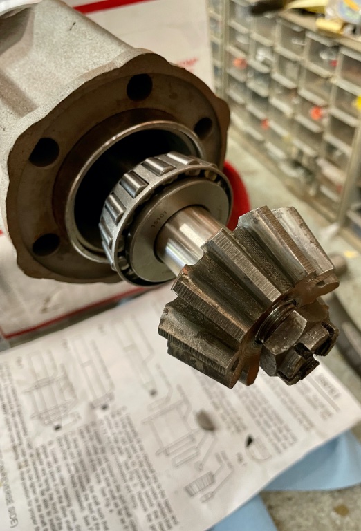

I’m open to some tips about installing a new sleeve onto a driveshaft. So far, it kinda sucks. I got the old one off by heating it with a torch and beating it free with a brass shaft. I put the new one in a toaster oven set at 450 for about 20 minutes and proceeded to try to install it, with the key way properly aligned. It pounded on about an inch on and then stopped hard. I stopped there and called it a day. I plan on heating it lightly tomorrow and pounding on it. Any tips?

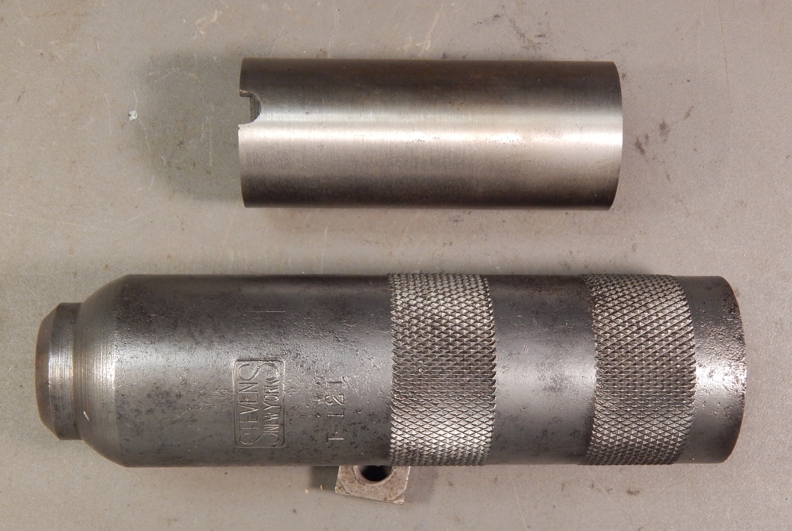

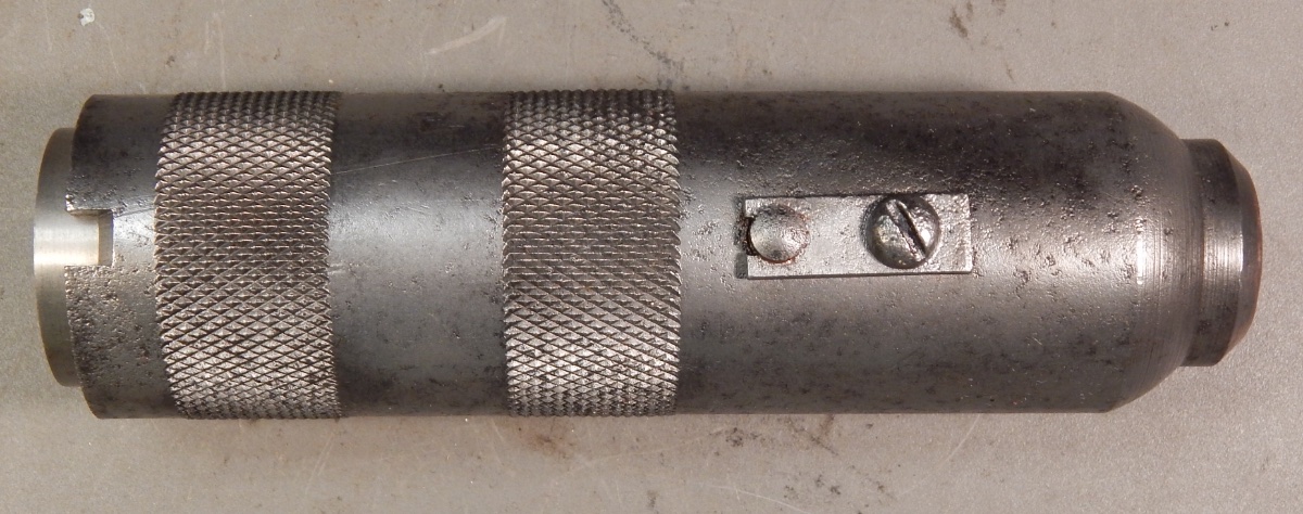

Stevens made a sleeve driver for the driveshaft roller bearing sleeve. It slipped over the sleeve and the sleeve was used to guide the sleeve as it was driven on.
Here are some pictures of an original Stevens driveshaft sleeve driver.

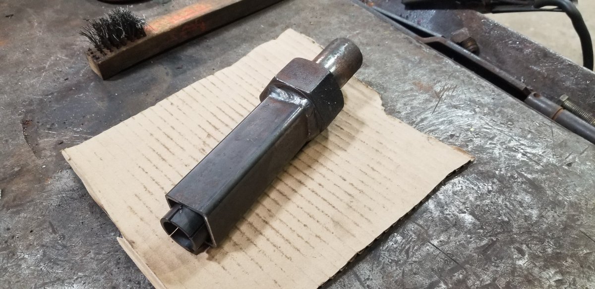

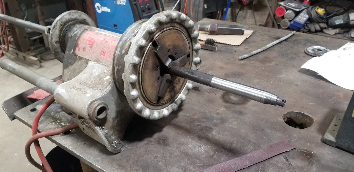

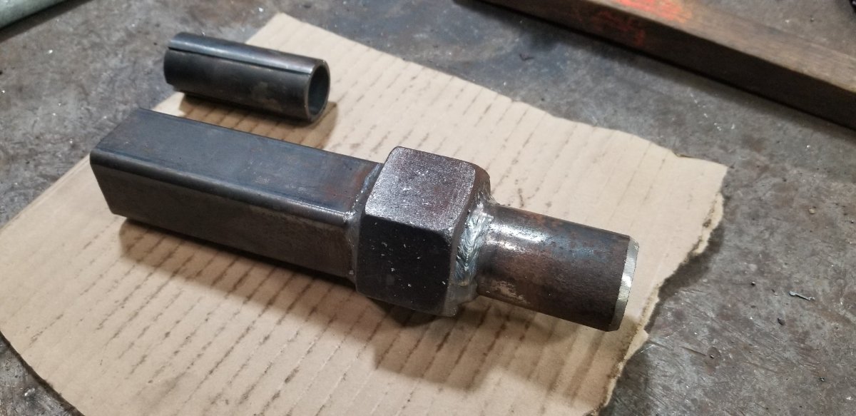

Just whipped up this sleeve installation tool to help me put the new one onto the shaft when it arrives. It has an old sleeve welded to the inside of the guide tube. The inner leading edge of the old one is relieved. The new sleeve sits in the tool with a half inch exposed in order to watch the guide lines. Also, here's a picture of my "lathe" to dress the shaft surface with.
